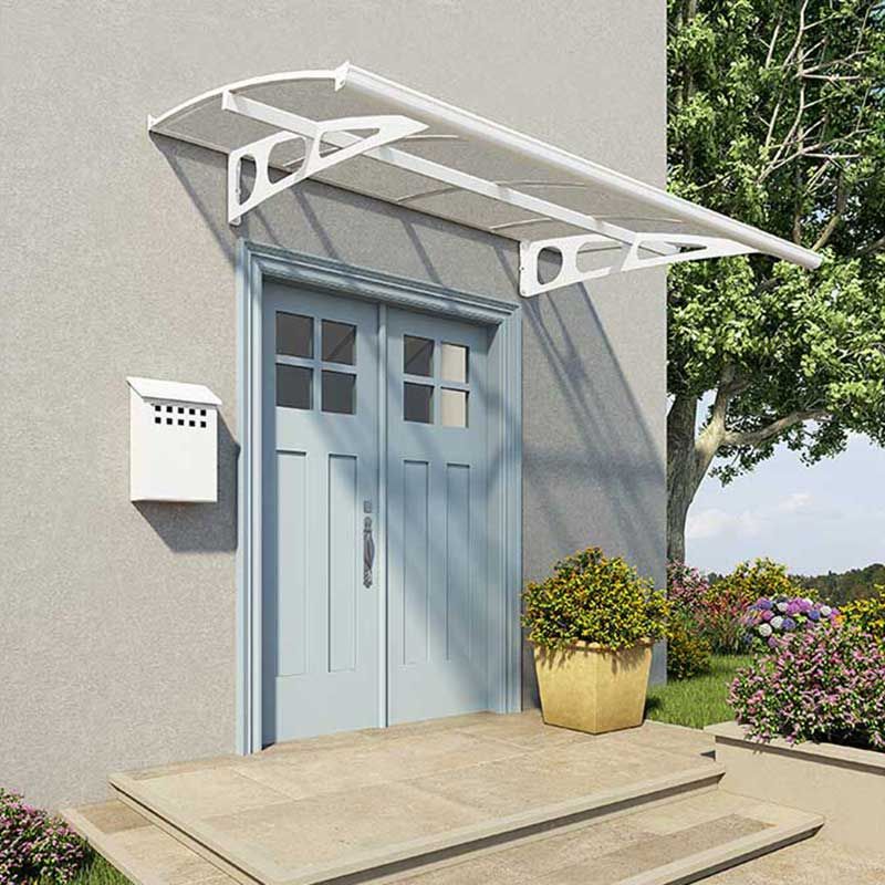

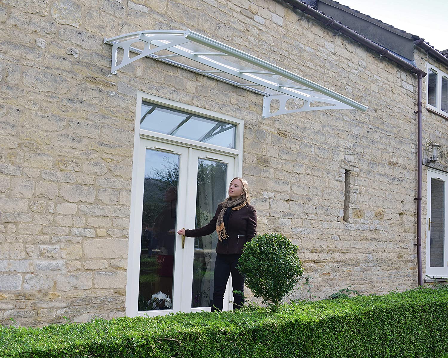

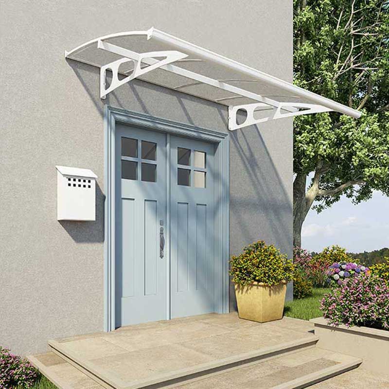

I have a set of French double doors that open up at the rear of my property which are currently exposed to weather. I plan to install a modern door canopy as per the enclosed photo examples.
I am considering purchasing the canopy from a manufacturer called Palram who widely distribute the Bordeaux 2230 door canopy to many resellers in the UK.
Does anyone have experience working with Palram products, are they any good? Are there any other manufacturers that I should consider?
Much appreciated.

You must have a different brand or model. The above model uses solid steel in powder coat. It's incredibly strong and I could hang off my brackets with my full body weight
It is rarely the quality of the canopy, rather the quality of the fitting/fixing, that lets them down. Too few fixing in a concentrated area = shoite.
Anyone asked me to fix one of those canopies onto a rendered building, I'd tell them to kiss my rear.
