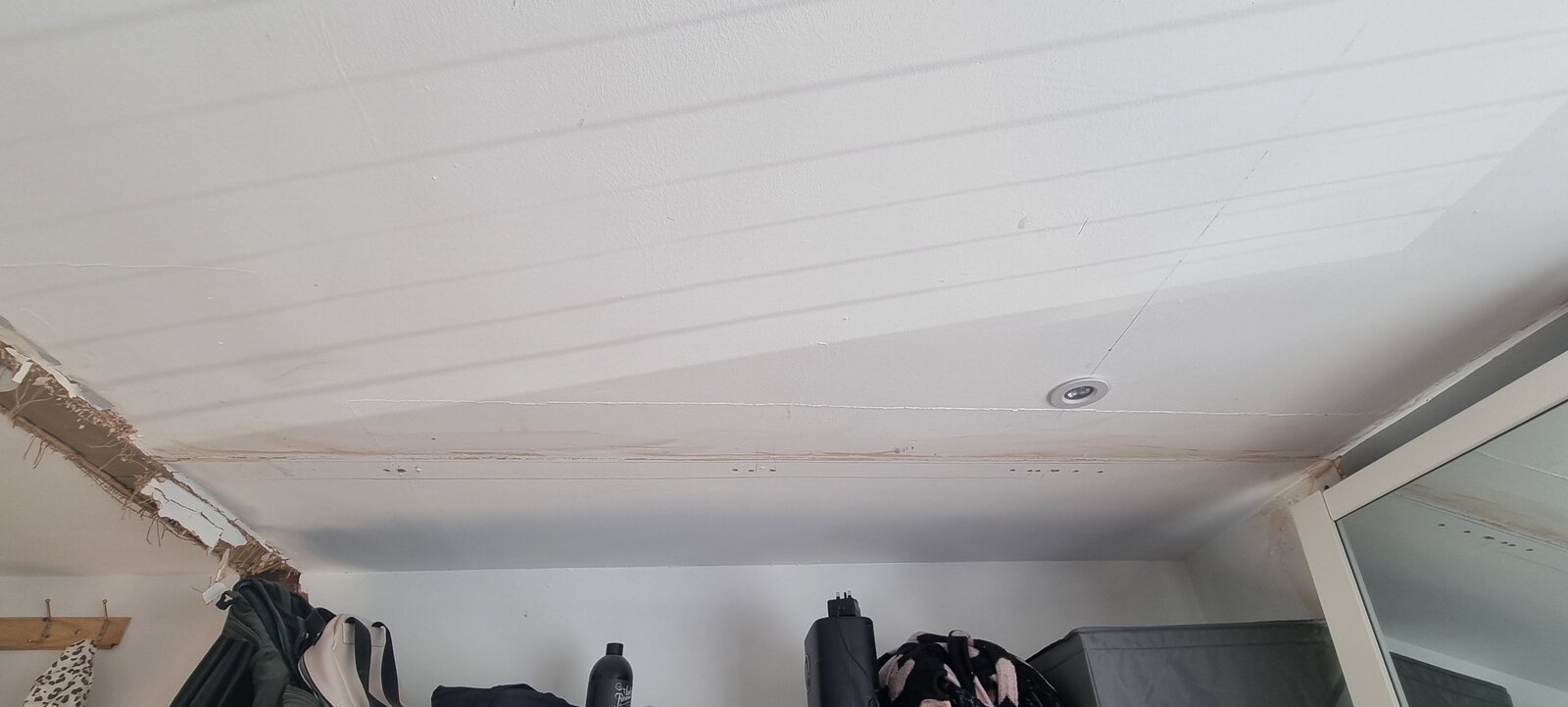

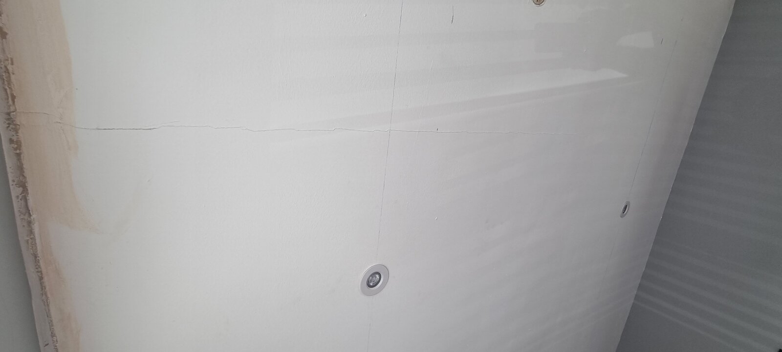

Afternoon could anyone tell me best solution to repair bedroom ceiling. Ceiling cracked in numerous places around original boards. Full width of ceiling in a couple of places. Pics attached.
Dont want this reappearing down the line so would best practice be to be overboard with say 9mm? Or just tape and skim?
Thanks in advance

Personally I'd overboard. Do you have access above to make sure there's no further problems? Skimming will just cause the same problem and will probs be worse due to the extra load.
Ye ive been in loft check if there is any load on the boards. Only thing in there is the insulation.
If you cant knock it down, overboard it but try and stagger the boards so that they don't correspond with the current cracks
Bubbley paint lifted over crack? Sign of 1950 to 70s distemper under emulsion which is degrading over time lifting emulsion along crack.
Pull down or overboard
Ye not so much bubbling but lip eitherside of the cracks.
Thanks for the replies just wanted confirm overboarding was best way to go.
Would 9mm board be ok? Or go for 12mm? Thanks again
Add even more weight to a ceiling that's already bowed under its own weight plus that above, and cracked?
Any thoughts how best to fix boards up where meet wall as no joist? Closest a couple of iinch or more away. thanks
That distance will be fine to screw to and have the board support itself but if you're bothered you can get an expanding foam adhesive designed for bonding PB; run a bead down the board edge and also screw into the joist further away

The additional weight will be irrelevant. It will however stiffen the ceiling, especially if the boards are fitted properly (staggered). I'd look at a ceiling binder above or some such, for any sag.

I'm saying that an additional layer of 12.5mm will benefit the ceiling and seek to stiffen it (think sheathing etc).
