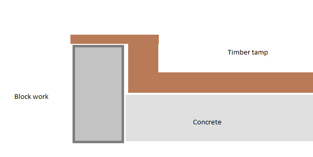

I've got to pour my extension oversite concrete at the weekend and am not sure how to level it as the finished height of the concrete will be within(lower) than the new brick / blockwork perimeter wall.
I have ufh going in so the 100mm celotex will be on top of the concrete,then 65mm screed
My brickie has built up 2 courses of block ( up to damp )for the inside skin of the cavity wall.
I know it doesn't have to be spot on level but will need a good tamp against something and some sort of guide as to the correct depth. Obviously I can't put level pegs in!

It does not need to be too level however the flatter you get it the better.
You can make L shaped timber to hold your tamper batten or just use the brick course as a guide.
Support the scaffold boards on bricks between the mesh don't rest it on the mesh unless it's well supported as it might kick up.
You can add pegs in and put your DPM over the concrete.

The problem with the tamping is that due to the dpm I won't be able to see a brick course I'm not sure I understand the L shape tamping beam, would the short part of the L be cut so it is level with the top of the clockwork when the concrete is at the correct depth? How would this work where the slab abuts the existing house wall ?

Insulated up stand goes in your screed in this instance.
You can fix a batten to your house at the correct level.
