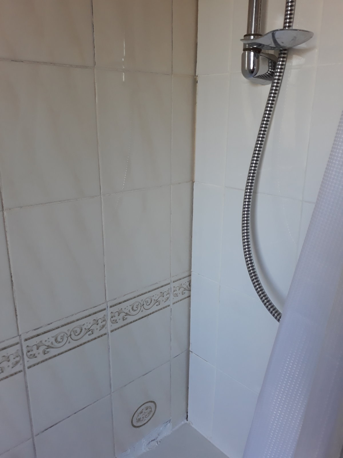

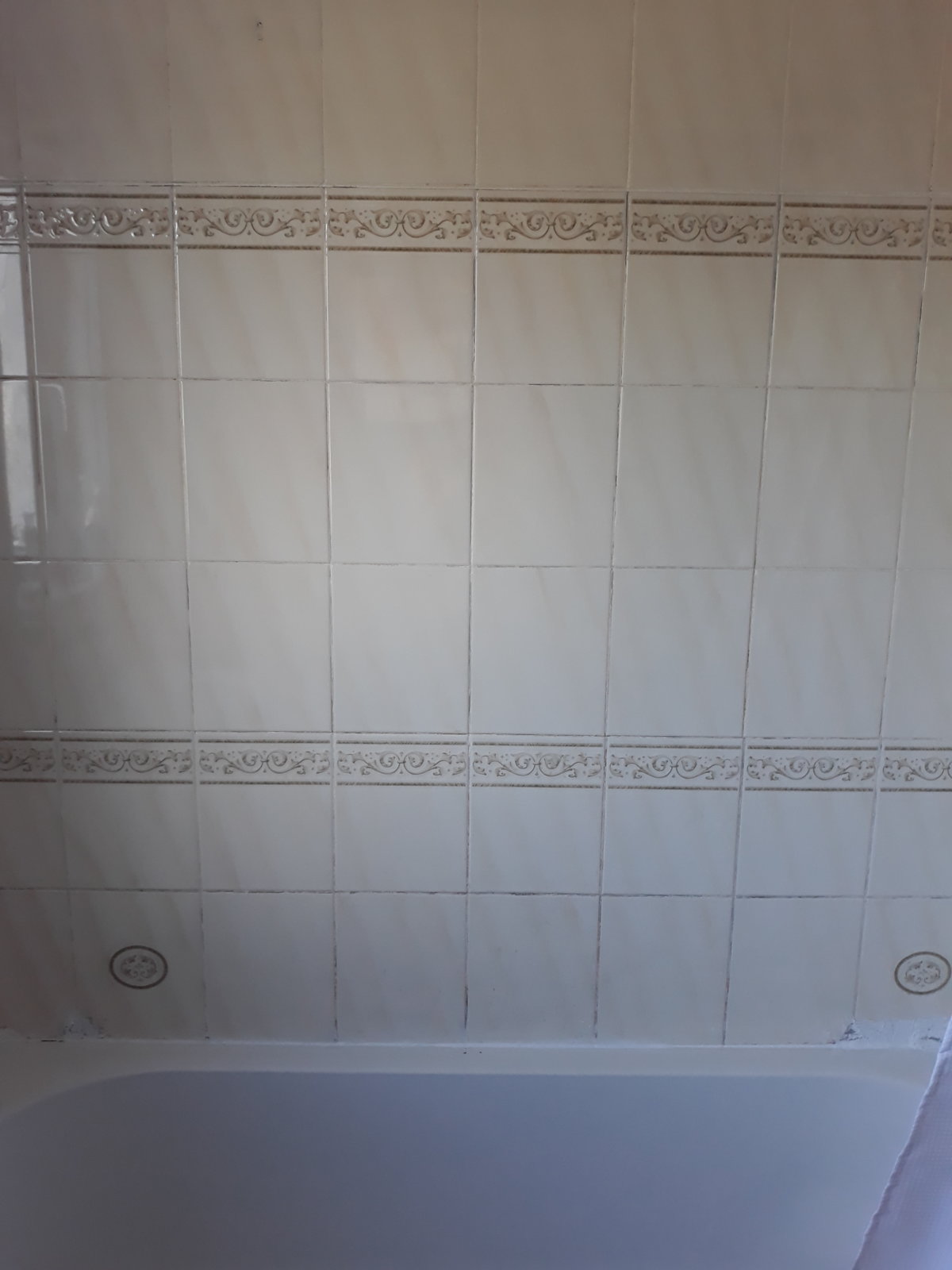

20200508_114055.jpg these patterned tiles are the original to the house (1998 approx) as i say these are solid to the wall and reasonably flat. Better still does anyone recognise these tiles so i could just repair the damaged parts?
20200508_114106.jpg this is the shower wall you can see the new tiles, they are all loose and the only holding them together is the grout.

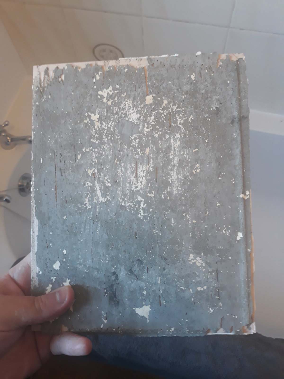

20200508_123815.jpg this is what the majority of the newer tiles looked like at the back.
if you intend leaving or reusing the old suite I don’t see much point in ripping the originals off if they’re sound.
like you said , if you use the correct adhesive theres no reason you can’t tile over them .

if the budget is tight and the originals are sound your better off tiling over.
taking the originals off could open up a can of worms . if they’re tiled directly on plasterboard it will most likely end up in you having to reboard.
If the old tiles are tiled over plasterboard and you double up on them then there's every chance that the extra weight might pull the p/board away from its fixings.
Very bad advice to double tile on p/b.
Not saying its likely but If there is a "can of worms" hidden behind the p/b then you dont leave it there perhaps causing further, more serious damage - you eliminate the "can of worms".

The tile back adhesive failed because it was not mixed correctly or properly combed on with an appropriate 6mm x 6mm notched trowel.
Plus, The skim of adhesive looked more like pre-mixed rather than bagged powder.
Moisture resistant backerboard is the modern preference.
OP, do what professionals do, & rip out back to studs and/or masonry & start from scratch.
