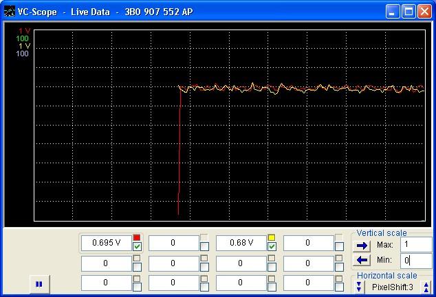

I have been getting the MIL coming on recently. Especially after a long run. Initially it was just the P0420 code, now I am getting both. I ran through the proceudre in the repair manual to produce the readiness code. The catalyst test failed. The manual said that if no fault codes were stored after this failure then replace the cats. The 0430/0420 codes had re appeared so maybe it means any other codes.
I tried connecting an oscilloscope to the lambda sensors using an insulation piercing probe but couldn't get a decent signal. I earthed to the chassis. Perhaps I needed to earth to the gray wire on the sensor?

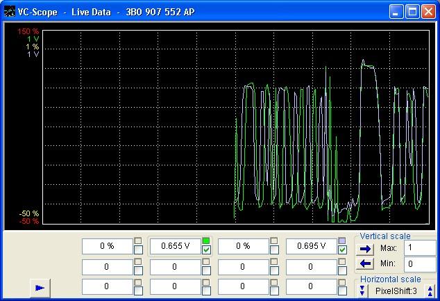

I used and OBD-II scope to record the voltages from both the upstream and downstream sensors. The pictures are below:
Upstream Cat:
Downstream Cat:
The front is switching ok and the rear is steady at about 0.6 V. This was at idle.
It looks to me like both cats are faulty? Can anyone confirm or deny this? The cats from Audi are about £900 each. I've heard that aftermarket cats are no good as they tend to trigger these codes as well because they don't perform as well as the OE ones.

don't just assume that the cats are U/S, the codes are only a guide. it could just as well be airflow meter (should be change after about 60,000 miles due to unstable readings), coolant temp sender etc. The first scale looks very busy even though the voltage is increasing/decreasing it should be a lot slower and smoother but this may be caused by another faulty part. The second scale looks about right with the voltage reading quite steady. you need to do a bit more investigation first as spending £1800 just to find it runs the same is a bit of a gamble.To me the cat seems to be doing its job so look else where.

They are heated to speed up them working but yes I did wait till they are hot. The tests I did with the scanner don't activate until the exhaust has temp is at least 350.
Try the following for "ideal traces" from the scope
http://www.picoauto.com/tutorials/emissions-components-actuators.html
Switch sensors around and see if the trace stays the same? We had a Polo with the same it was a dodgy Lambda sensor.
