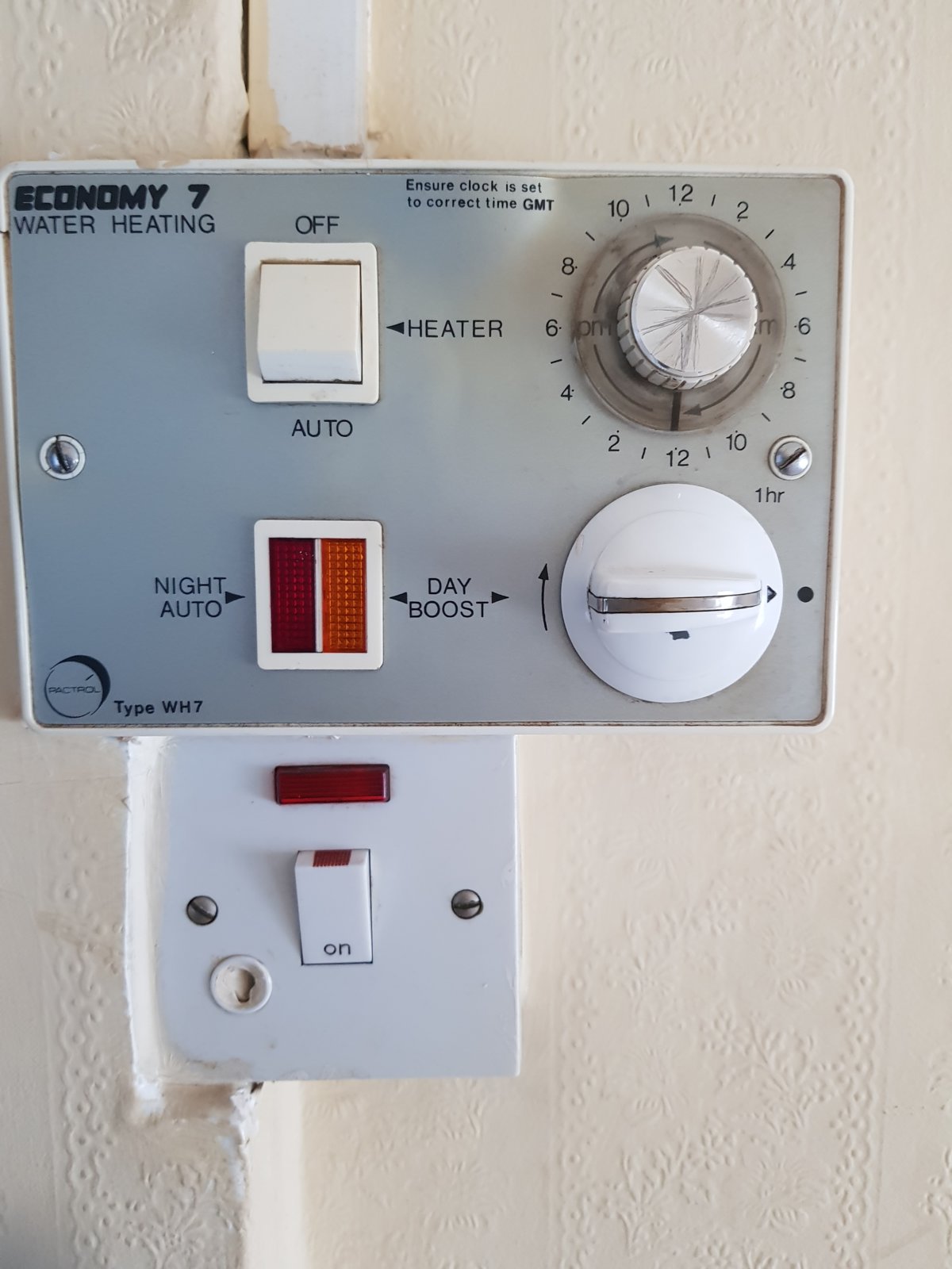

Hi
I've recently moved into a new house and It has no central heating.
To heat the water we have to use this unit. There is no manual available.
I know how to use the boost to get hot water...after 1 hours wait.
Does anyone know how to use this unit or would be able to point me in the right direction.
Your help is greatly appreciated.
Please the pic of the unit...its quite ancient.
Set the white switch to Auto, and rotate the top right dial to the correct time, it should then switch on overnight to heat the water with cheaper rate electricity.
Thanks for your reply.
By any chance do you know how to set the night boost? Having played around with it, it appears that the day boost comes on at 5am until 9am.
Thanks again
