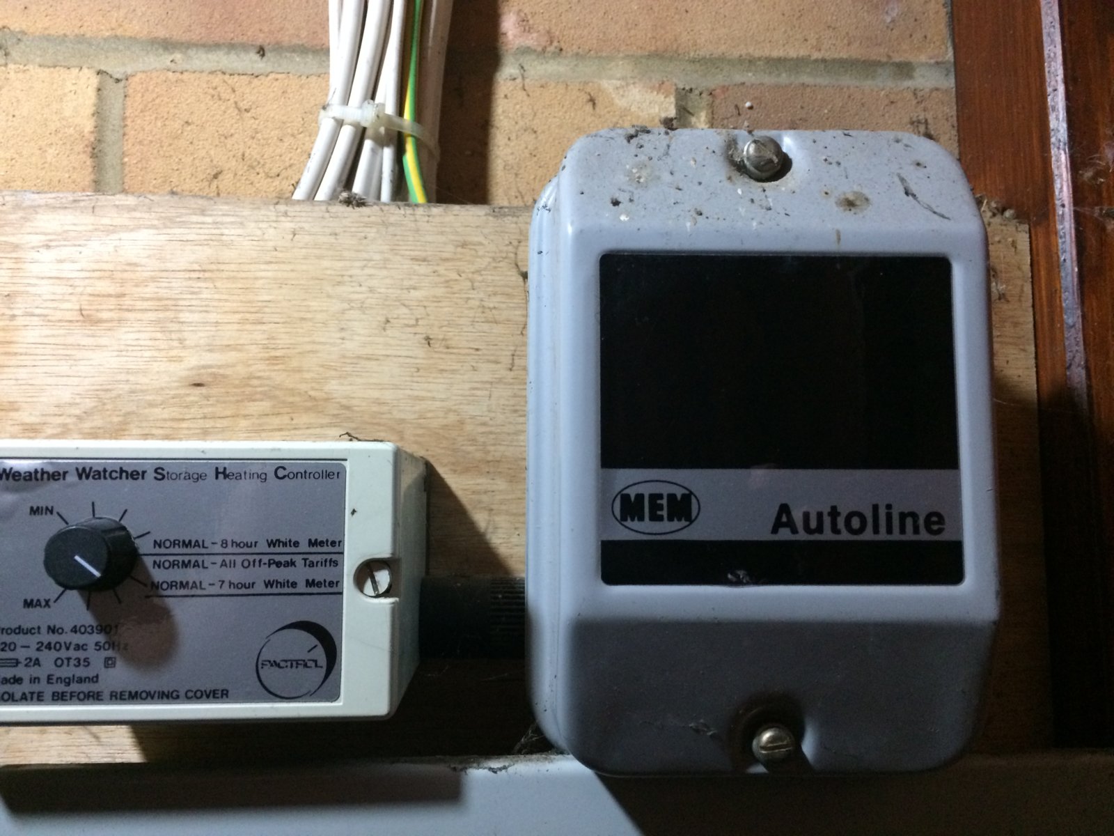

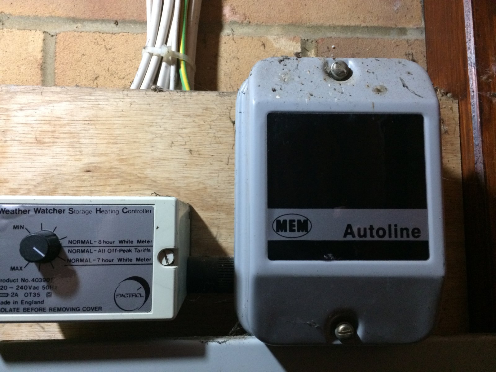

I have recently moved into a retirement flat which has underfloor electric heating installed throughout. Having downsized from a gas centrally home, this new abode is all electric with economy 7 and it’s taking time to get used to!

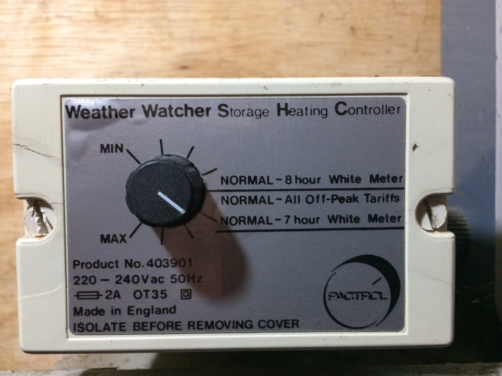

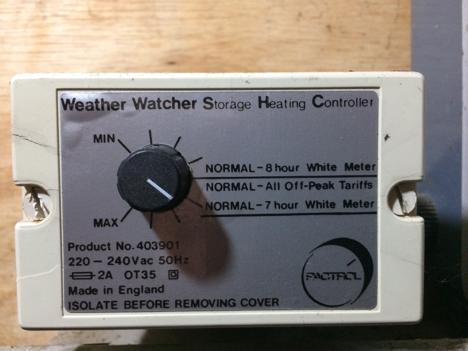

In my meter cupboard is a Pactrol Weather Watcher and Sensor wired into one side of a dual (switched Economy 7) tariff consumer meter – see attached images.
In the flat is a manual room heating thermostat
There are no instructions to operate the underfloor central heating other than the installation/commissioning downloads available from Pactrol which don’t assist to fine tune the central heating.
This technology has been around for a while, this central heating installation in my flat was done as new build in the mid 90’s .
Can anyone shed light how to operate this system economically and efficiently please.

I think yours is a much simpler system
it measures outside temperature and assumes you will get the same the next day, so adjusts how much heat is stored according to how cold it was outside when storing the energy. Rather hit and miss, but better than nothing.

That will not work.
Electric UFH takes a long time to heat up (hours typically), and the entire point of it is that you heat the building all day, every day.
It simply isn't suitable for heating a few hours here and there. Neither are storage heaters.
Also install electric smart rads similar to Haverland.
Grossly overpriced efforts which are neither smart or economical.
There are two choices:
Use the UFH as intended, powered on cheaper electricity overnight and heat the place all the time.
Or switch it off and buy some other electric heaters, switching them on when heat is required.
There are two main types of electric heaters, convectors having instant heat output, which stops the moment it is turned off.
Oil filled and similar take a moderate length of time to heat up, and the same time to cool after switching off. This includes the 'smart' radiators from various manufacturers.
UFH and storage heaters take that concept to extremes, by taking all night to heat up, but also taking all day to release the stored heat.
For any given heat output, the energy used and the cost of operation is the same.
There are manufacturers of heaters which will claim otherwise, usually by virtue of their devices being made with aluminium from Italy, special ceramic and clay cores, thermo gels and having devices which only switch on for 15 minutes every hour - it's all lies.
