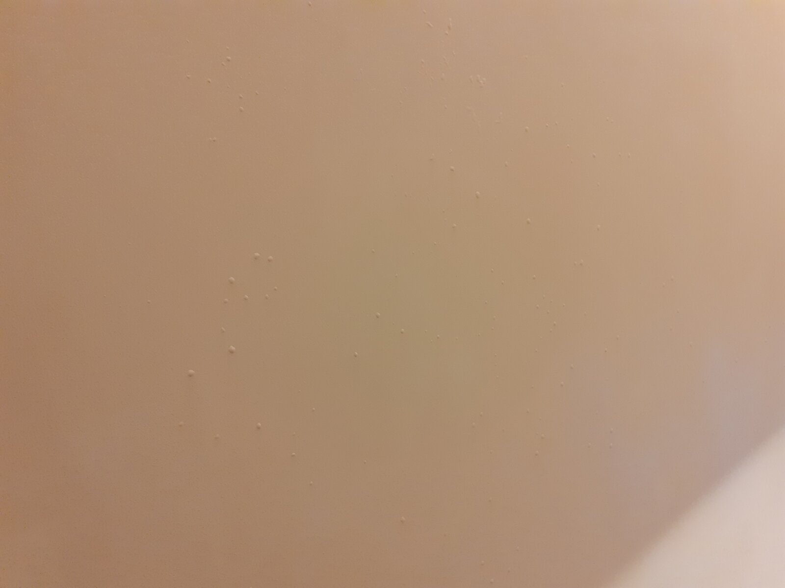

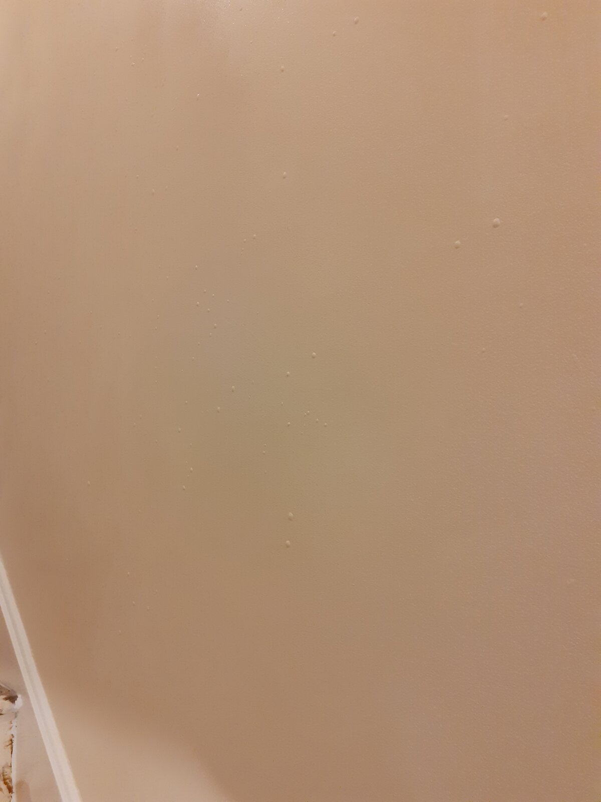

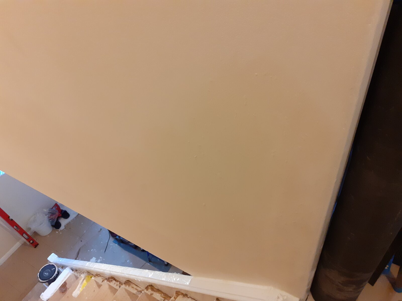

Painting my hallway, stairs and landing in the same matt magnolia; all has gone well except for the two opposing stairs walls; about 1-5 mins after running over with the roller (or cutting in brush), usually when you've stopped paying attention to it, the bubbles are forming and regardless of the thickness of the coat. I have now twice gone through the process of scraping out the air bubble, skimming it smooth again - followed by sanding and cleaning with sugar soap - then applying an initial touch coat before rolling proper again.
Saturday was the third rolling attempt and I'm now at a loss. I've painted every other room in the house with the same technique and tooling, and this is the last part outstanding before finally getting carpet here!
The basecoat was Polycell 3 in 1 until I ran out of it (and at £50 now, I'm not getting any more), at which point I finished off the rest with basic Dulux white (done at different times). This was applied on top of the previous owners maybe-custom lilac mix, which appears to also be matt. The first magnolia coat went perfectly, it was only the second one where this started. The bubbles, if forcefully removed, always go back to the prior lilac, taking everything freshly applied with them.
I've now used different paint, different tray, waiting 3+ weeks and a brand new roller without being able to get this good - which is needed before doing the long stretches in the stairway itself.
I suspect these problematic areas could be where I only applied standard white emulsion, and not the polycell - but struggling to remember how much I covered! Some other rooms didn't have this applied and they turned out fine. Any other potential explanations or remediations, to save me pulling out what hair I have left and wasting all the paint I bought?
It's all dry-lined with no indications of damp in the house, one side being the party wall.
