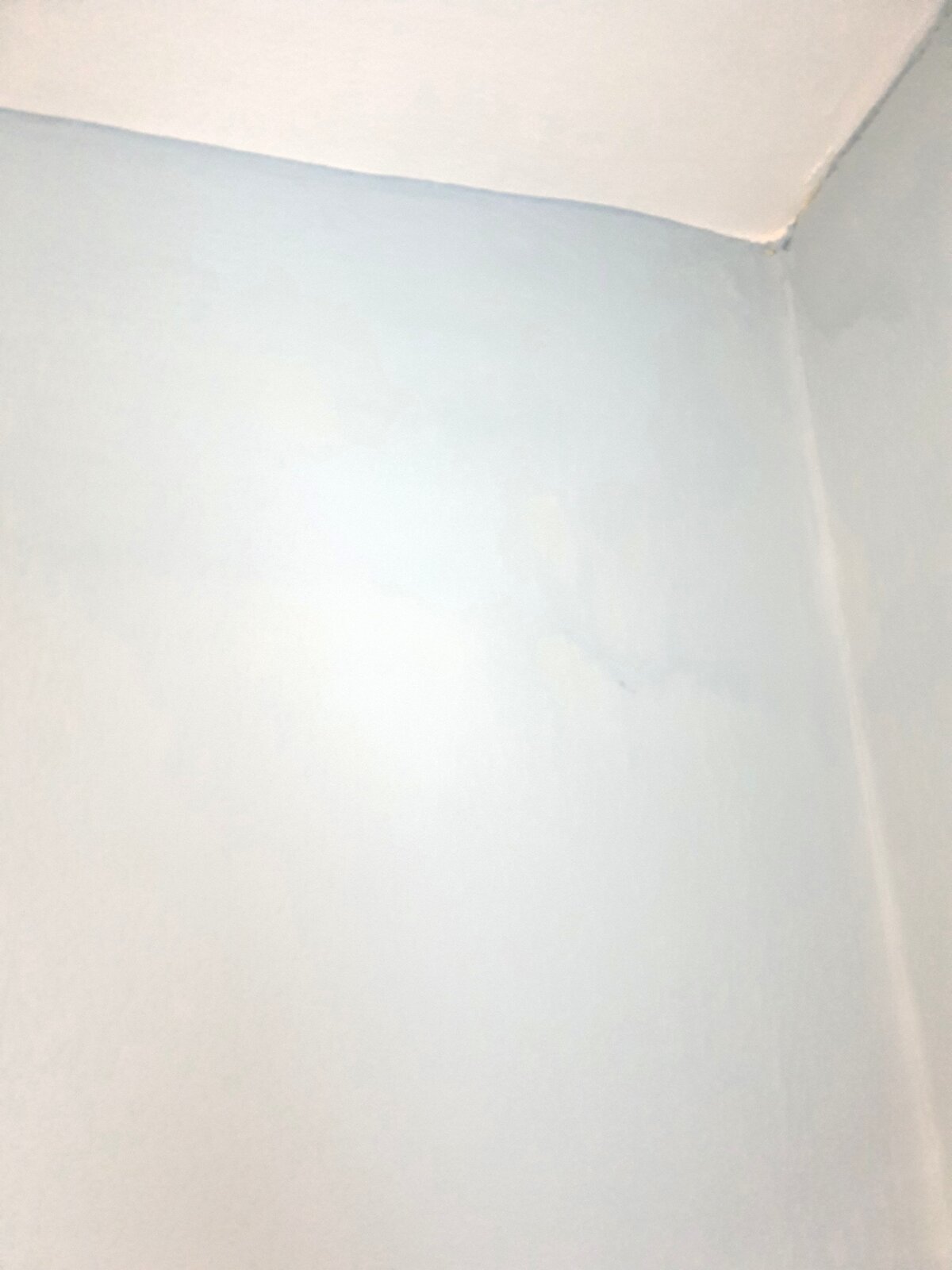

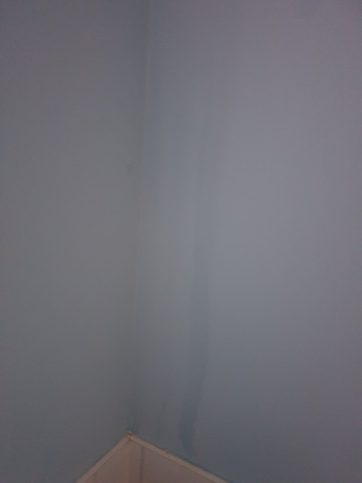

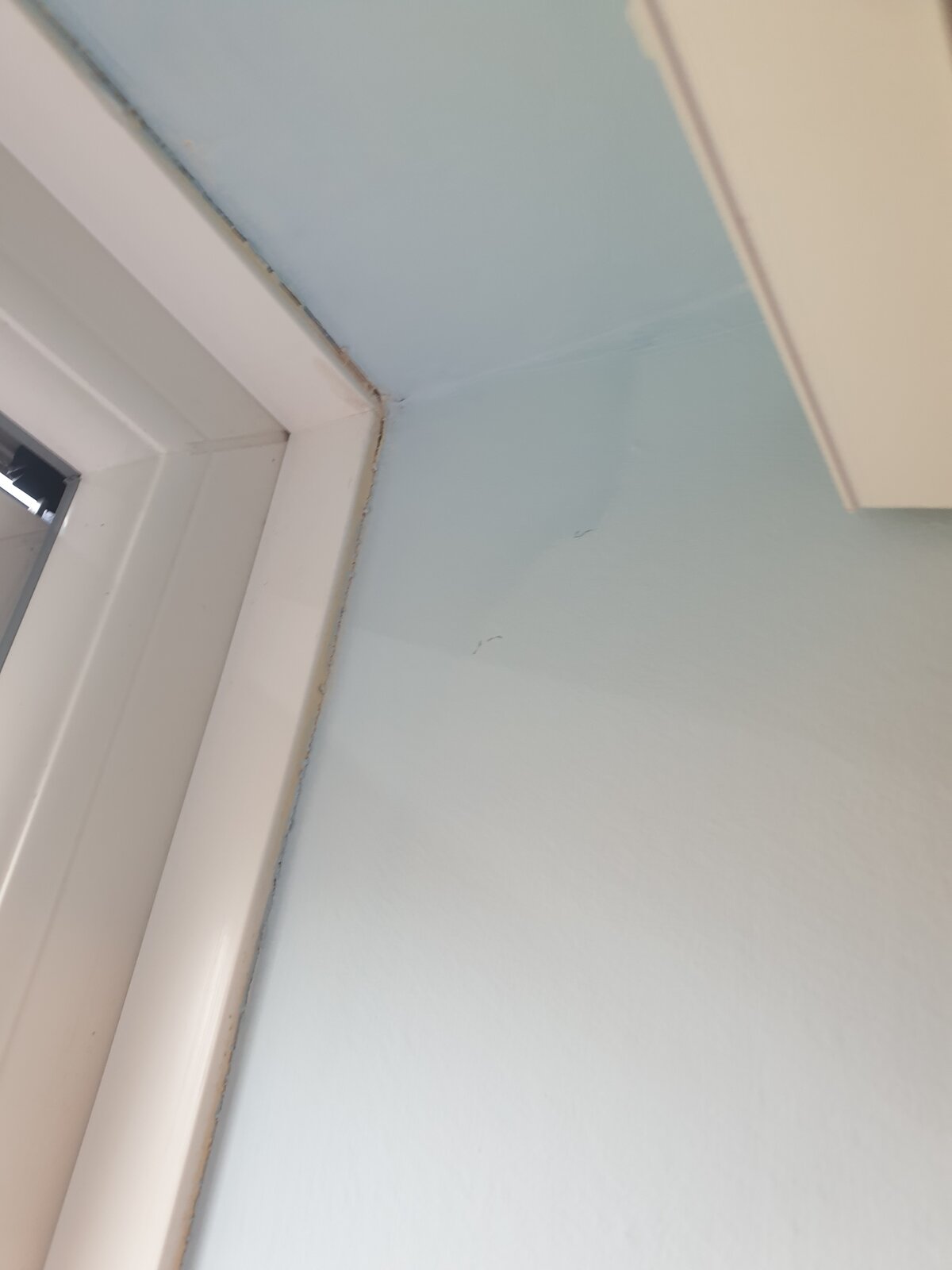

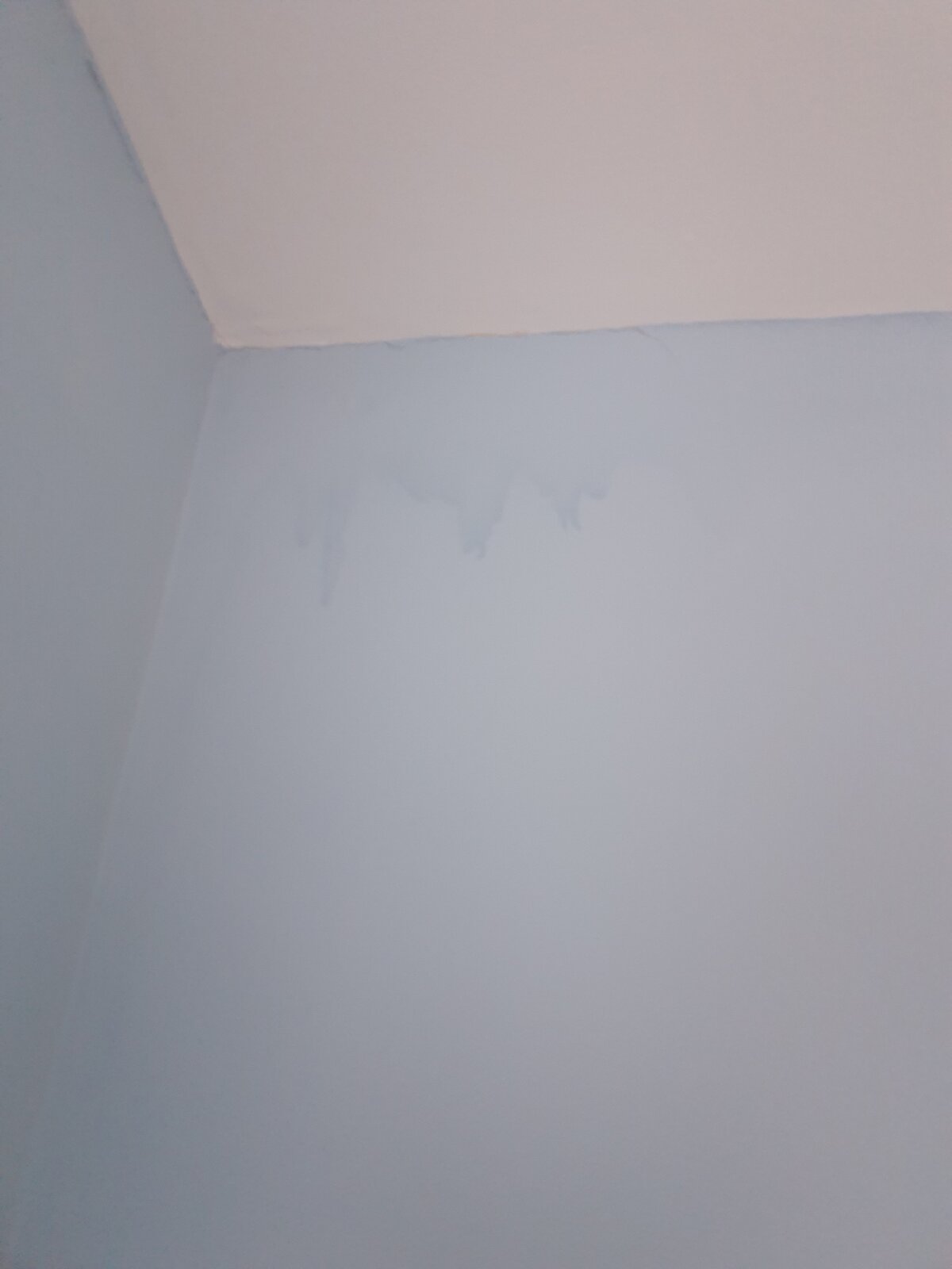

Morning all, looking for some advice with paint issues in our ensuite.
We had it painted back in June, and everything seemed fine. However, one morning neck in January we noticed some streaks that looked like water damage.
However, what confuses me is
  1. It happened overnight
  2. It wasn't raining!
  3. It's worse on one wall, but actually on all three, including under the window reveal (fourth wall has plastic boarding)
I'm really looking for some input as to why this may have happened, and how to go about redecorating. The bathroom has an automatic fan, and we always shower with the window open.
As a final note, I found that the paint used was normal Matt paint over Silk.
Cheers

So it's not peeling it's just looking like water marks? Was any primer put over the silk before the matt was applied?
My guess would be no, in which case I'd use something like Zinsser 123, which is a primer and stain block - that should take it back to looking decent, then use something like trade Eggshell as opposed to normal matt paint, which I think can be problematic for bathrooms.
On and don't be tempted (in my view) with kitchen and bathroom paint - I used some a few years back and it was horrific, I think others said the same on here when I looked.
Oh and if it does start to peel and crack, but only a little, you could use Zinsser peel stop then normal paint - I used that in my old bathroom and got decent results
