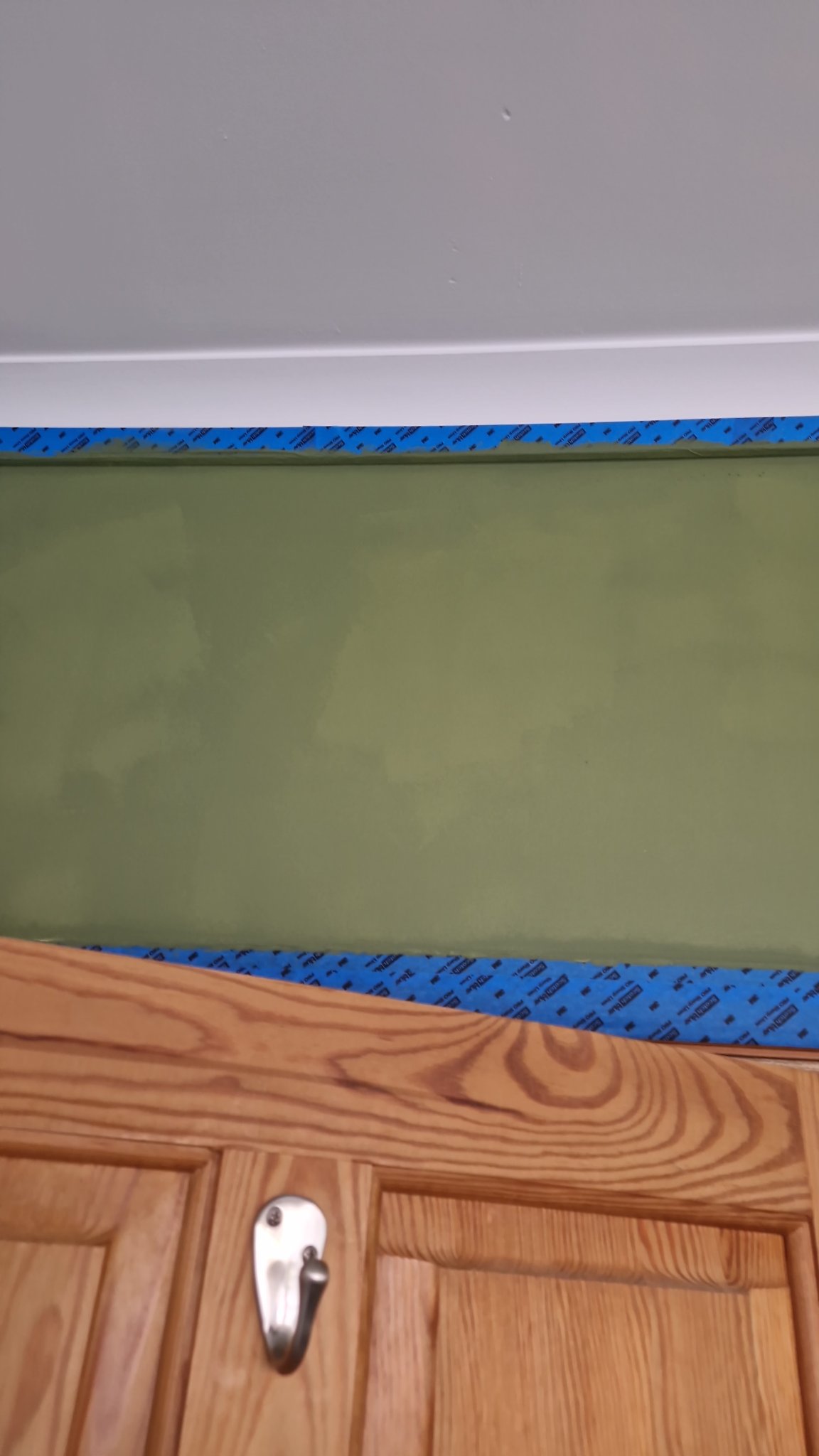

I am in the middle of paintng our bedroom wall and after two coats these marks are still showing through. A couple are filler not sure what the others are. I don't want to waste another coated if its not going to cover them.How can I solve tjis
It's called flashing.
Paint has flashed over filler.
Best way to stop it would be prime the filled area before painting.
Use a tinted primer or add 10% water to paint and mistcoat filler.
Flashing is more common with some emulsions than others but durable (scrubbable) emulsions are worse.

Try a light rub and spot priming.

Its a nightmare, I primed affected area with Zinners 123 and 3 coats have not covered it. I'm at my wits ends

I like to use plain old cheap white as a first coat if you've used areas of Zinser, so as to even out the colour before using the good stuff
