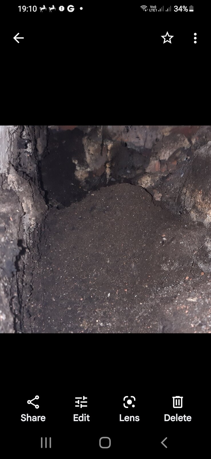

This picture is of the inside of the chimney towards the peeling bitthere doesn't feel like much of a draft at all going up the chimney, but I guess there shouldn't be if it's capped ?
Maybe it would be better to put a new piece of plasterboard on that side of the chimney breast ?
If so is there a specific way of doing it to prevent damp coming through ?

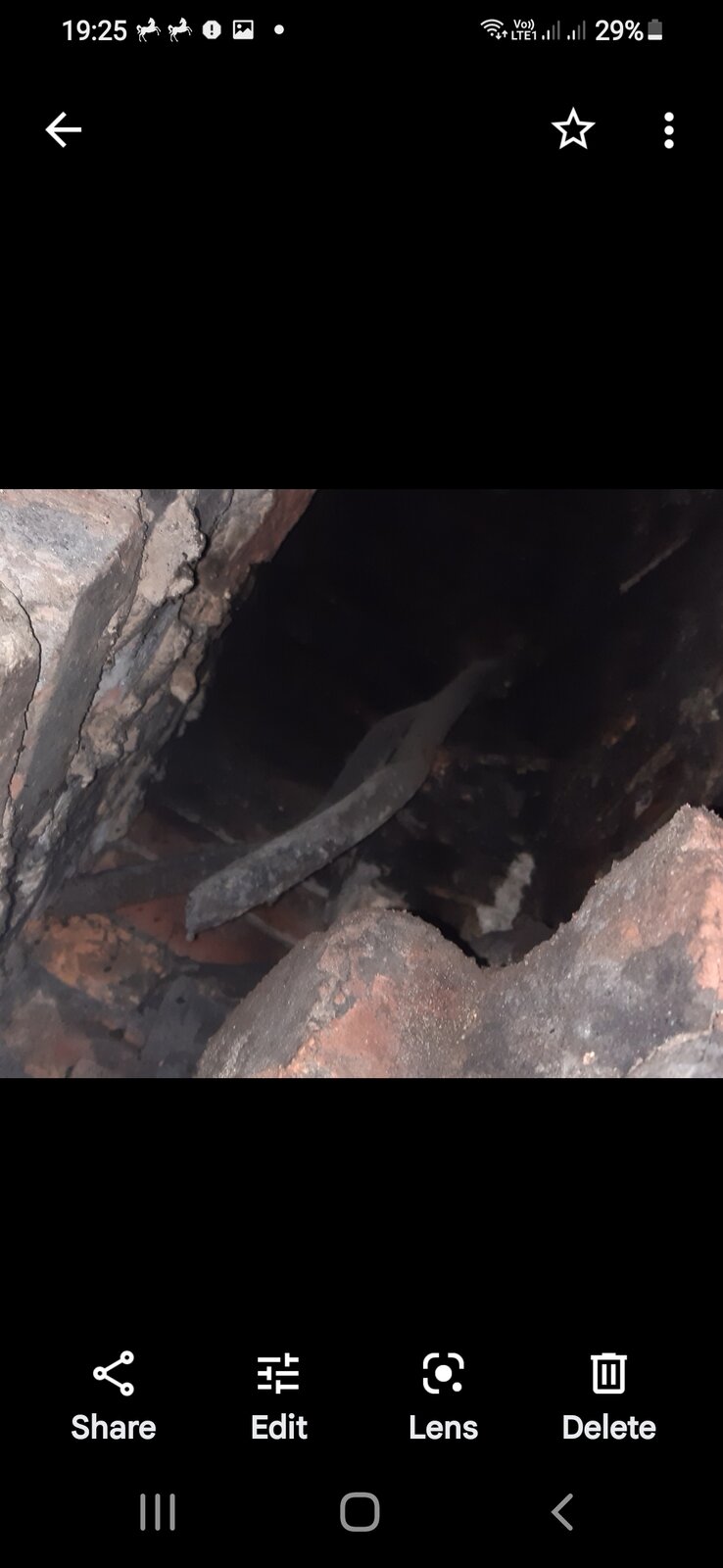

Personally I’d like to look at the top of the chimney stack, where the cement flaunching would be......those air bricks look Heath Robinson ish at best.
As for pipes in the chimney, that’s truly an odd one.....you may expect iron pipe stubs where the original back boiler could have been, but they look like lead!
In old properties, the hearth was laid directly onto the earth and moisture was often absorbed.....this didn’t matter because the fires were lit every day. I like to see the original hearth rubble dug out, a membrane laid and then finished in concrete - which helps greatly but not at the fireplace sides.
Have you ever lifted the floor boards in the vicinity of the hearth for a peek underneath?
