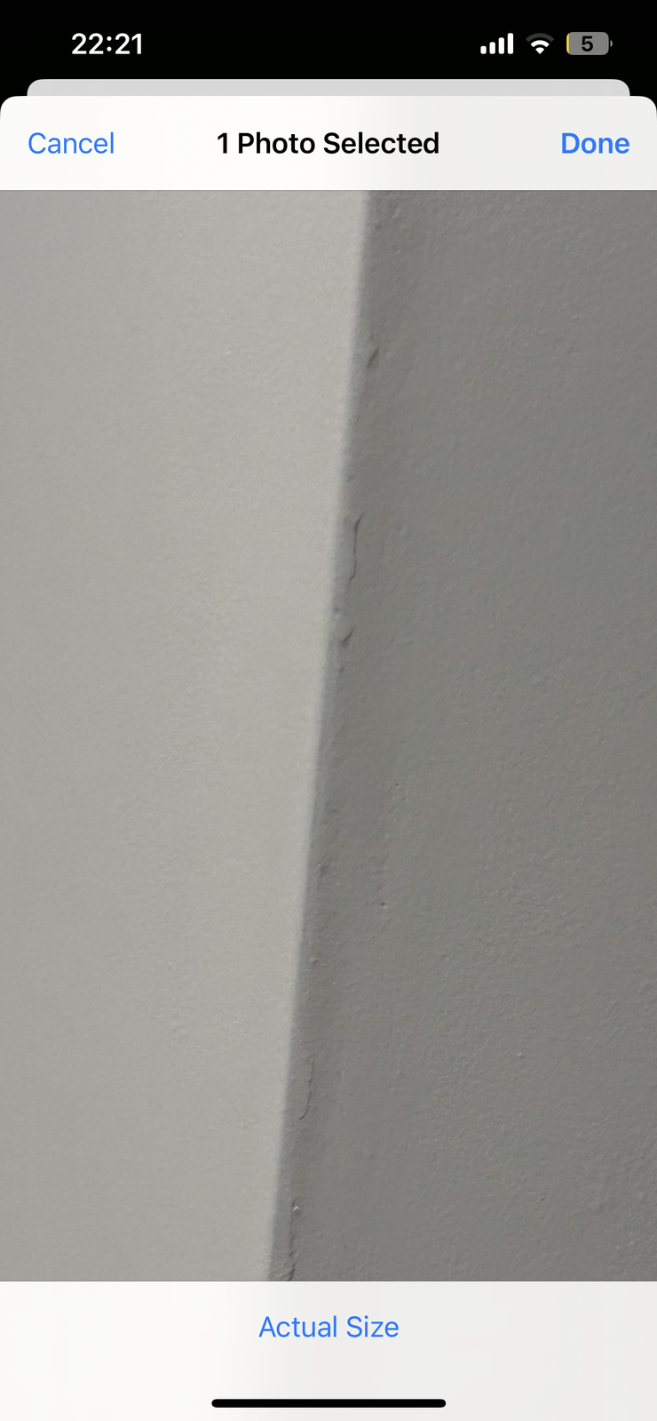

Hi,
Been having recurring issues with paint peeling on this angle coming down my stairs
Any tips to stop it peeling?
Difficult to say...
How long has it been happening?
One option would be to use a sharp blade to cut through loose paint and then fill over it. It might be prudent to squirt a little bit of PVA wood glue in first though- it will help to "lock" the edges of the paint.
Does the angle bead sound solid if you tap it?
Wooden bead? Could be if old and that maybe your problem.
Some were never intended to be filled over.
I'd have a dig and see what's there
It's been happening since we moved in (new build)
Appears to be metal beading edge underneath
I normally sand sand down and repaint but keeps coming back
