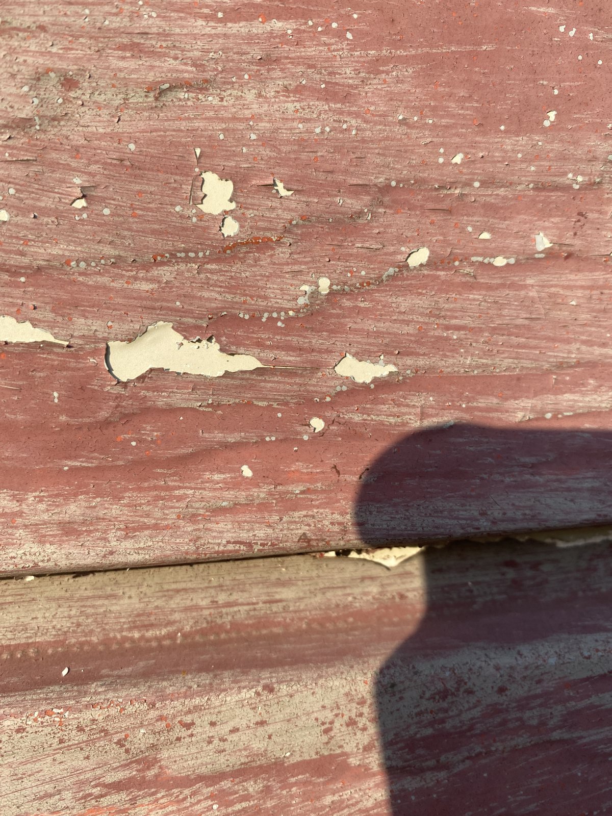

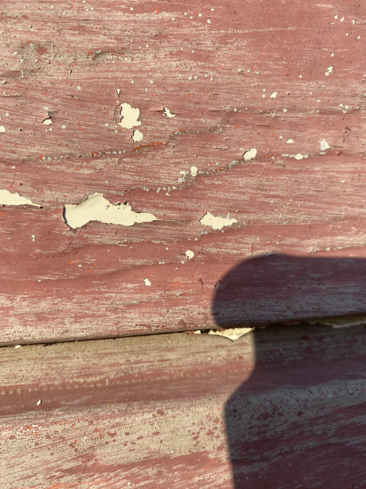

Hello I’m hoping for some advice. The previous owners painted the metal garage door and it’s flaking off. I have a feeling it might have been painted in emulsion which they seem to have been obsessed with. I’ve tried pressure washing it Which at the time seemed to work and then more has flaked off since and using a heat gun which wasn’t particularly effective. Is there a type of sealer I could use to stop any more flaking? I was planning on trying sanding it next and hoping that I could seal it with something to stop any more coming off then painting?

I would try a hot air gun and a scraper. That should help to remove the paint. Plenty of YouTube videos if you wanted to have a squid before hand.
I wouldn’t attempt to seal it, just get it removed and do the job properly :)
Make sure the metal is not galvanised as a lot are especially older ones.

if galvanised it will have a dull light grey appearance, probably with rust marks where screws go in or it has been badly scratched or eroded. The galvanising protects the steel, and the paint prevents the galvanising layer from weathering away.
If you use a scraper or sandpaper, you will scrape off (some of) the galvanising, which is a bad thing to do.

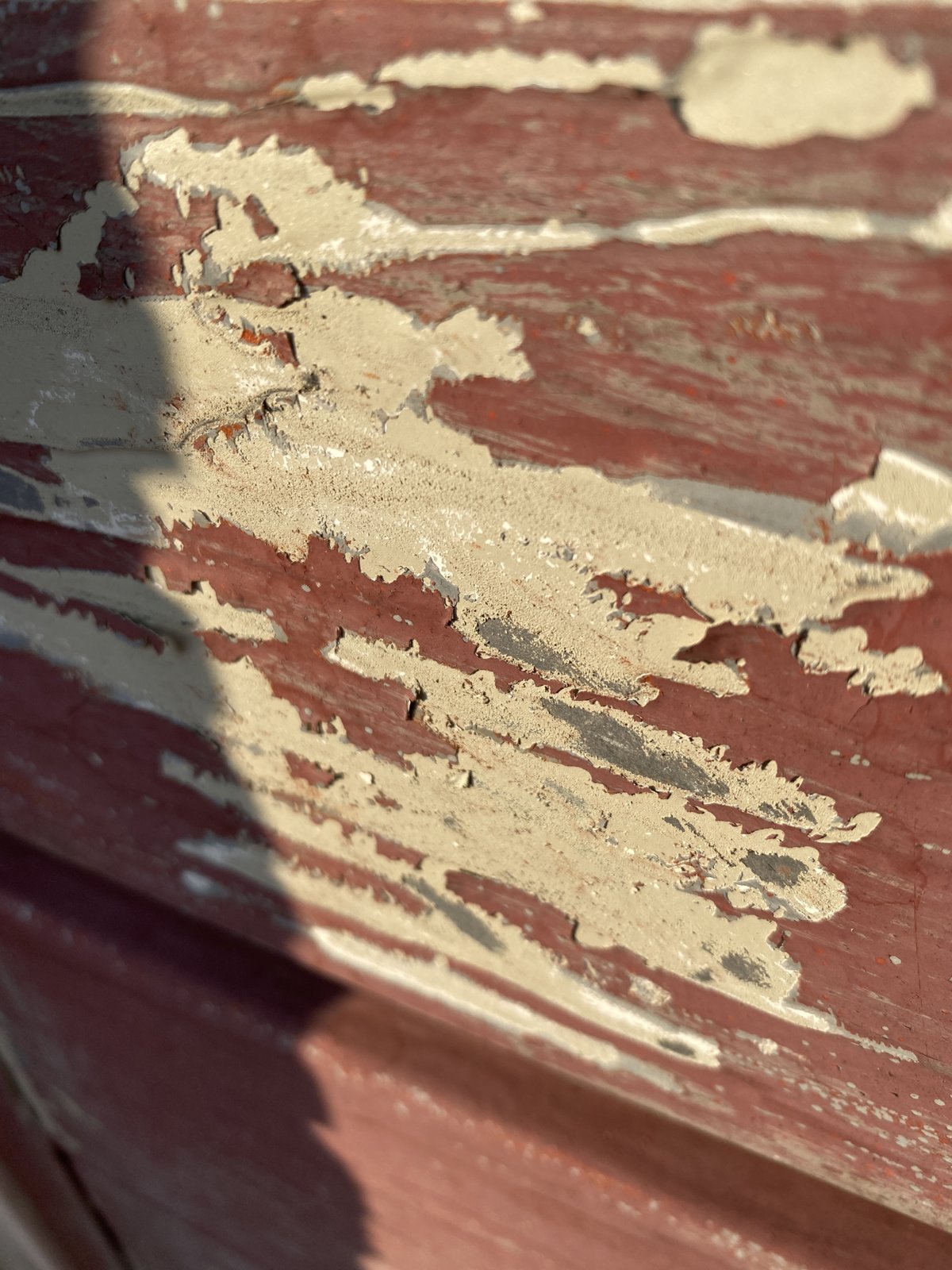

is the red colour the peeling paint, and the sandy layer the old paint or undercoat?
Magnet? it would be attracted if it was galvanised or not, do what jd said but i would ignore the magnet bit unless he thinks it may be ally but ally or galvanised it would need a acid etch primer
There appears to be the top red coat and then a light grey underneath that. Underneath that is the sandy colour which I think is the original bare metal maybe? Perhaps the grey that looks like paint is the galvanised layer? Don’t know if it would come off flaking like this?

hard to tell but to me looks like red, sand, and then the metal as jd said it will be a light grey,.
