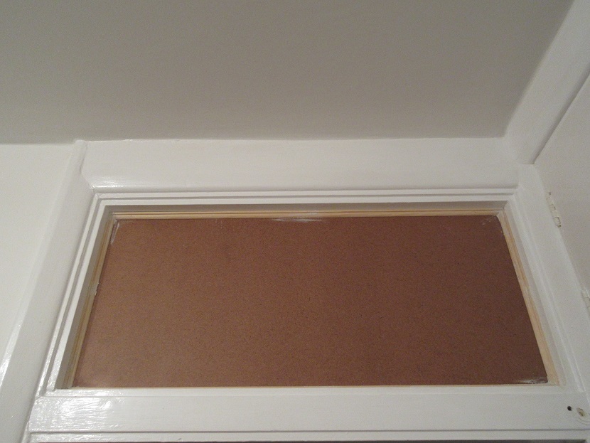

I want to paint a small piece of hardboard on the shiny side. Just want to know if it requires keying beforehand, and whether or not it will need special preparation i.e. a special primer before painting?
"aluminium wood primer" (which dries grey, not silver) is a very durable primer for difficult surfaces. It also seals knots and sappy wood, and wood which has been scorched in a fire.
Some further info, I boarded out the glass panel above the door frame, so it's two of these about 750x300mm approx
Will post up the results once painted.
I second the oil based primer- WB will result in grain swell.
So you did back to back hardwood? ie shiny both sides facing outwards
Yes back to back, other side is exactly the same. Decided not to decorate yet because the current joinery paint scheme is a white water based gloss, so I'm going to wait and decorate all the joinery in the hallway in one go with an oil based satinwood paint.

Eggshell doesn't need an undercoat but it should have a primer. However you could probably get away with thinning the first coat with white spirits and then applying (slightly) more coats of the full fat eggshell over it.
