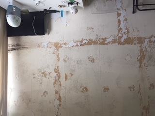

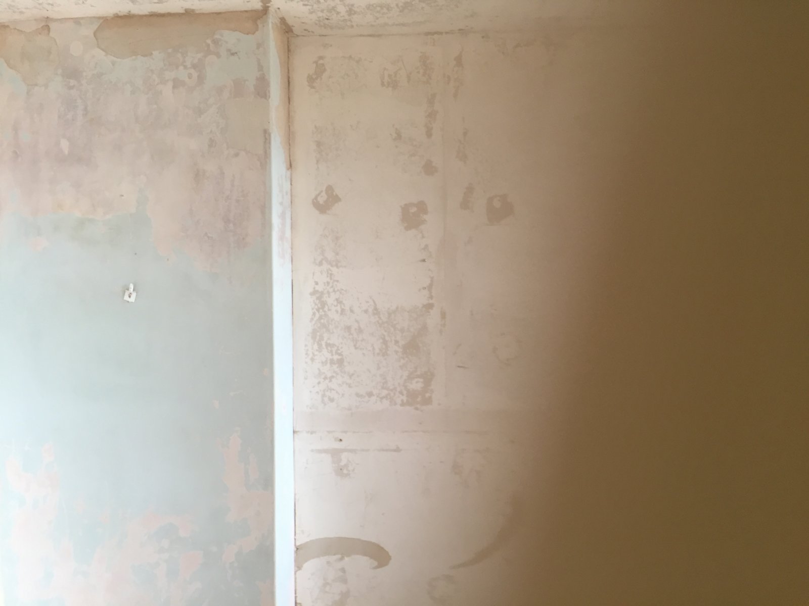

Hello,
I put these photos out. i wish to start painting these wall but on taking wallpaper out i got this. Don't think i can just paint over it. Can someone help me how to go about painting these walls. I painted other walls in my flat but they were easy because there was no wallpaper just solid wall to paint.
any advice much appreciated. any good videos out there you know of that shows how to paint similar walls.
Thanks.

no its purpose build ex-council flat, i say build in 60s. there is some black areas on wall.
black areas are usually mildew caused by damp walls. Are these in a bathroom?
You need to scrape off the loose material. Probably a broad metal scraper will do it. Generally, if it adheres too tightly to scrape off, it is firm enough to paint over, but you will need a thin film of filler or the surface will look scabby.
Wet the wall first, then your scraper will also remove the residue of wallpaper paste, it will come off like sludge on your scraper. Wet it using a plant mister or garden sprayer. Add a tiny drop of washing-up liquid.
On a test sample, try wetting some of that old paint with boiling water. If it comes off with boiling water, but not with warm, it is distemper (which it looked like to me) which is a much more difficult surface. The age of the building is very relevant. It was not so often used by the 1960s but will be in older houses
Do i apply the filler all over the wall to make it even before i start with paint.
Try your own technique, but on a scabby wall, I sometimes apply filler very thin, pressing hard with a broad metal knife so it goes into the dips and scrapes off the high spots. You may need to lightly wipe with extrafine sandpaper if you haven't got the hang of it, but filler is very soft and you can easily rub it all away. you can also scrape it smooth with a broad metal scraper.
With practice you can get better results with fine finish plaster, mixed up to custard consistency, and wiped on with a plasterers trowel, which is very wide. Plaster is cheaper and more durable than filler, but it sets fast so you must work fast, and work with a small amount at a time. Once initial set, you can spray it with water and polish the surface. Don't sand it, as the trowelled finish will be smoother than a sanded surface.

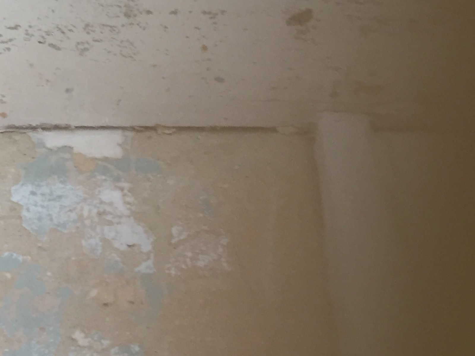

I removed all wallpaper, have question as per photo how to seal these gaps between wall and ceiling wall
Decorator's caulk, available in a large tube and applied by gun.
It is white and can be painted.
Silicone is more flexible and less prone to sink or crack, but won't hold paint. If the ceiling is white it may not show. Smooth it with your finger or a plastic tool, remove all excess.
Clean away all dirt and dust with a hoover then a small damp brush, caulk will not stick to it.

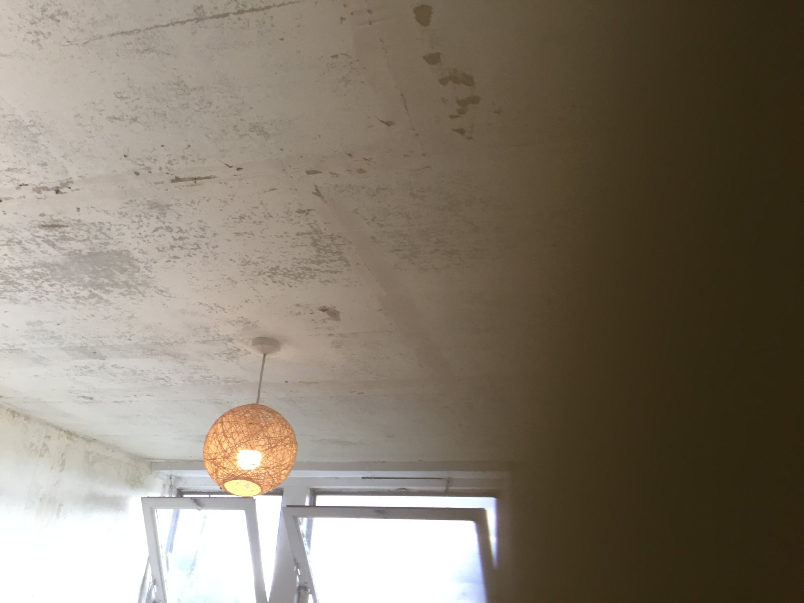

This is how it looks at present, forgot to mention that I clean all walls n ceiling with anti fungus spray.
Don’t understand what you mean by mist coats, can u please shed some light on it
Dulux super Matt was recommended by diy man to apply before normal Paint.

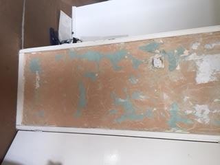

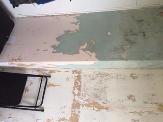

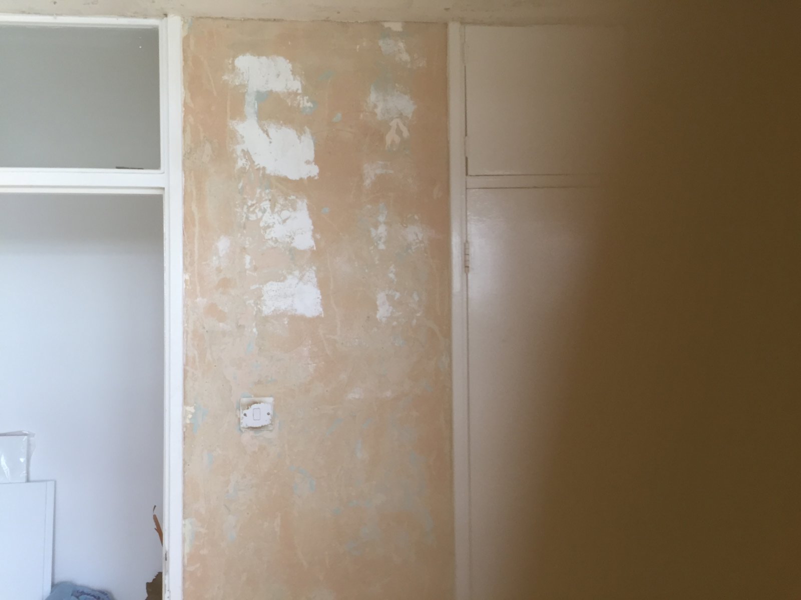

Can someone tell me if new plastering is required, or I start sanding and apply paint. If you see some part of walls are blue and behind is cement wall. Is sanding over it and then Painting is fine

a chemical spray does not remove dirt or old paste.
One method is to wet the wall and scrape off the softened dirt and paste with a broad metal scraper.
What was the cause of the black marks?
Few questions
Can I use electric sander over the blue paste you see and also should I sand the ceiling or just paint it (already clean it)
Also pls advice if I really need to plaster the walls, can I just use electric sander and filler to do job before painting

If you have already cleaned and scraped the walls and taken off all the dirt and paste, you can apply thin filler to any low spots and sand any scabs. The filler should be so thin that you can practically see through it. Use your broad metal knife to press or scrape it smooth before it goes hard. When you paint it white, that will highlight to the eye any remaining defects, so fill or sand them smooth before applying your finish paint.
An electric sander will make a vast amount of dust. Filler can (if necessary) be lightly wiped with extrafine paper to smooth it, by hand.

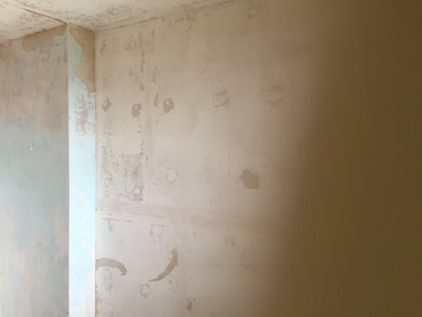

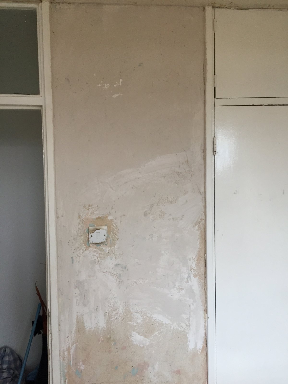

I just applied a Two coat filler by hand as you can see, i will let it dry it overnight and apply sanding over it tomorrow then this part looks be ready to paint soon.
Can you suggest what to do with the plasterboard wall that is the big wall in previous photos. Do I need to apply something or sand it before paint, any suggestions
