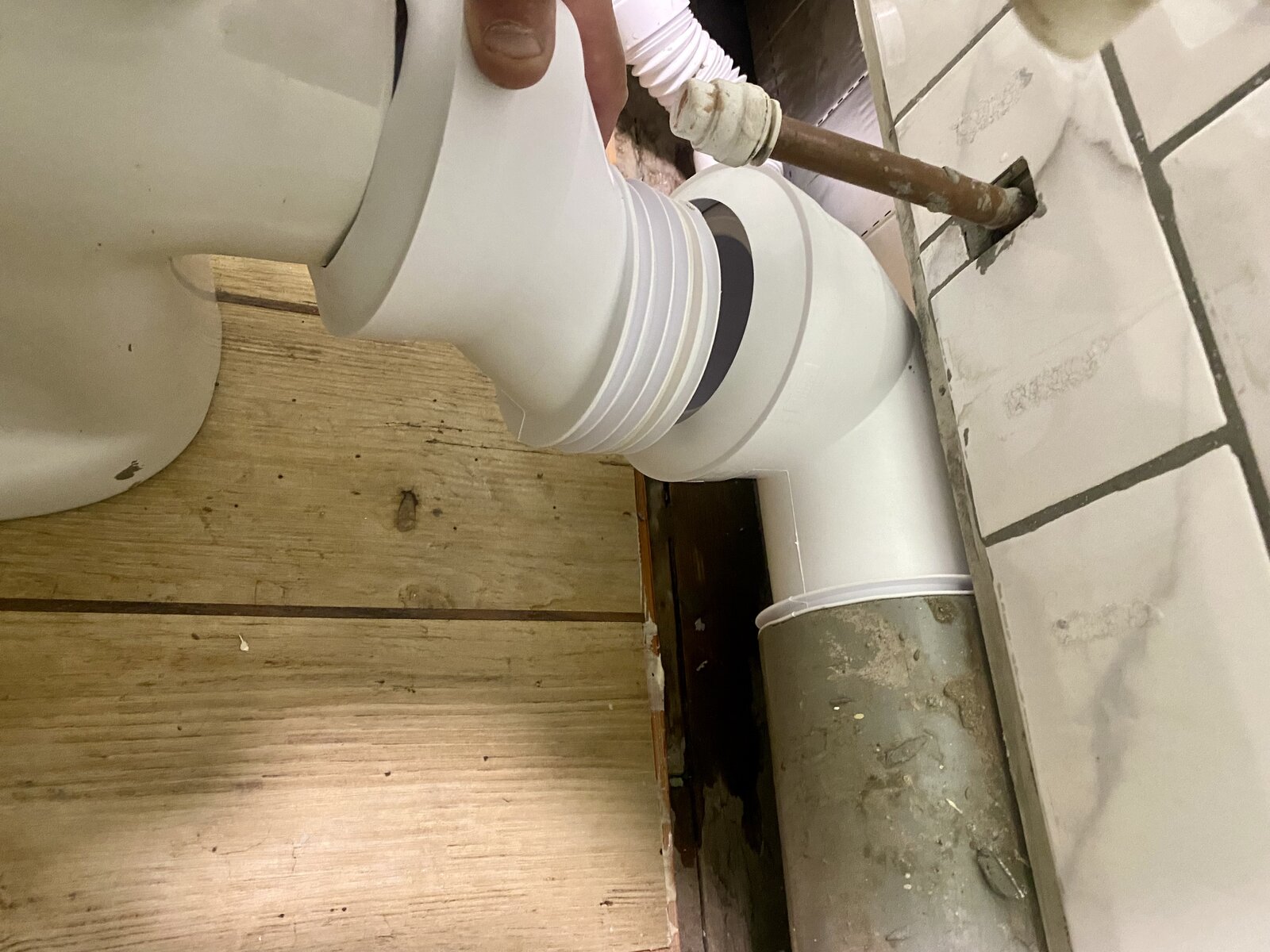

I have changed my bathroom around and added wall insulation, new shower etc. the flex pan connector I have is no longer ok for what I need as the toilet has moved forward about 100mm and more to the right going towards the soil outlet.
The soil pipe is in the same position.
So I now need to figure out how to connect into it.
In the photo it shows my solution, but I need to get a little bit of soil pipe to go in between the two connectors.
I tried to find another flexi but couldn’t see anything I could use. Will my solution be ok or is there an easier way?

The L shaped flex doesn’t work as the soil pipe would need to be moved in line with the toilet moving forward.
A flexi is fine but it can’t accommodate coming forward about 100mm
