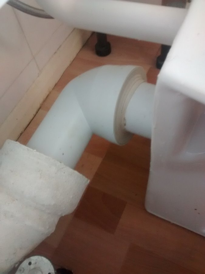

Hi All
I've just found a bit of a bodge - see the pic. An offset pan connector, connected to a right angled pan connector, daisy-chained into the soil pipe. It's not currently leaking (there are signs of a previous leak) so I'm torn between sorting it out properly, and "if it ain't broke, don't fix it".
What do you think?
If I do fix it, how do I joint plastic 110mm waste into steel soil pipe? You can see the soil pipe has an enormous flared connecting part and I don't know how to joint to it with modern plastic soil pipe.

If its not leaking what is the problem,
You could remove all the Cast Iron Soil pipe and replace with plastic
