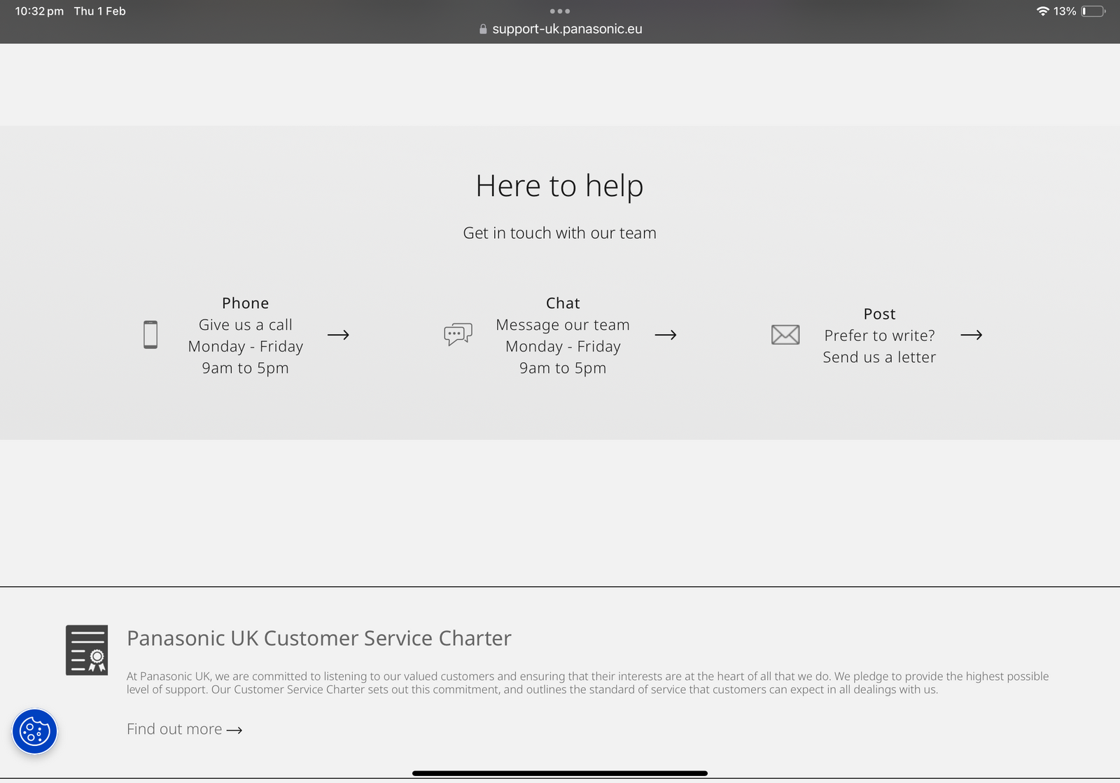

Might be a silly question but have you tried their customer support chat/phone lines?
