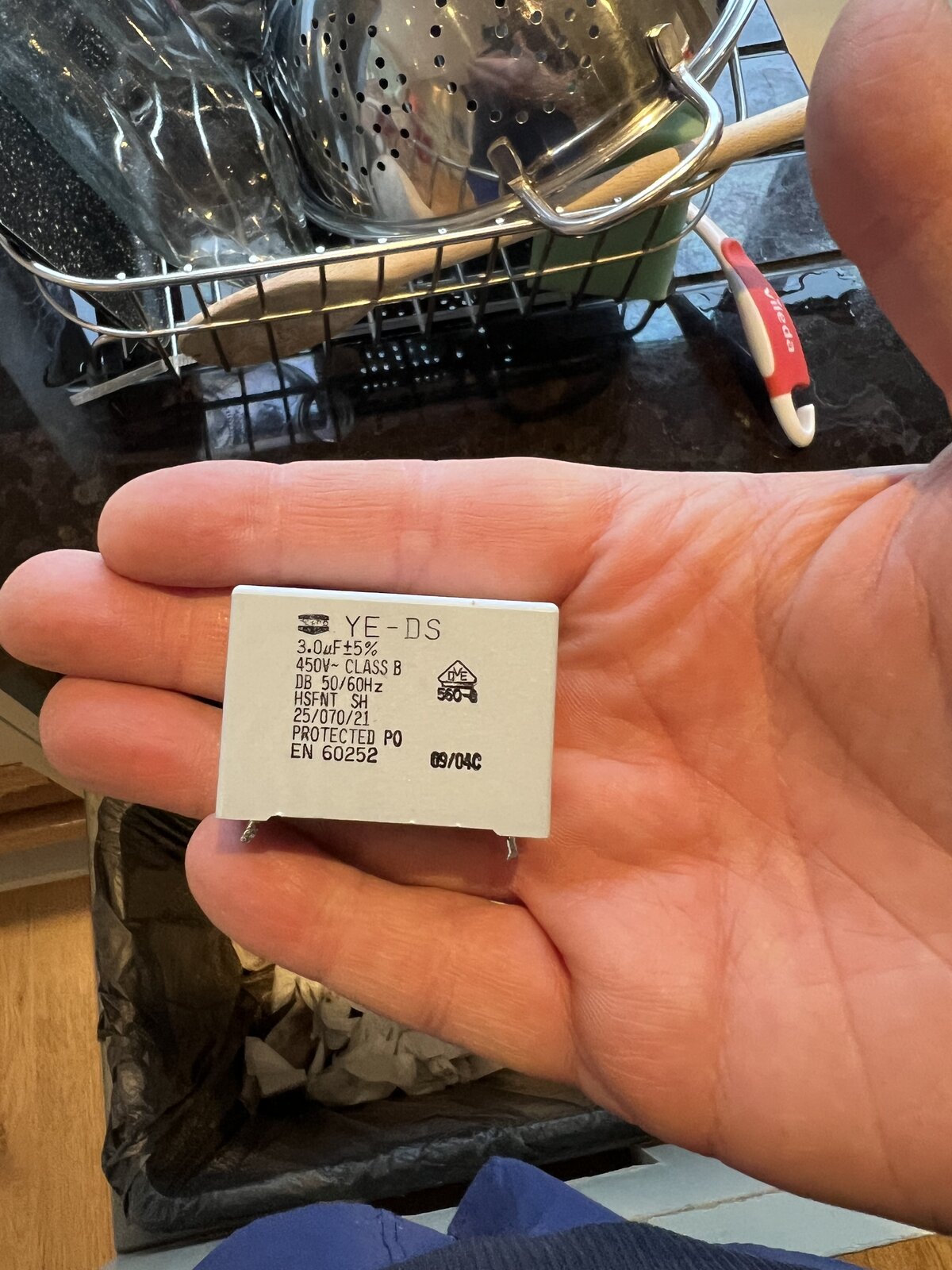

You guys are all amazing! I have a Panasonic SD-255 that I’ve used regularly for about 16(!!) years. The last few years it’s produced pretty stodgy bread, seldom rising above the pan; and the last couple of weeks it’s been getting even worse.
So today I replaced the capacitor using the above instructions. I bought one on amazon for £7
https://amzn.eu/d/h9T3zXC
I’ve put it all together again and started a cycle and the mixing motor is really going for it, with a renewed energy that I haven’t heard for some years!
Hopefully all is now well and thanks to this forum for saving me over £100 on a new bread maker!

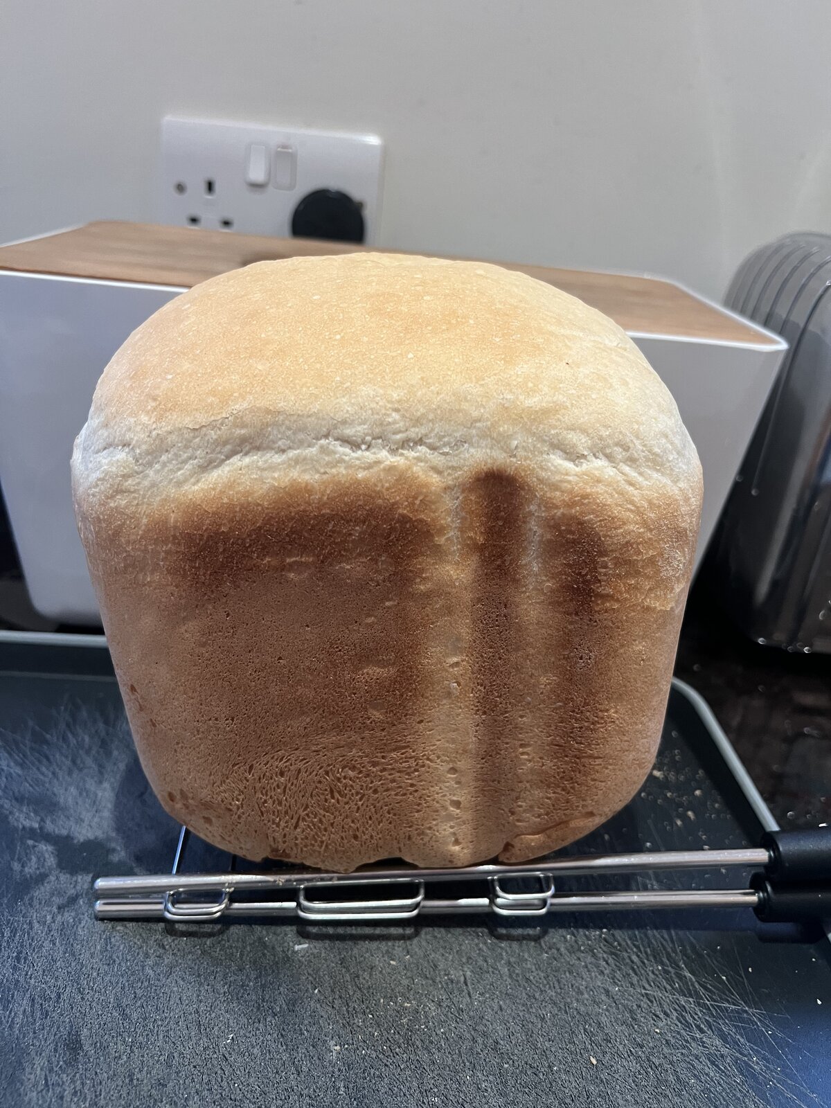

Not had a loaf like this in at least five years!

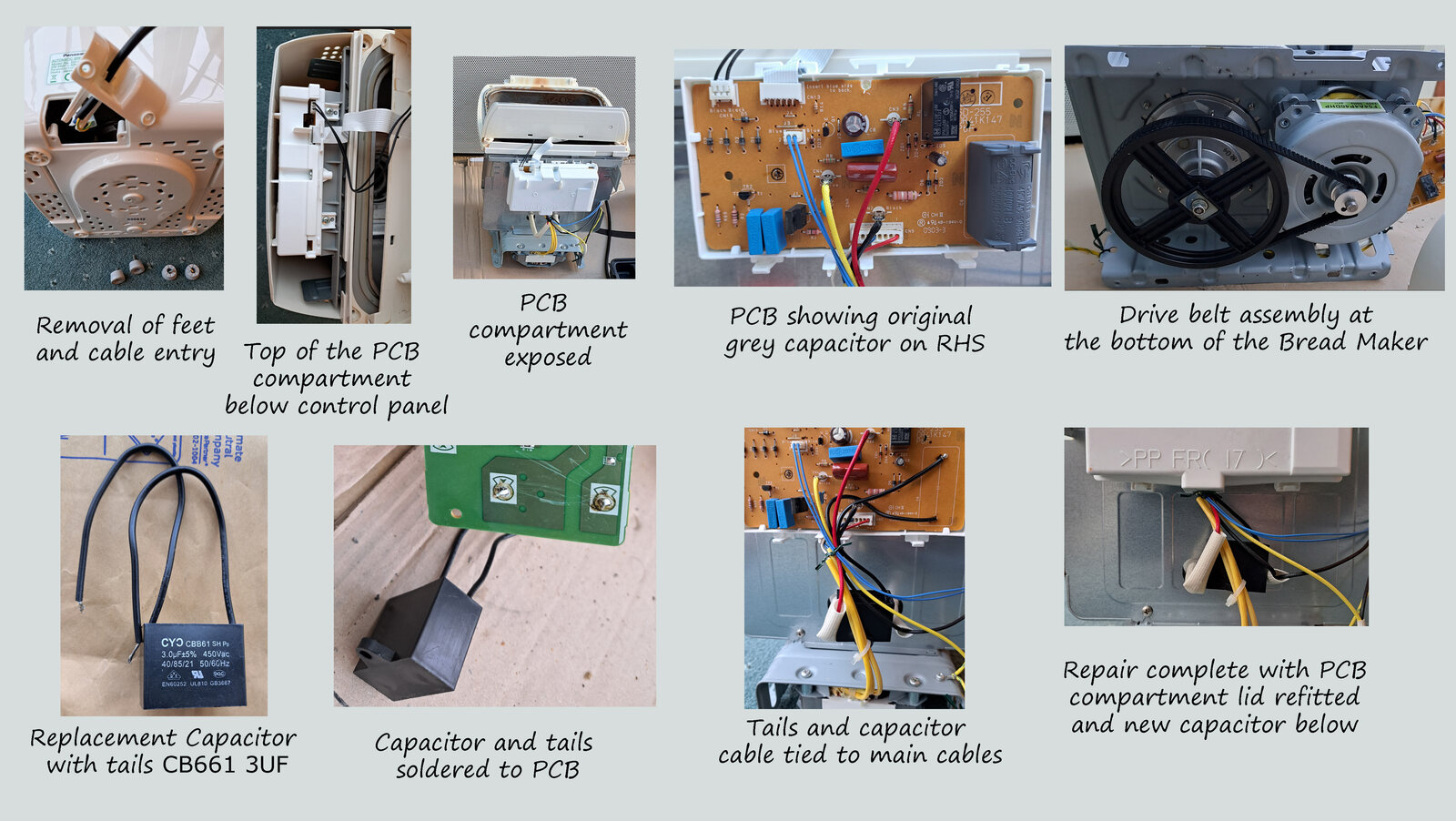

What to do when you have never seen a bread maker, let alone used one, but your 88-year old aunt thinks you can fix anything! The answer is simple and if you have found this thread you are already a good way to solving the issue. If it is not a loose/broken drive belt, then it is likely to be the capacitor.
I know nothing about electronics but can do a bit of soldering which resulted in the desired fix.
In order to help anyone else, I have put together a compilation of photos to show the process for my aunt’s PANASONIC SD-255.
When I tried the machine, the paddle turned but the power did not look sufficient to mix dough. I had no way of testing the capacitor as my muti-meter does not cater for microfarads (a measurement I had never heard of before). The difference when I had replaced the capacitor was very obvious and a well spent £12 (Nov 2024).
There appear to be two types of capacitor available for this model, one with pins which is soldered directly onto the PCB and the other with two long wires sticking out of the bottom.
I chose the latter on the basis that if I messed up the end of a wire I could just cut it back and try again. Once soldered on I could have stuffed it into the PCB housing compartment but I chose to take the tails out of the bottom and tie it in neatly to the cables that were already there, as shown in the pictures.
My thanks to all the previous posters without whose advice I had no hope of fixing the bread maker.

Great job @LNW56, I did exactly the same thing with my SD-255 this very morning, as mentioned above. I failed to take any photos though!
But I DID choose to stuff the new (same one as you bought) wired capacitor into the PCB housing. I was worried that letting it dangle below the housing would leave it too close to the heating element inside the machine - one to look out for.
Also, interestingly, my OEM capacitor was different to your aunt’s!
@Csfulham, I followed the process mentioned in earlier posts where the capacitor was left outside the PCB housing. I ensured that I had a cable tie low down, around the yellow cables and through the screw hole tab on the new capacitor which keeps it well away from anything metal.
Great picture of a loaf – now I know what these things do as I have yet to see it in action!
