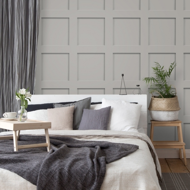

Hi all..
I have a wall 4300 long and have panel wall paper 530 in width.. so just over 8 lengths needed.
Any advice as this wall paper has a panel pattern on it like below.. do I still start in the middle and add a little 50mm slither at the ends?

As a Decorator in the past I always started the first drop of wallpaper in the middle of a wall , then get the middle of the wallpaper and measure either side of the wall middle line so the first drop is dead centre on the wall so one ends up with identical pattern at end of wall , just work on the filler with a medium grit and finish off with fine
