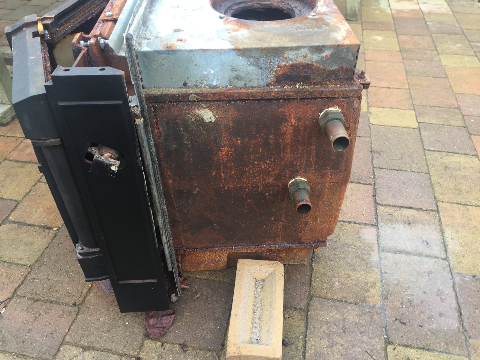

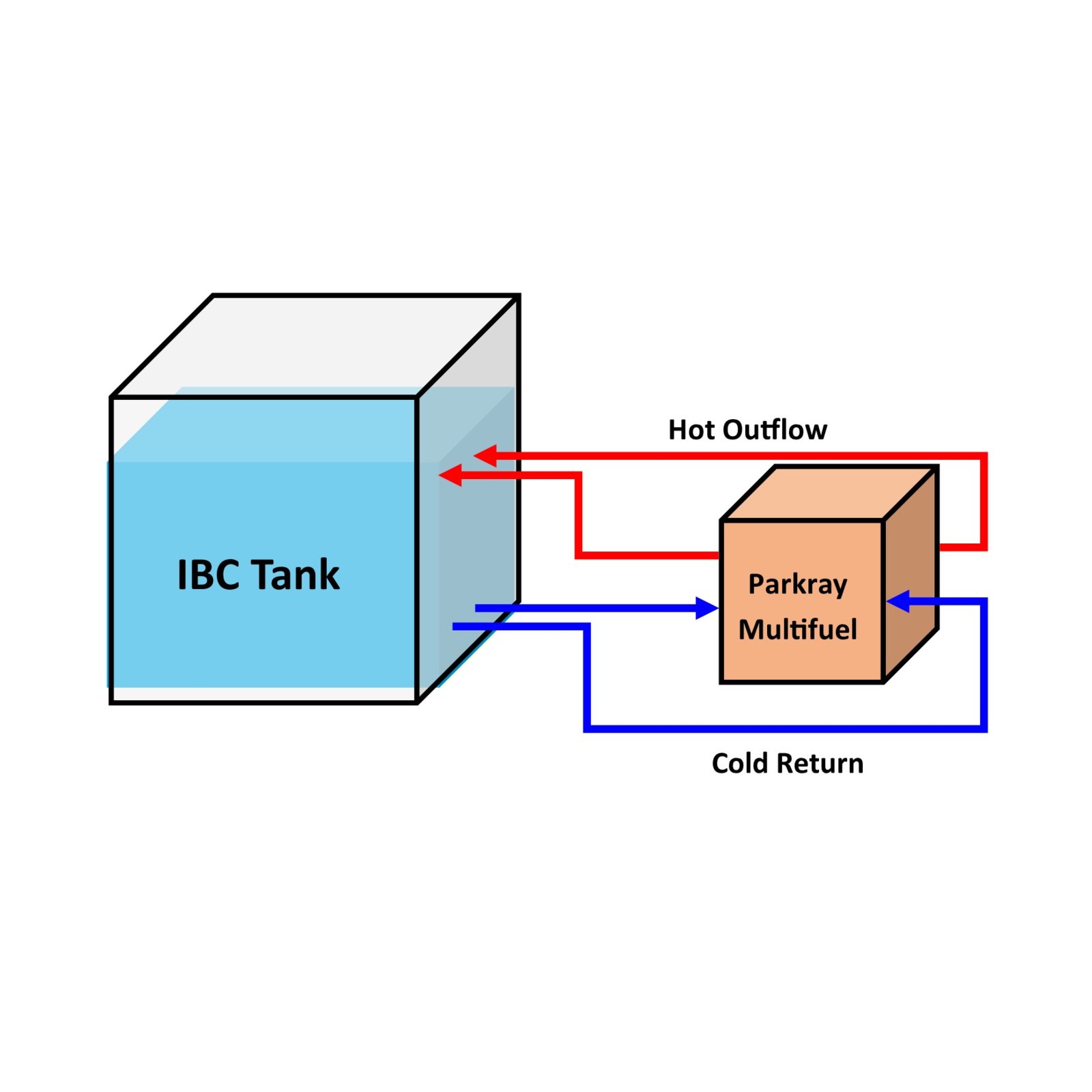

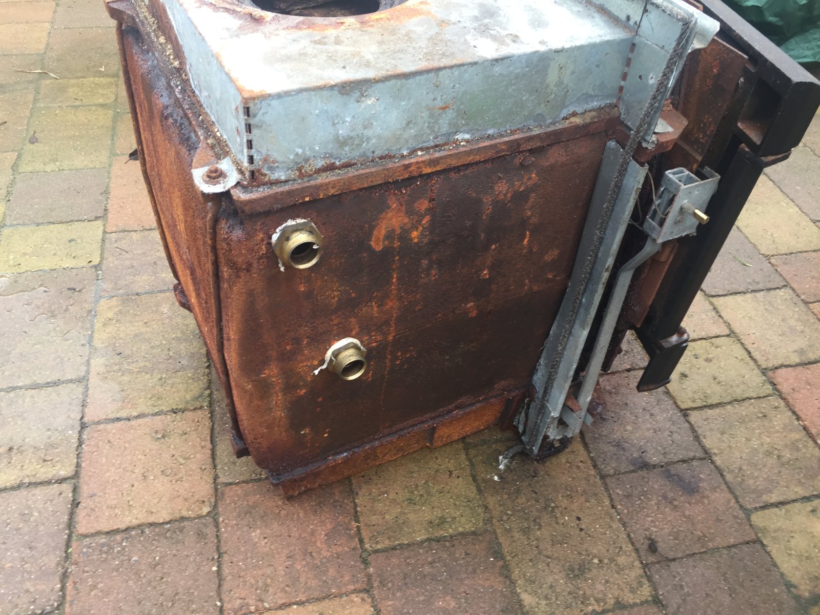

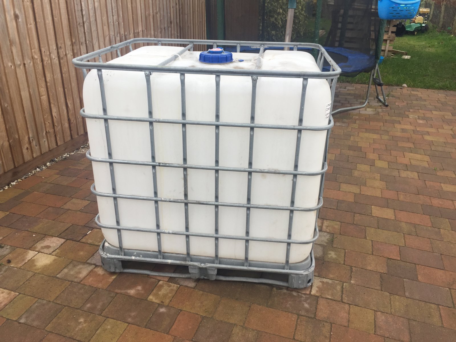

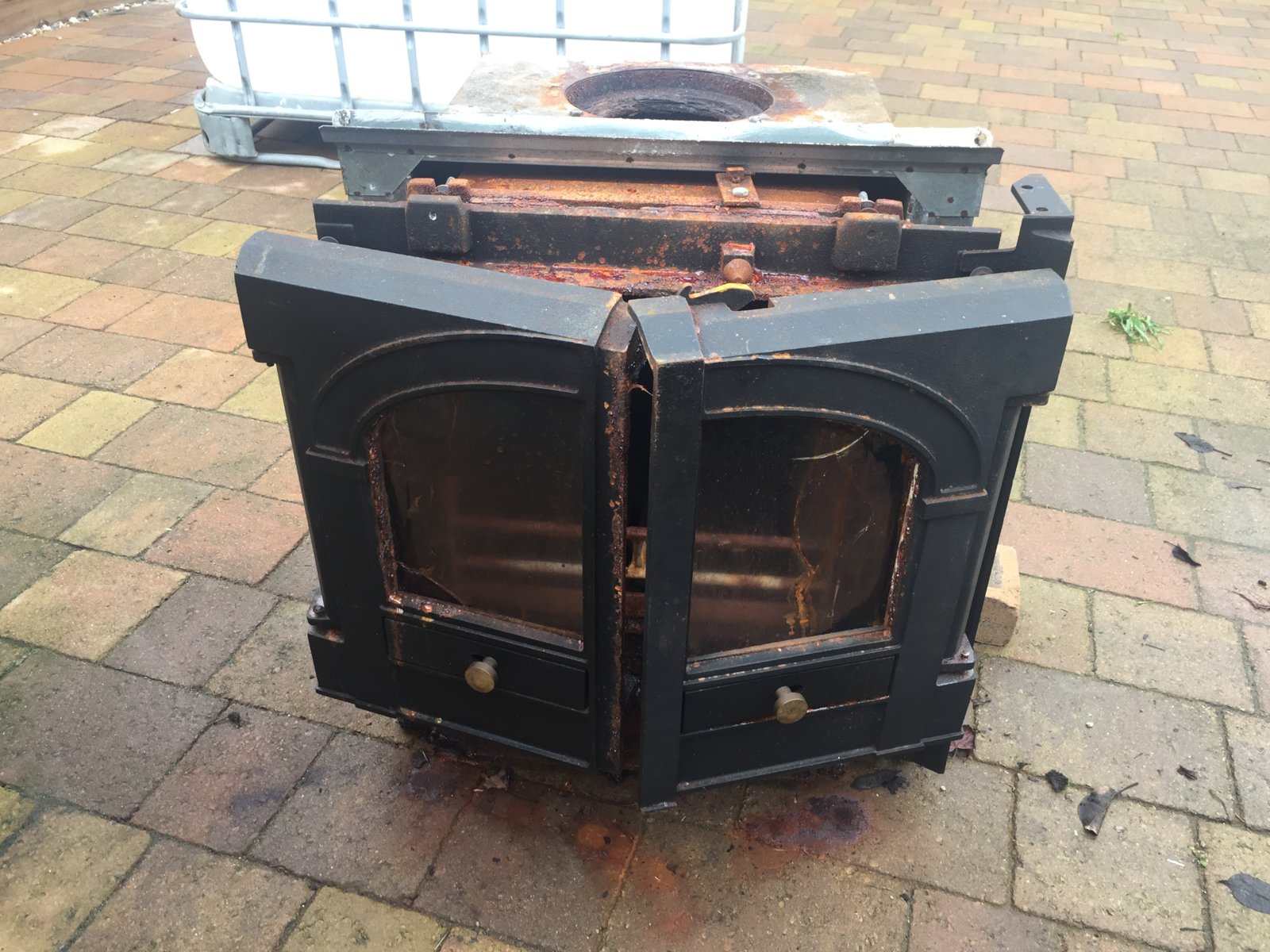

Thanks all and sorry for the delay...the project got put on the back burner for a couple of weeks (pun intended!). Below are pictures of the actual IBC tank and the Parkray along with a sketch of my plan. As suggested I'll keep the bends in the pipes to a minimum and try to maximise the height difference.
Can any one advise on the Parkray piping? I'm assuming originally two were for hot water and the other two for central heating.
Am I correct in assuming I will therefore need to connect all four pipes (as shown in my sketch)?
Also, am I correct in assuming that the cold inflow pipes are the bottom pipes either side on the Parkray and the hot outflow are on the top on each side?

I'd be inclined to site the tank a bit higher than the stove if possible, to turn the stove so that the flows and returns are symmetrical and to extend the copper stubs on the stove a meter or so before thinking of transitioning to plastic!
Thanks, it will be difficult to make it much higher (it will need steps to climb in as it is). I had thought about when would be safe to transition to plastic. I assume there is some benefit in less heat loss from plastic but I can't imagine it will be much over such a short distance, therefore I was thinking of keeping it all copper - especially as I will have to buy a length anyway and may not even need any more.

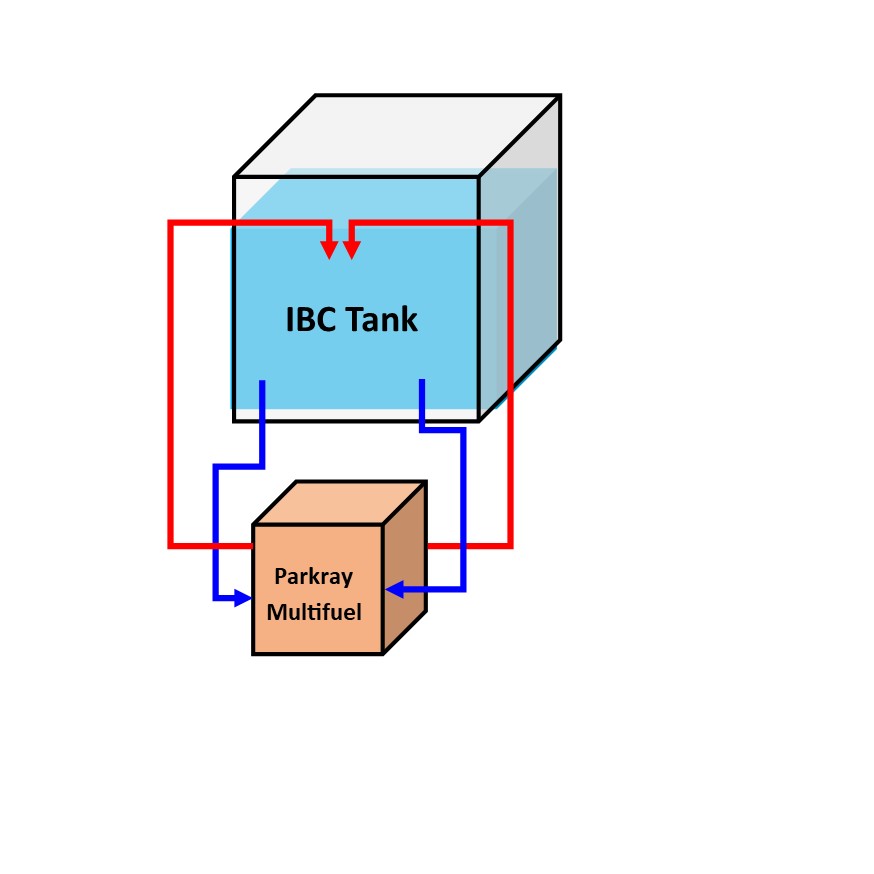

More symmetrical makes a lot more sense. Perhaps something like this.

In order to vent, the flows need to rise continually.... not drop back down.
Less horizontal and bends the better.

If I were you'd I'd think about how to insulate the tank as well as the pipes. Just wrapping some loft roll around it, for example.
And improvise a warm lid to put on while you wait for it to get up to temperature.
