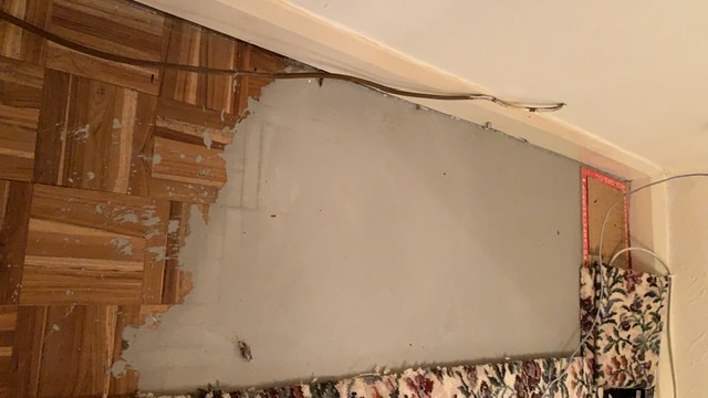

Just moved into a new house and found out that under the carpets in the original house that parquet was laid. The house was extended and it appears that screed was poured into the extension and partly over the original parquet in the original house.
we want to tile the whole downstairs with with underfloor heating.
can we latex over the parquet or does it all have to come up?
got a tiler coming on Monday but would appreciate some advise in the meantime.

I don't know the answer but are the floors solid concrete or suspended?
Are you going for water based heating or electric?
AFAIK, most underfloor heating systems need/benefit from having some kind of insulation applied underneath them. Without sufficient insulation you may find that you have to run the heating at full whack to notice any gain. Why, for example, let your set up heat the foundations of your home?

That's finger parquet and is pretty thin compared to the "proper" type
I suspect that it's better to lift the whole lot and start again
Otherwise you risk a higher floor level throughout
