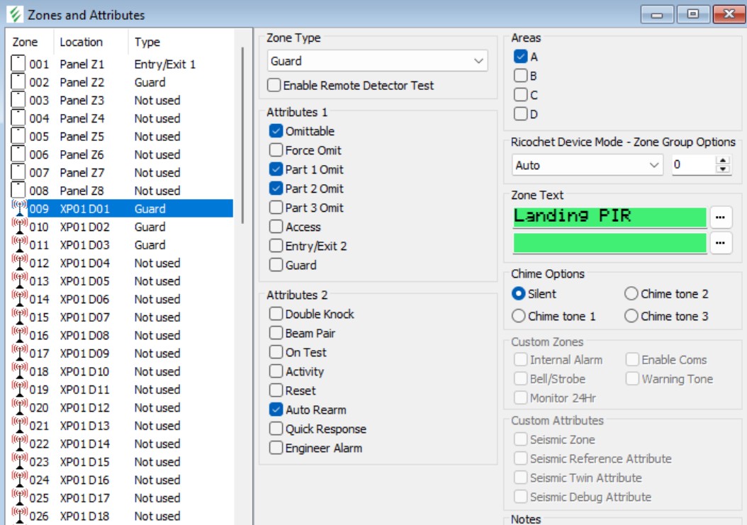

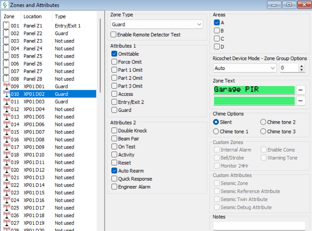

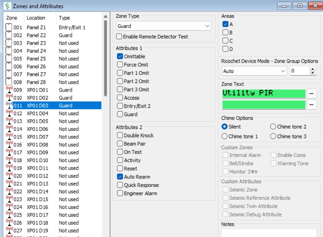

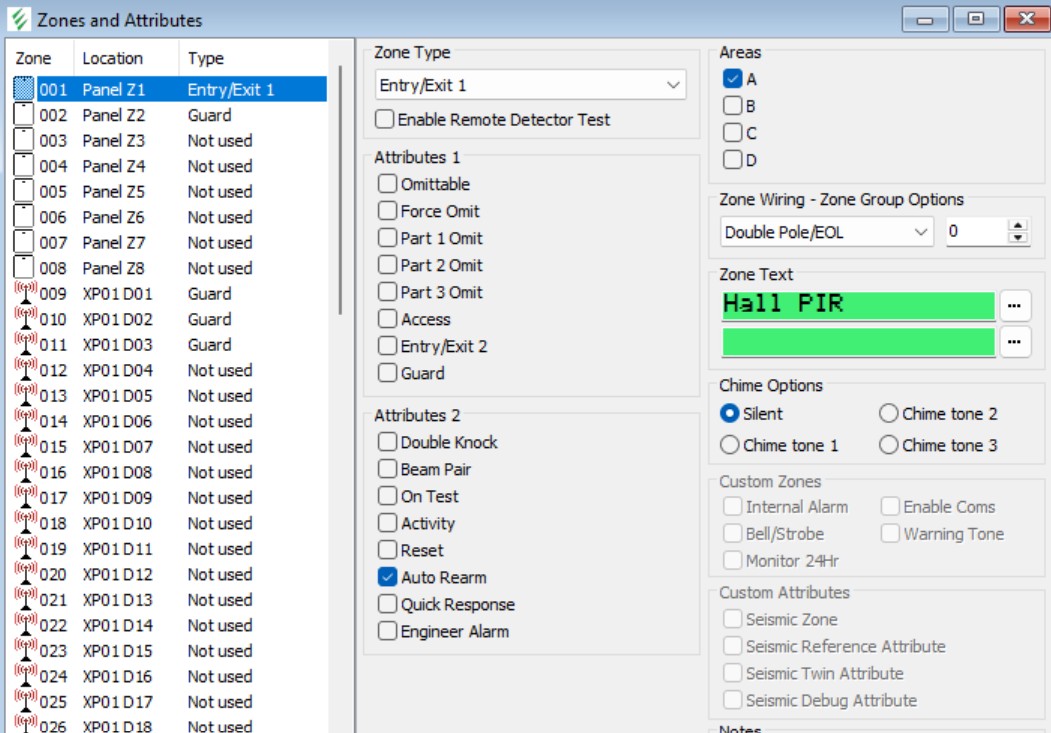

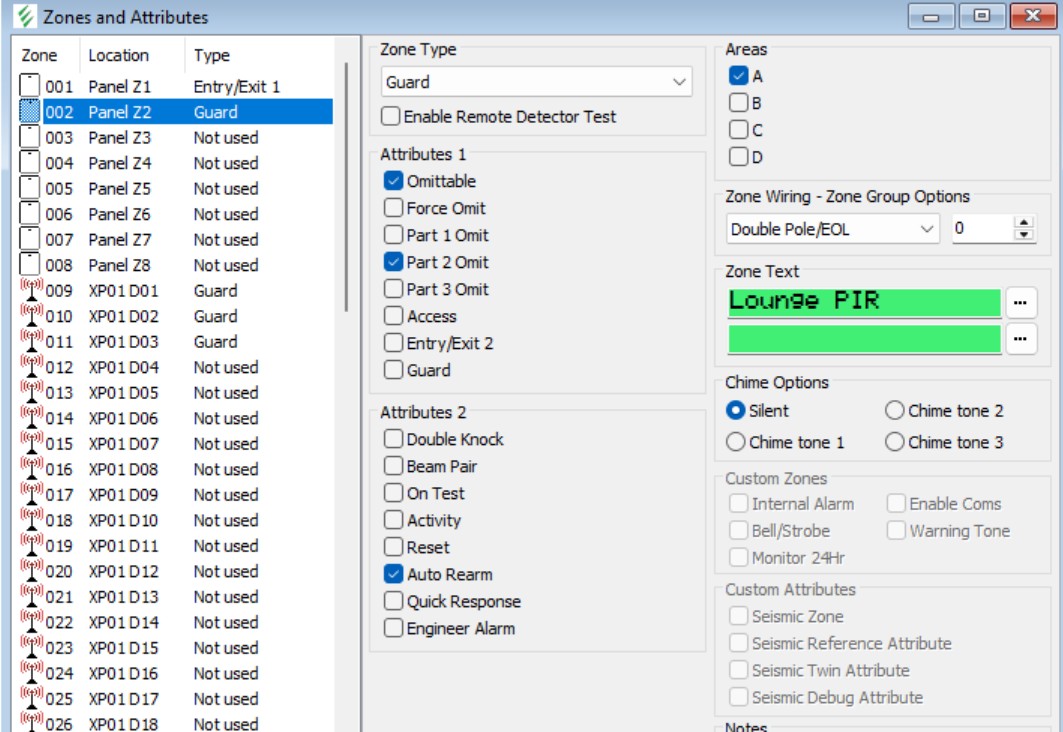

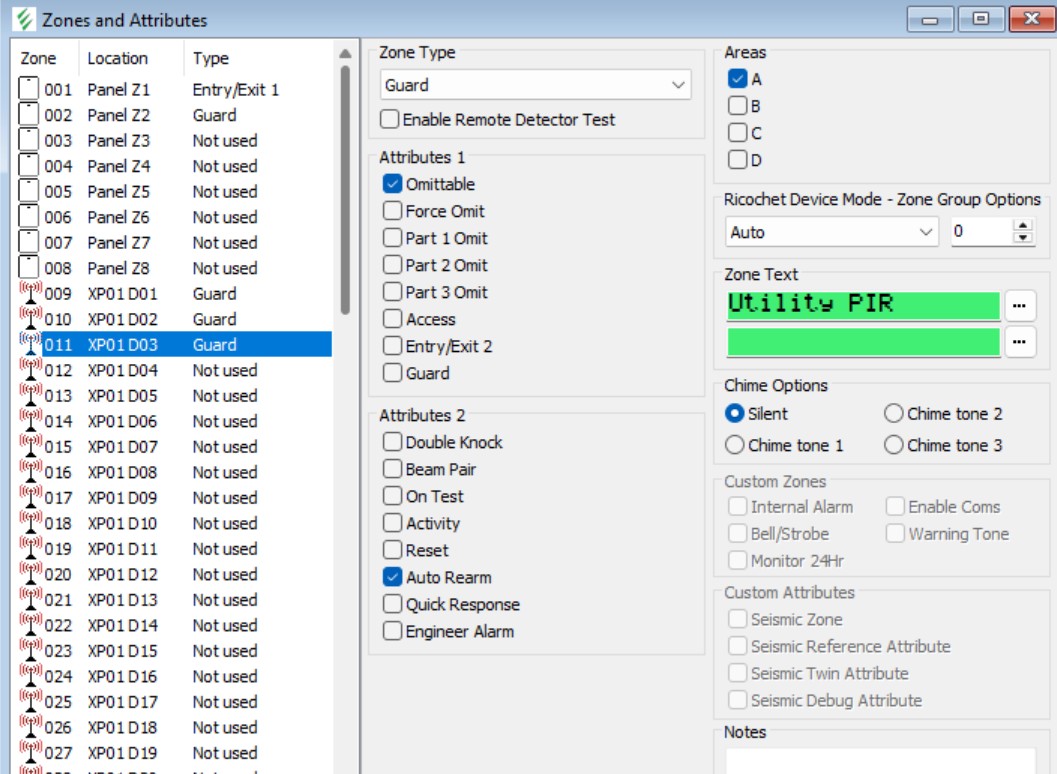

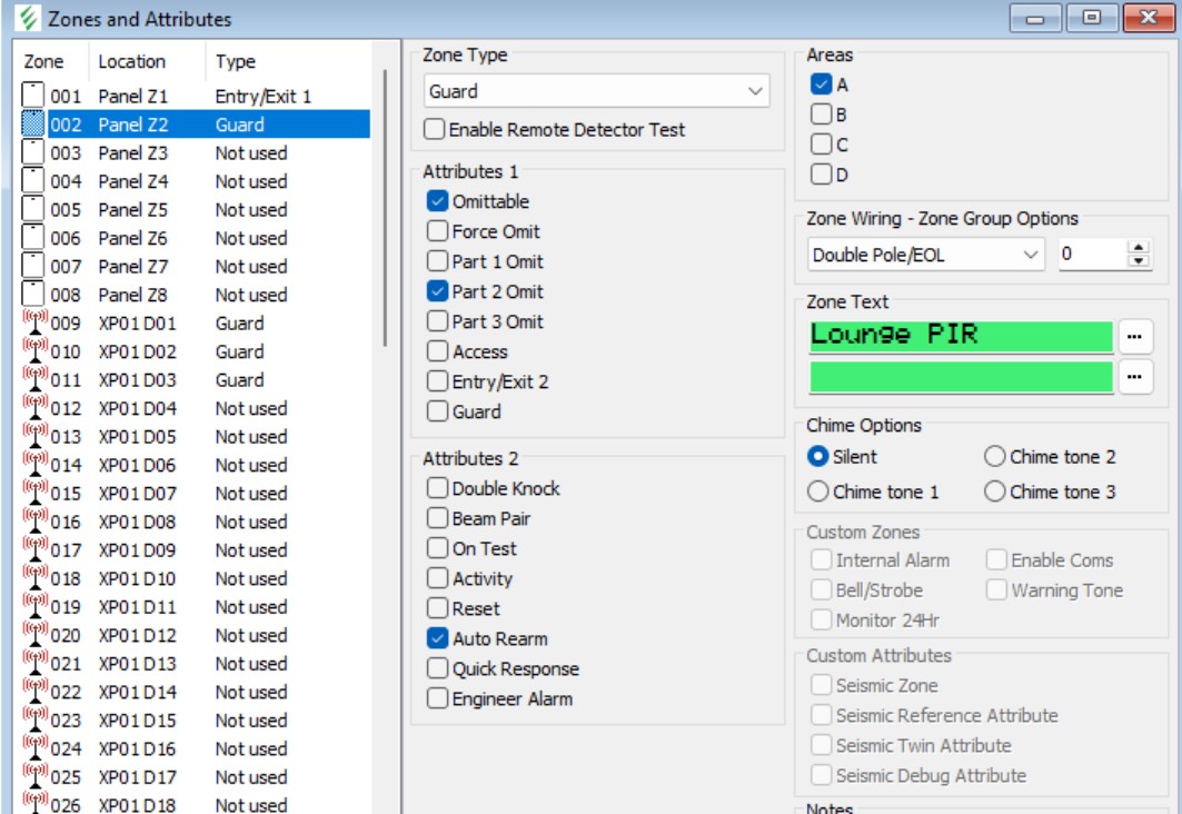

I have a Texecom Premier Elite 64 Wireless system.

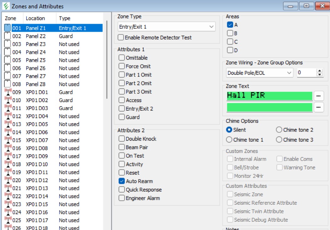

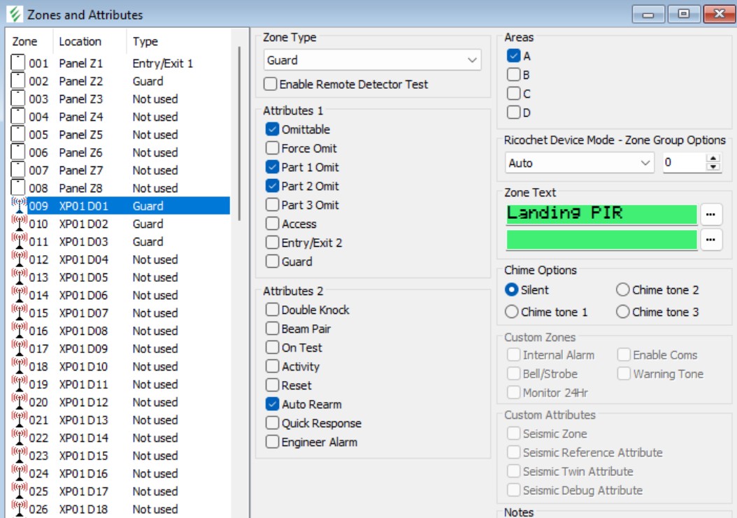

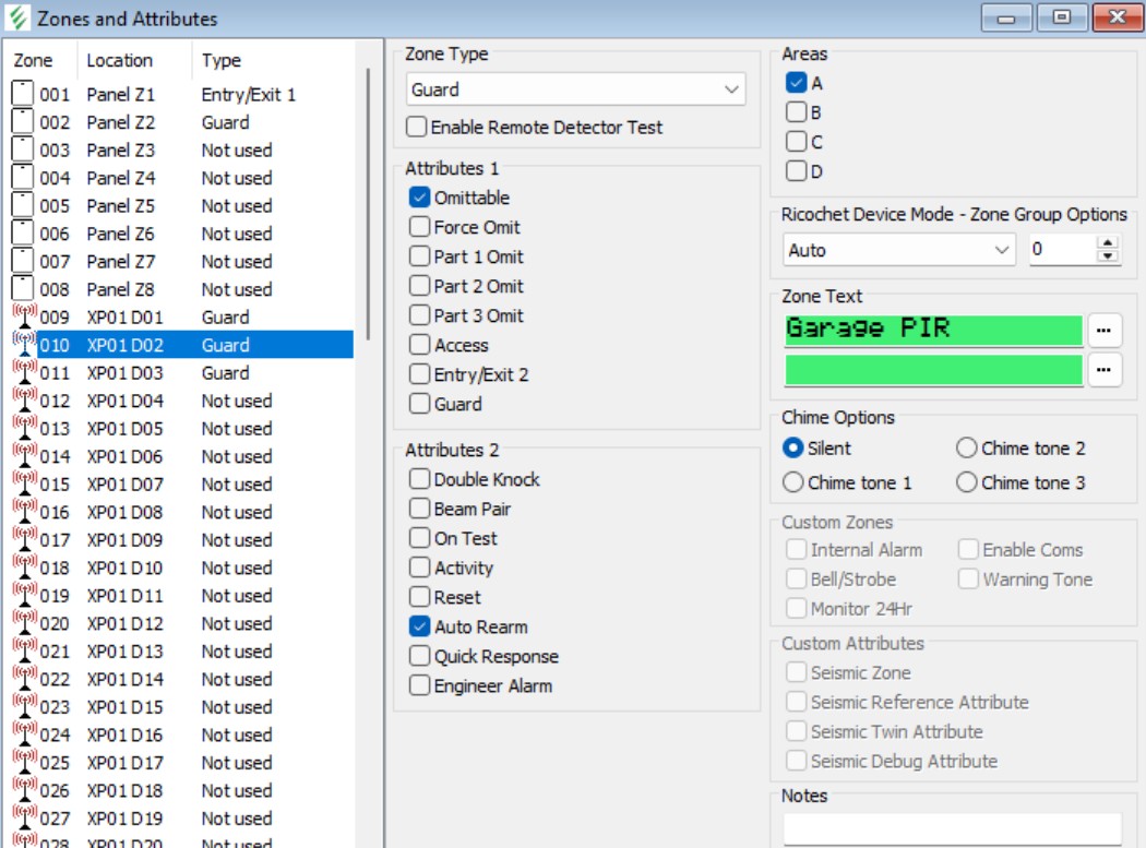

All was working fine until I installed a new PIR into the utility room. It's on the system and configured. However, now when I part arm the garage the alarm is triggered when I walk by either the hall or utility PIR's.
I'm not sure if I deselected something when I uploaded to the panel. Should the garage have part 1 and part 2 omit selected?

Assuming the garage is part arm 2 you will need to select part arm 2 omit for all the zones u dont want included in the part arm
I’ve restored the backup i took before installing the utility PIR and the settings are identical to the attached photos. So i can either revert back to the installation by restoring the panel prior to installing the new PIR or figure out whats gone wrong.
I set the utility room to part 2 omit. Set the garage to part arm and the alarm is still being triggered when i walk by the hall pir which is the entry exit.
Normally if the keypad is in the hallway, the hallway PIR is set to guard access so entry tones start if it’s passed, but depends on your layout.
The PIR is in the hallway and set for a timed exit. Entry/exit1, 60 seconds with a change in tone around 15 seconds before arming its self.
Its works well allowing time to exit, and entry i think is set to 45 seconds.
