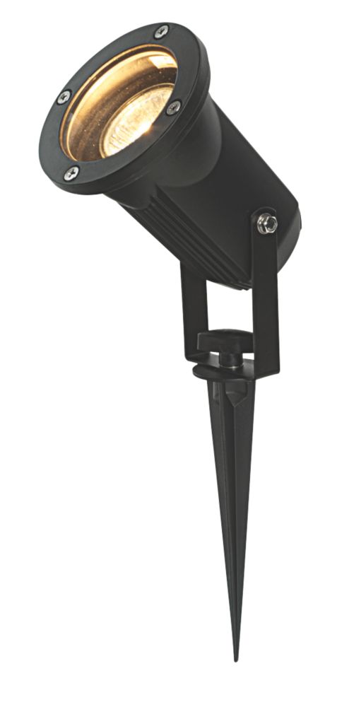

Starting from the tree:
ae235

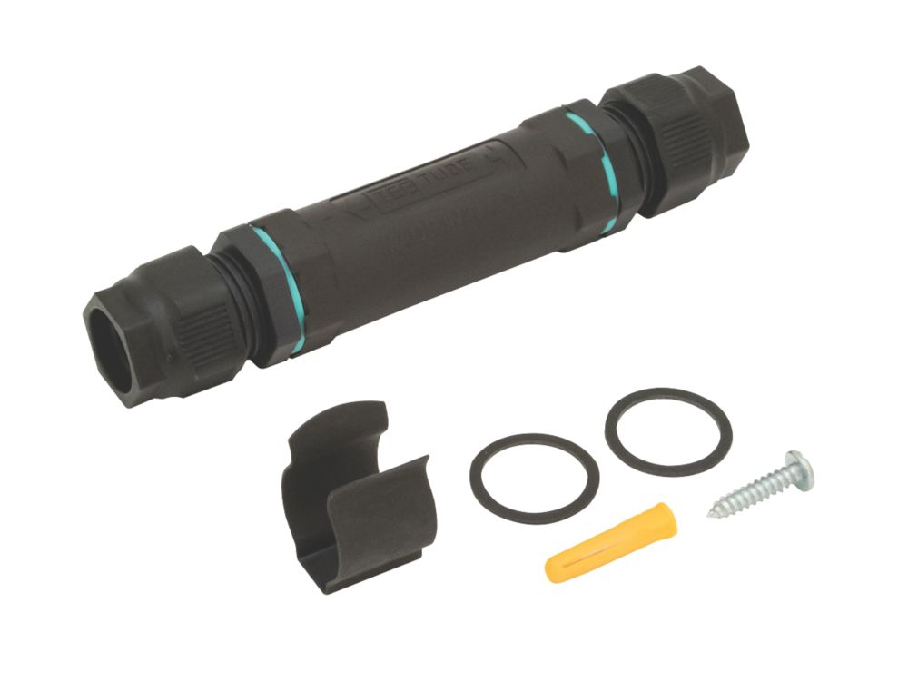

into this
ae235

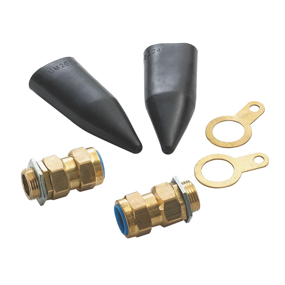

into SWA cable,
into this:

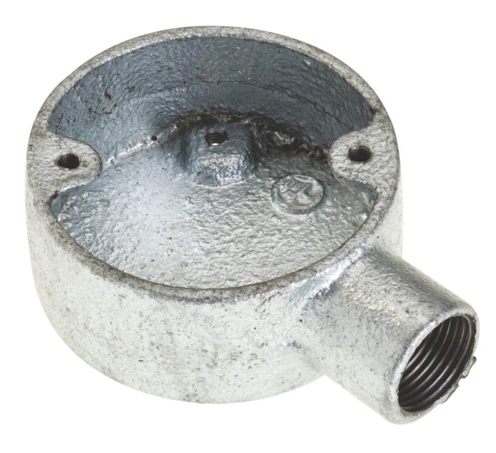

ae235
and finally into this:
ae235
Is that able to accept the size your SWA cable is?
Yes, a 20mm SWA gland will screw into one of those, so the cores from it go into the box. And then......? What do they connect to? Where does what they connect to come from, how do they get into the box, and what connectors will you use?
How will you waterproof it?
