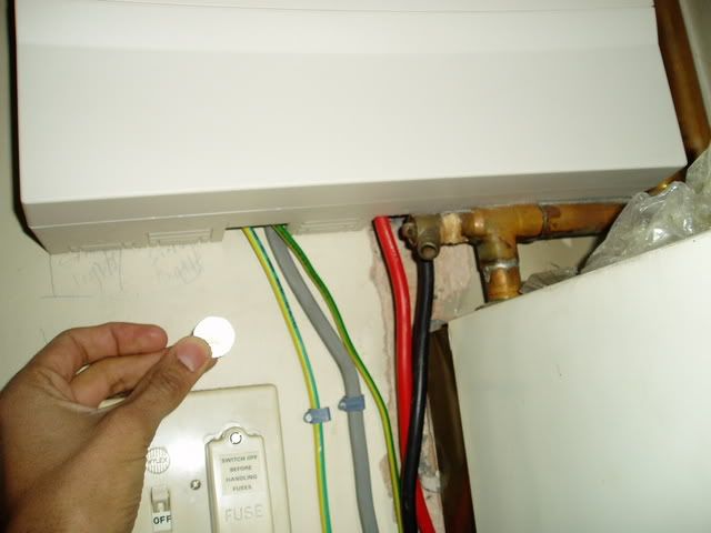

Hi,
I am new to this forum and have tried searching threads for answers but can't find any for my questions. I hope someone can help.
Had work carried out as kitchen fitters would not fit kitchen until electrics had been done. Had quotes and got guy who was NICEIC certified so could self cert Part P (checked on website).
Work done but kitchen fitter's electrician came out and gave list of items unhappy with. I have posted those which are causing me uncertainty and his responses as I know very little about electrics. Is he right?
1.Consumer unit positioned upside down (MK) - response -"not illegal - tight space in position over boiler so best solution without too much work)
2.Main supply should be double insulated brown and blue not old red and black - response - "old are OK. Have put warning sign to state 2 systems used. I did not ask him for a rewire of house"
3. No RCD for kitchen - response - "TNT earthing used in area ???? Not compatible??" When questioned further - " No required unless plugging in externally"
He is coming back in a couple of days and I want to have the right info so I know if he is telling truth.
Thanks in advance

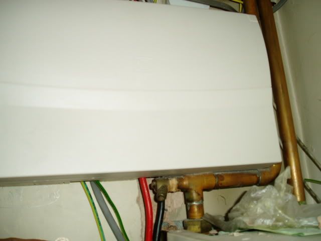

Can you take a photo and post here?
Sure Lectrician.
Give me 10 and I will get them for you. Take of unit, tails and bonding.
Thanks again
unsure how to use BB tags for images. Will try uploading to other server and then add link
Thanks RF,
OK 2 pictures: one of CU and one of tails and bonding. Earth on left is earthing conductor and on right (middle of picture is bonding to gas)
by the way that's a 1 penny coin! Don't know if it helps to give you guys a sense of scale. :)
well the tails and main earth are undersized for a start, not to mention the effects of heat from the boiler on the CU.
Oh and its upside down ;) . I cant see any reason what so ever for needing to do this. It's not like the box won't fit the right way up :rolleyes:
Oh, and that looks more like a 20p you're holding lol
What does the 1 way wylex CU do? (the one in the bottom left of the pic)
Can you show us a wider pic including the cutout / meter etc, and one with the cover lid (hinged bit) open? (one with the cover off would be ace, but let us knw if you think we could talk you through this)
