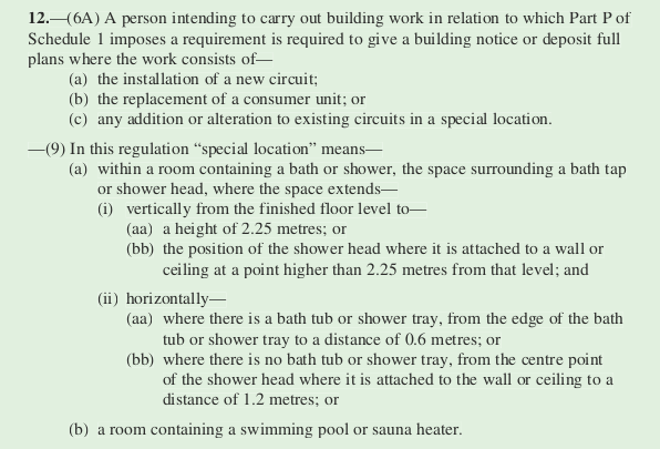

Thanks for all your replies, I need to go through them. The work is spot lights in a bathroom, and moving a shaver socket. The first spot light will use the existing light fitting, with two more feeding off the same circuit. I believe the shaver socket also comes off the main light fitting.
That may come under notifiable work, depending upon the precise locations within the bathroom:
But unless you really want to throw away anything from £100 to £400, don't worry about it. Just get your electrician friend to give you his BS7671 certificate and keep it on file with your house papers.

According to Schedule 3, the installation of a heat producing appliance does not require notification if the homeowner is a person, or an employee of a person, who is a member of a class of persons approved in accordance with regulation 3 of the Gas Safety (Installation and Use) Regulations 1998(
The installation of heating or hot water system connected to a heat-producing gas appliance, or associated controls does not require notification if the homeowner is a person registered by Ascertiva Group Limited, Association of Plumbing and Heating Contractors (Certification) Limited, Benchmark Certification Limited, Building Engineering Services Competence Accreditation Limited, Capita Gas Registration and Ancillary Services Limited, ECA Certification Limited, HETAS Limited, NAPIT Registration Limited, Oil Firing Technical Association Limited or Stroma Certification Limited in respect of that type of work.
And so on. Of particular relevance to this forum, the installation of fixed low or extra-low voltage electrical installations is exempt from notification if the homeowner is a person registered by Ascertiva Group Limited, Benchmark Certification Limited, British Standards Institution, Building Engineering Services Competence Accreditation Limited, ECA Certification Limited or NAPIT Registration Limited in respect of that type of work.
