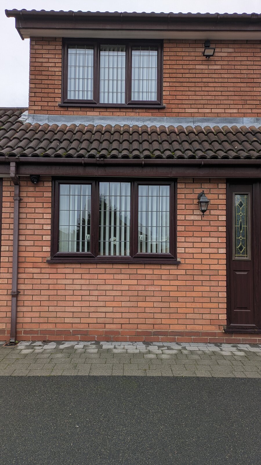

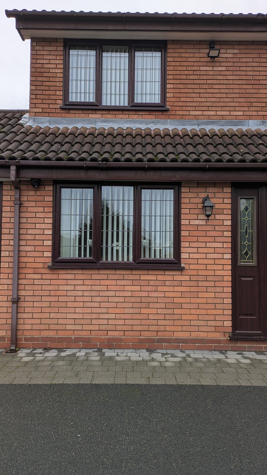

We have a part sloping tiled roof at the front of the house covering about a quarter of the downstairs dining room, hallway and garage.

Is it a sloping ceiling or a flat ceiling?
Do you mean a tiled skirt and the rest is flat roof?
There maybe a complication with the tiled section being a cold roof and the rest not, hard to say really.

Thanks, it's flat inside dining room.
View attachment 366678Thanks, it's flat inside dining room.
If they are Marley 'Bold Roll' tiles, then tread carefully as they haven't been manufactured for years. Your other headache will be adding roof vents to the roof, should you deal with it from the inside. If you decide to strip the outside, you can use breathable membrane, along with some OFV's etc.

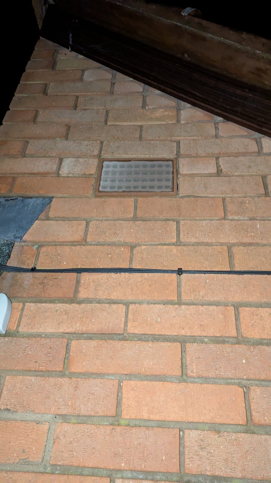

Is that just loft type insulation I need, and will those side vents in the photo be sufficient?
You’ve effectively got a vented loft space there, so you need to insulate at ceiling level and leave the bit above to the rafters unrestricted for ventilation.
I think you might struggle to get 200mm over the ceiling joists and stay below the vent though.

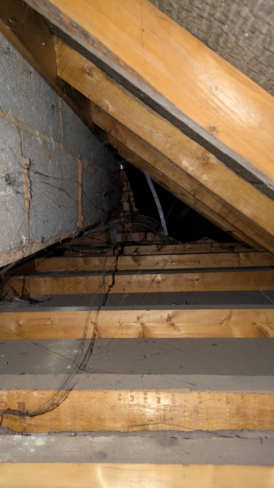

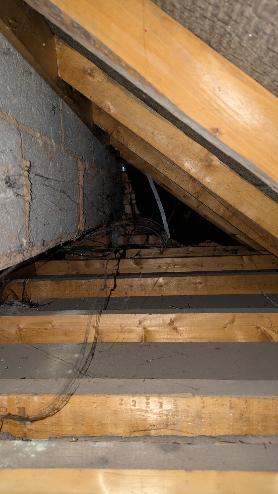

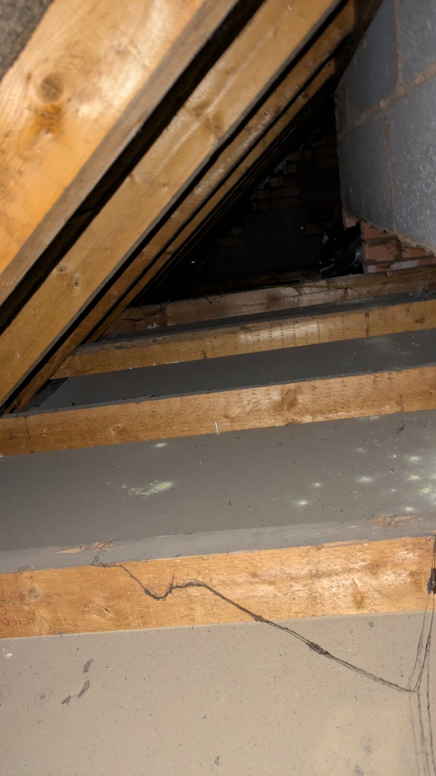

Quick update...
Cut dining room ceiling and can now access above both the dining room and the hall which is a bonus.
No insulation whatsoever, no wonder it was cold at that side of rooms.
Should be reasonable to get insulation in.
The ceiling repair afterwards could be tricky as it's a stippled effect.
