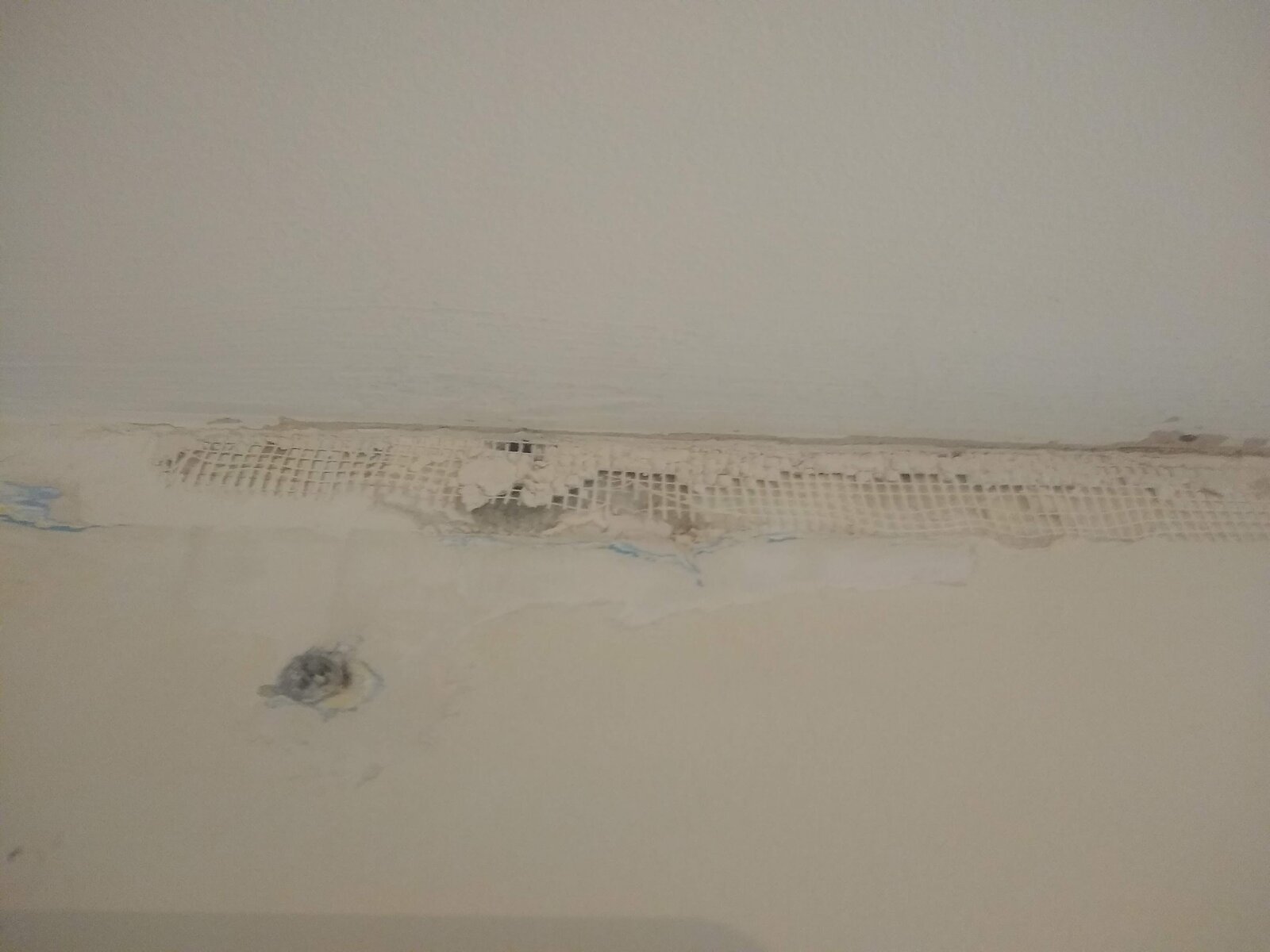

I've got an issue with joint between ceiling and wall that is partially failing. It looks like it has been taped with fibreglass mesh, then the ceiling has been fully skimmed whereas the wall seems to be finished with some kind of jointing compound.
The wall side of this joint is failing in a few places - the jointing compound is blown / flaking. I've scraped the loose away, there is some compound left on the boards but the scrim has unstuck. The ceiling plaster is sound.
What's the best course of action here? Just re-embed the tape with easifill and then 2nd coat finish?

80s house, walls and ceiling are both plasterboarded. The ceiling is sound and intact.
The white surface at the top is the ceiling, the scrim is exposed at the top of the wall as I've scraped away the flaking filler/joint compound.
is there a wooden "beam" wallplate at the top of the wall behind the scrim and patching?
Yes. The walls are plasterboard over wooden studs. I intend to add a couple of extra screws thru the wall boards in case the failure was a result of movement in the wall boards.
its cheap rough tape. Does not serve any purpose in that scenario . i’d trim it off and fill and sand any imperfections with toupret. undercoat it and caulk the join in between the ceiling and wall where it’s most likely to hairline crack before painting.

Is there another option to re-tape the entire corner with paper tape? Not sure whether this works over the top of an already plastered/painted ceiling, or whether it is worthwhile.
Cut it out on the ceiling side too? It is set pretty strong, I'd struggle to remove it without damaging the board.
Cheers. I've got plenty of taping to do in the room so may just do this while I'm at it. I've never taped over an existing finished joint before but I'm sure it will be fine.
