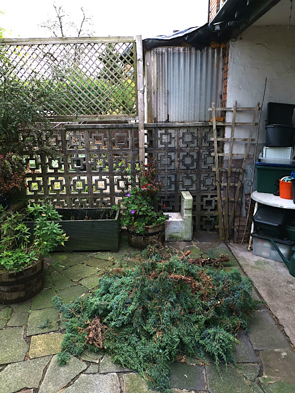

A more interesting aspect is a short length of dividing wall added by this side long ago directly on the property lines. Perforated, patterned concrete blocks with capping stones. It seems doing something about that may be tricky. Some maintenance can only be done on this side, bocked and a section can not be. Removing some might make sense - that's why I initially suggested extending the actual party wall and fixing the messy end you can see for her at the same time.
It's interesting that a couple of capping stones at the far end from the house are missing. I assume they are on her side but how they came off isn't clear. They just need recementing in place. I asked - nothing happened.
Latest addition to her edifice is a tarpaulin on the roof - leaks. An awkward me would cost her £1000's to gain access on my side for maintainance. A legal man reckoned this was good value. ;) Some odd stuff around, garage not fully back to use and skip needed.
