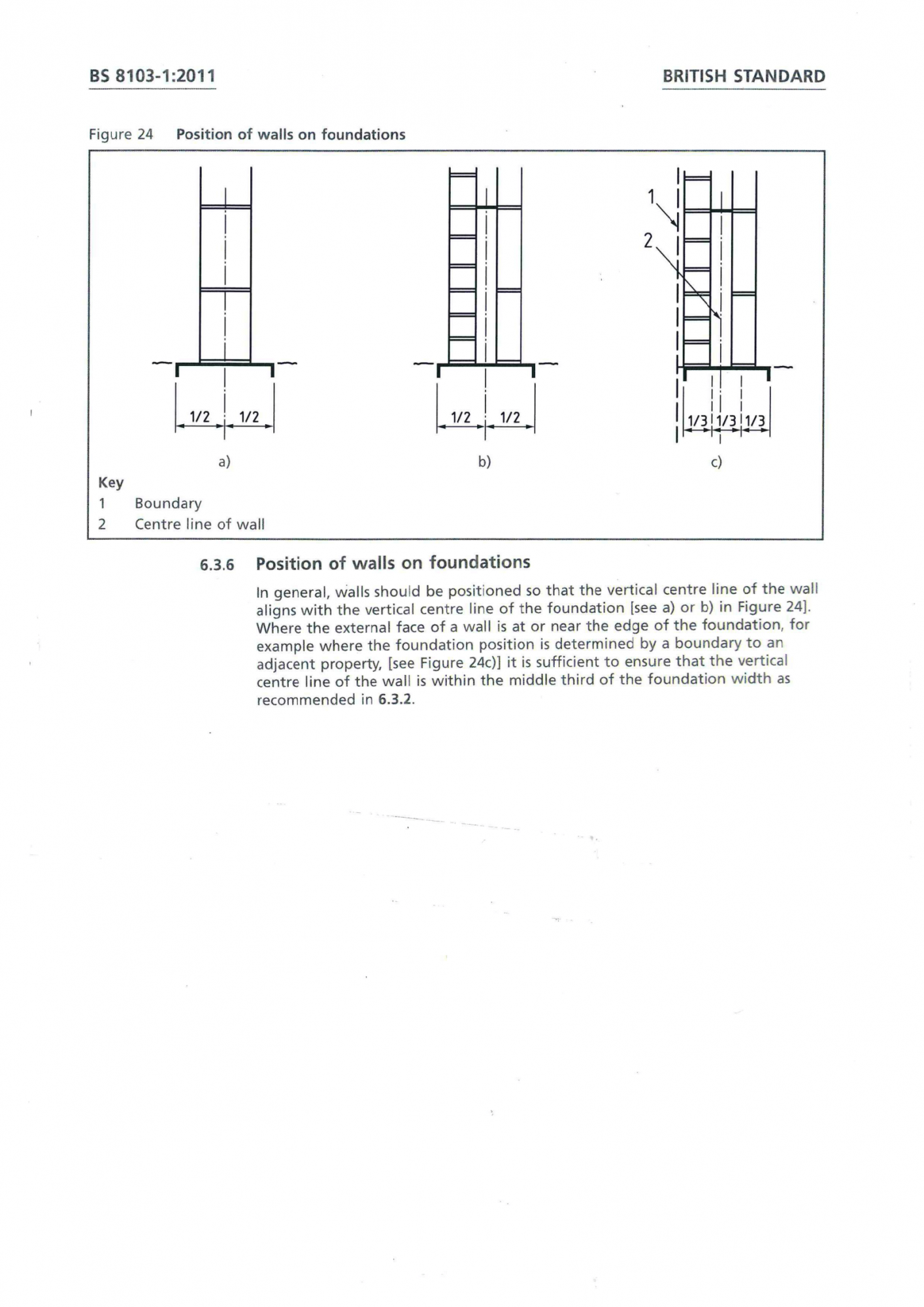

It's irrelevant though really, as for low rise buildings, where necessary - such as on boundaries - it's perfectly acceptable to position the wall right on the edge of the foundation as long as the centre of the wall remains in the middle third of the footing.
But the council will always want proof that this eccentric loading is acceptable.
And then building the thing on the boundary will be difficult without the access rights granted via the Act.
True, but I would expect a BCO regularly dealing with domestic works to know that calculations aren't required as long as Figure 24 of BS 8103-1 is adhered to.
