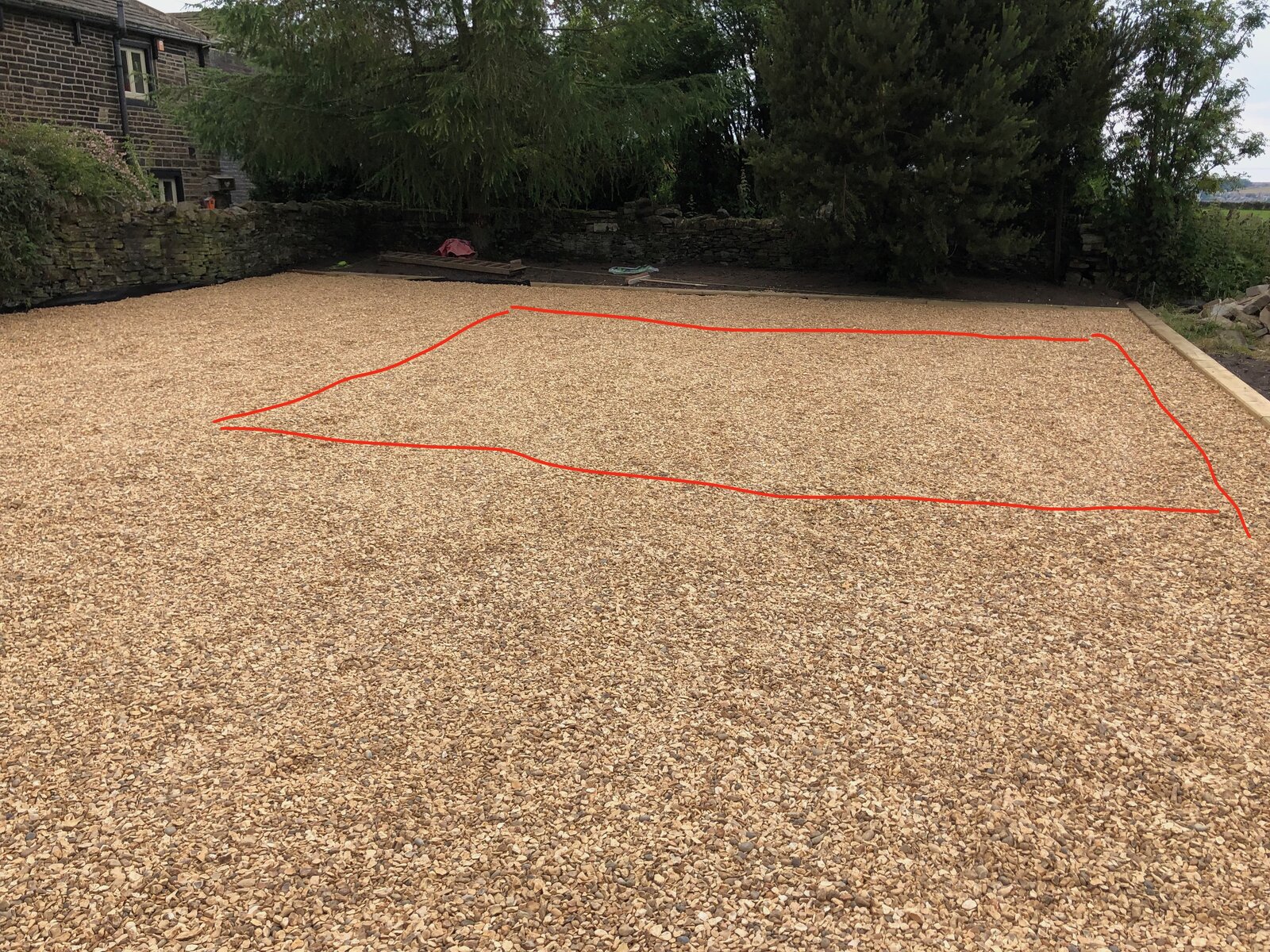

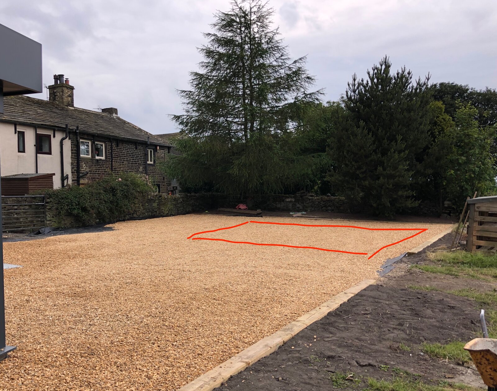

Hello. I have planning permission granted for a 2 bay wooden garage in my garden. I plan to have a concrete slab poured for the foundations. The garage is approx 9 meters from my neighbours house (6 meters from the boundary drystone wall) to the south and 4 meters from a dry stone wall to west which borders a public bridal way.
Im confused as to whether I need a party wall survey or not. All the information seems to refer to adjoining walls etc.

I don't think so, but there is no building beyond the boundary walls it's just all dry stone walls. the wall to the west is adjoining a public bridalway. there are no buildings beyond that, just a fence and a field. to the south you can see the neighbours house shaded grey.
And let's be honest. the dry stone walls wont have much of a foundation if any. the ones ive taken down before are just on mud. so your 45 degrees isnt going to intersect with anything.
Crude photo / footprint of the location.
Cant see how you would require such a survey on your development!
Thanks for the advice guys. appreciate it. I did think it seemed ridicules but thought id check.
