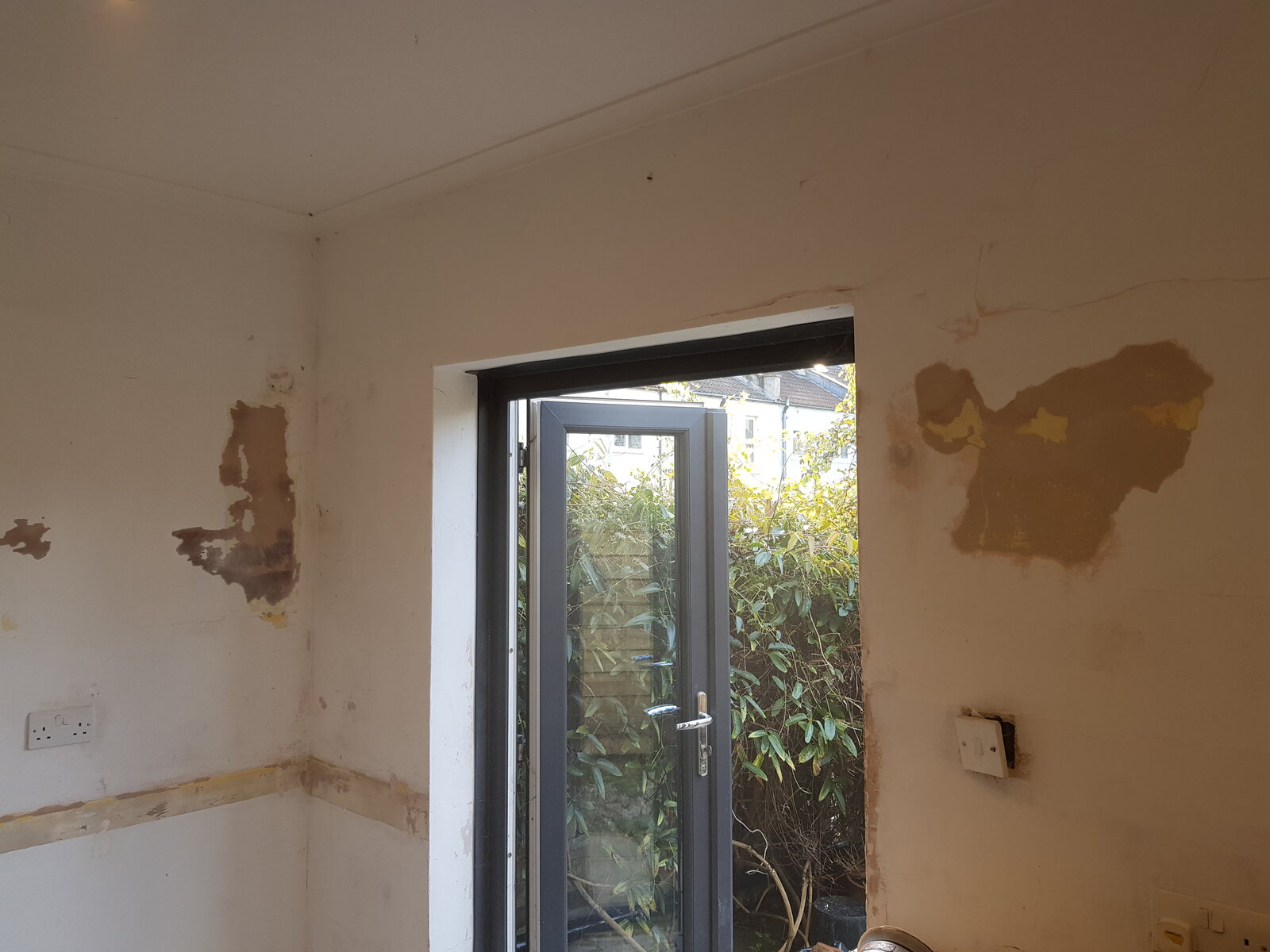

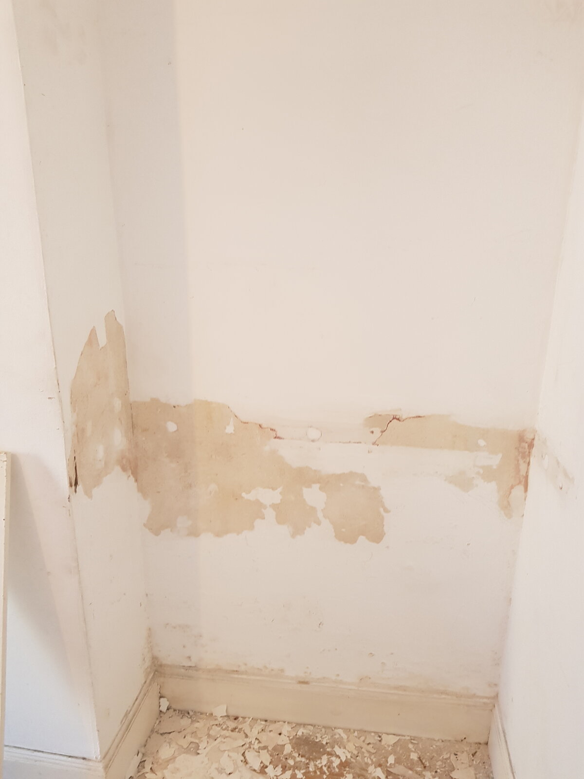

I've ended up scraping back some loose flakey paintwork in my kitchen and lounge.
I'm wondering if I should just sand the edges and paint it, or should I be looking to plaster these patches? The walls aren't exactly perfect everywhere anyway
I have some multifinish, can I just skin a bit on to these patches?
In the kitchen the patches are so shallow, less than a mm. I'm wondering if plastering will create more issues?
In the lounge it's deeper, maybe 1/1.5mm ish
Any advice would be great. This was an unexpected speed bump
Even for such a big patch? What kind of filler would you use for this
I wouldn't use plaster. Plaster can't be sanded as such, so if all of the other existing paint fails, you are left with this massive lump of plaster that you can't do anything with.
You can fill the whole patch, or just the edges, depending on what you feel like doing.
Filling the whole patch is bound to make the surface smoother.
Easi-fill may well be the stuff to use, others may have better ideas.

I use quick drying makegood ready mixed. Bang on best you can. Sands easy. Needs priming if you want to fill over itself. Use thinned pva as sealer following guide on tub. I say ready mixed as no messing about mixing. Sticks well. Easy sand. Can just pop lid and get on with it after quick mix (wooden spoon in drill)

I can't find that on screw fix, would anything below work for my needs? :
https://www.screwfix.com/c/sealants-adhesives/multi-purpose-fillers/cat850102
Don't laugh. But if you get it on you can use a window squeegee to flatten. They actually sell them much wider though for spray plaster but for the DIY person, one of those shower ones for £1 will do. Flattens off a treat.. Then sand. I've tried the screwfix own ready mix and never got on with it in the big tubs.
