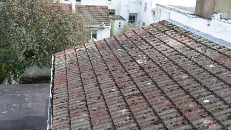

Hi. If a 1st floor patio is done over a fibreglass roof, and it has decking ... does the deck just rest on the fibreglass and bolted to ... in this case it would be a patio 6x3m and the deck could be bolted to 2 walls in an "L" shape ... is that sufficient, or does it need to be bolted through the fibreglass roof or something? Doesn't the deck resting on the fibreglass damage the roof?
And to what is the balustrade attached ? if it's a short balustrade it could be bolted to end walls, but this patio seems a bit big for that, is it sufficient to bolt the balustrade to the deck and side walls ? Is there any way to attach the posts of the balustrade to the wall below on the outside - but what about the guttering?
Thanks for any help.
Pictures. Or plans at least would help. Depends how good the deck is and how well the laminate went down. Gravity only wouldn't be wise (you'll get noise as well as eventual damage from expansion/contraction), fixing through would be best but fix thru to joists not just the deck- long screws would do.
Only got photo right now, there's a tiled roof with attic space. I'm thinking to strip it down put a grp roof on and turn it into a patio. I am thinking about how to fix the decking balustrade so it's solid.
If piers go through the roof to connect with the structure below, how to waterproof them?
I passed by some balconies on the weekend that had the balustrade bolted to the wall below on the outside but don't know how the guttering works then?
Perhaps it would be better to use brick to build up the walls and use a waterproof cement floor with tiles, drainage through holes in the walls ?

Well that's not a flat roof for starters. You'd need vertical upstands through the roof to support your deck, flash them like you'd flash a chimney.
And before you go any further you do realise that the odds of you getting planning permission for this structure are somewhere between slim and none?
