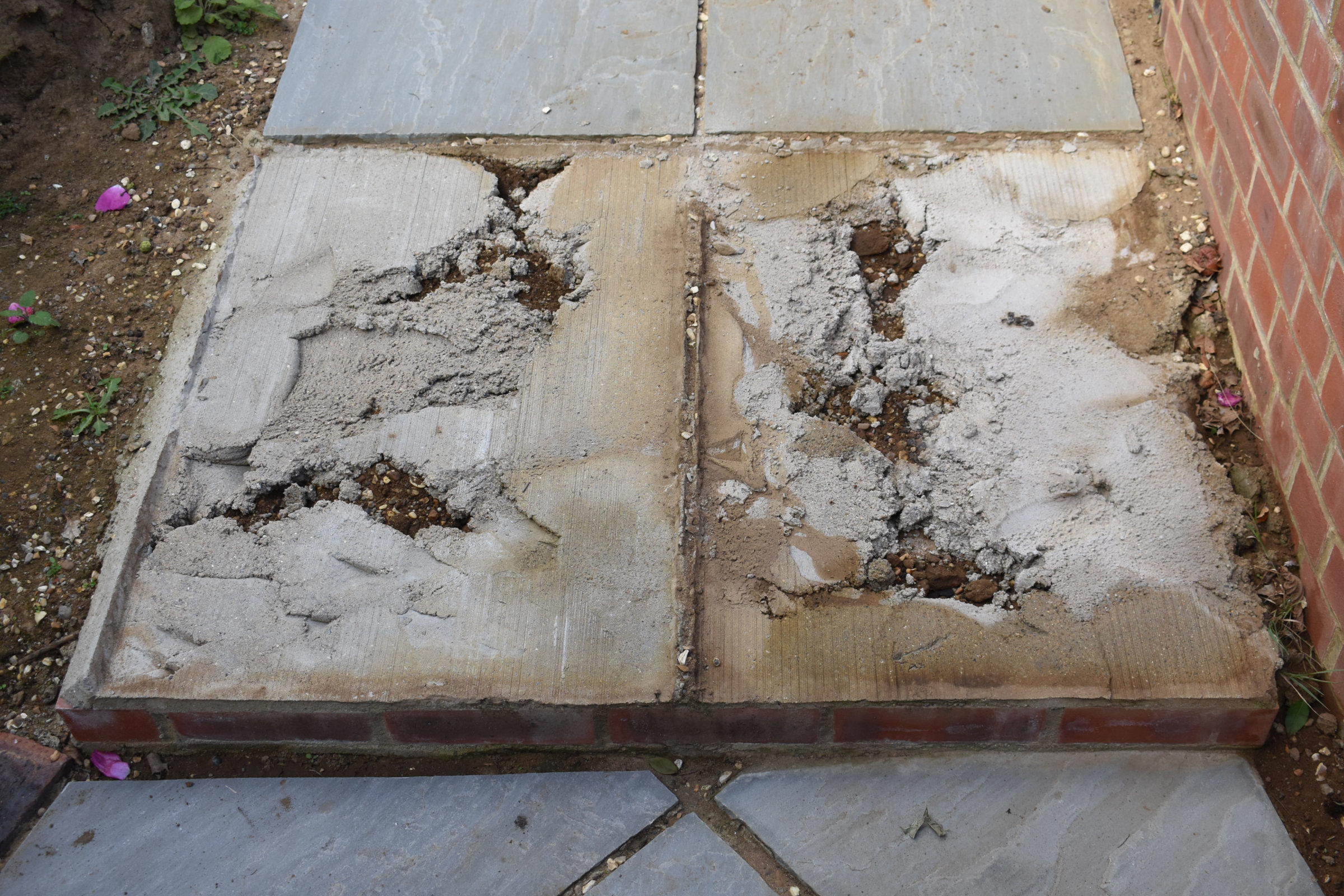

it was laid on a bed of mortar, but it seems quite a weak mix he used, also 5 dabs under each slab, some were only 20% contact!
I am with you in thinking he is a spritual caravan dweller. Joint width varies from 5mm to 30mm in one or two places, and as laid the slab mortar would have given a joint depth of 3-15mm.

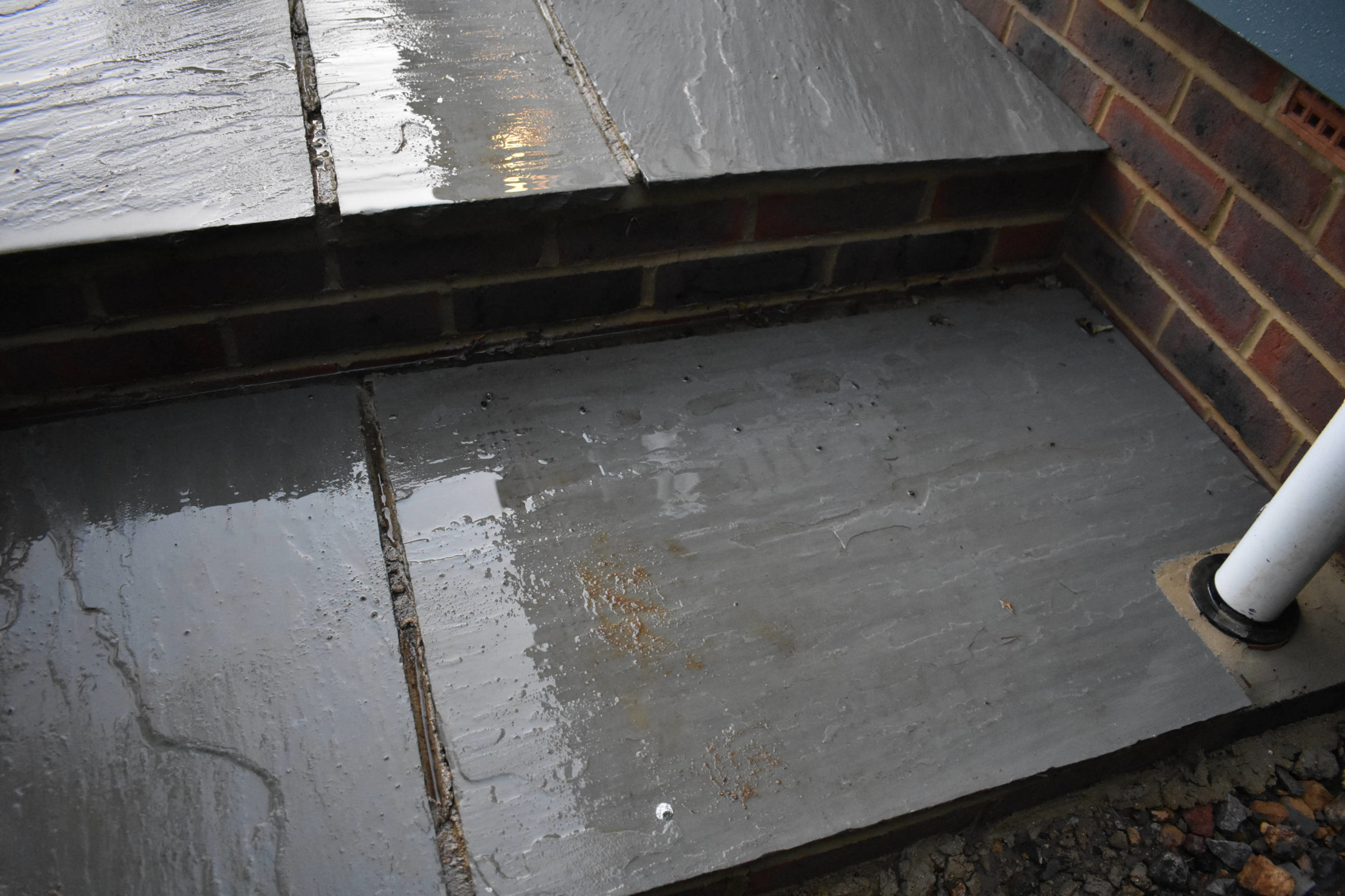

Also gap between slab and house varies from 12mm at one end and down to 0-2mm at the other end, I dont know how I am going to grout the skinny end/

In the last two pics the corner at the back is about 4-5mm lower than the front of the step!
Latest update, I have been cleaning out the grooves between stones to lay sand cement grout, and current total is 10 loose slabs, 6 of which could be lifted with office hardened pinkies and no bolster required, the "gripping" surface, what there was of is was mostly brown where spilt soil had been washed off and under.

If you look there was only adhesion in the smaller dab at the top of the picture, all the rest was making no contact as earth stains are showing across the whole surface.

One of todays discoveries shown above, I think I will contact Trading standards about the landscape person. I will not name him on here yet, but could well do so after any court case is won.
These slabs look like Slate
If they are he should have added PVA to the mix as they dont bond well to just mortar.
