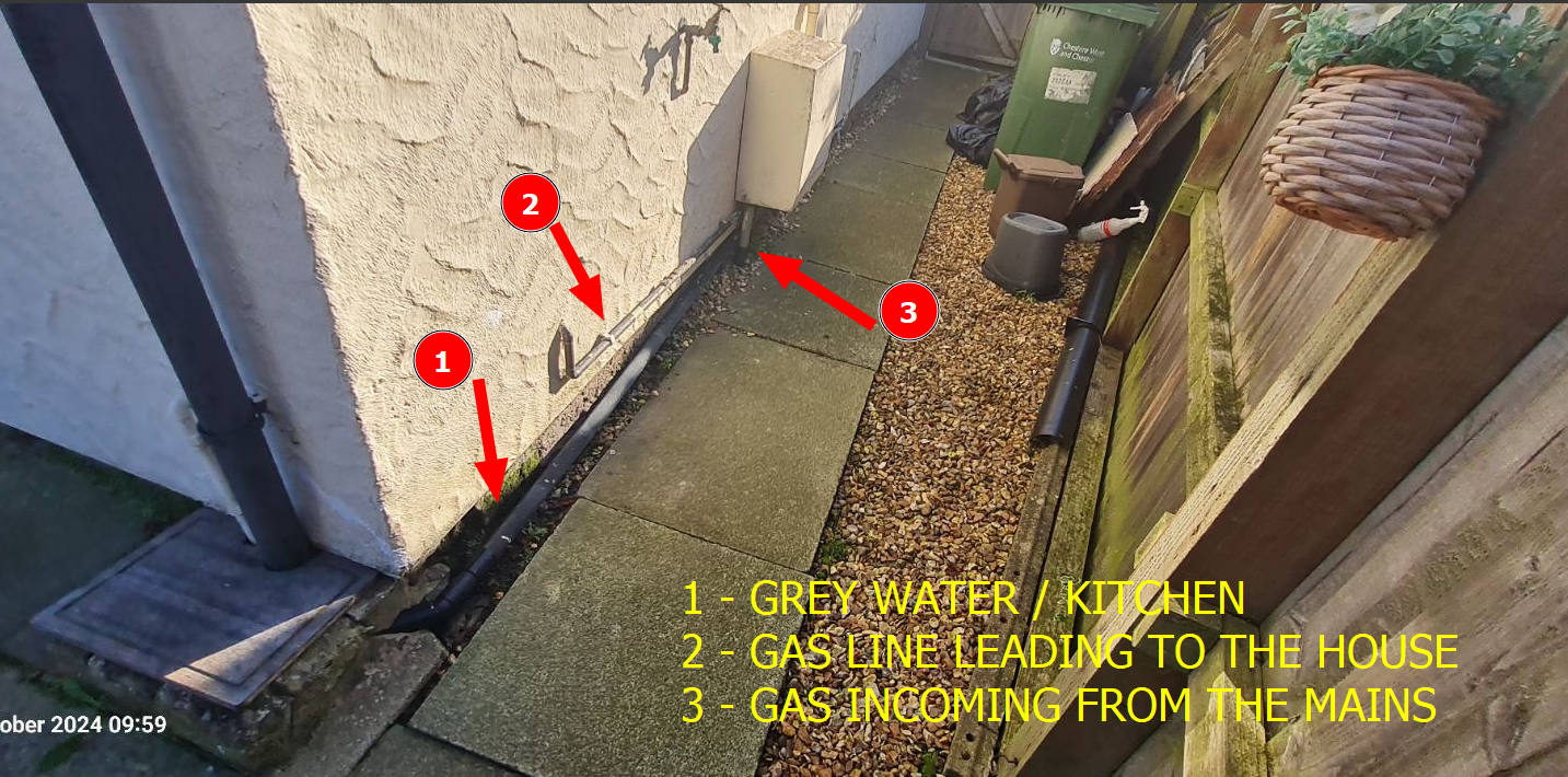

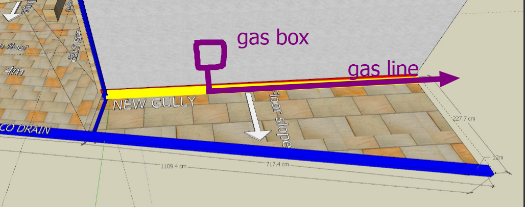

We're moving to re-do our garden next week, and I am wondering what to do. The current state of the garden inherited disaster with mud and old concrete tiles 60x60 - not nice. nice. In the picture below, I have visualized the external wall where the kitchen
The gas box is on that wall, and underground, there's the line, covered with little river stones. Is it okay if I cover that with new porcelain tiles 60x90cm (~30kg per tile) or it's not advisable?

I agree; most are under something, I just wonder if the weight of the tiles won't be much or if, since I will lay screed / mot and tiles, the combined weight might be too much or probably not.
Also, my second concern is if something has to be repaired or replaced, I have to lift up grouted tiles too?

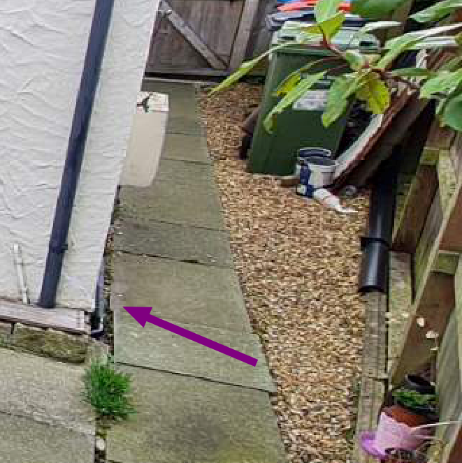

The pipe arrowed purple in the second pic. does not look like a gas supply pipe and I would be suspicious about it running along the surface where it does. It's difficult to tell from your pics but I think I personally would prefer the advice of someone onsite from the gas board before you carry out your plan
The pipe indicated by the purple arrow seems to be going to the gully by the corner…..more likely a condensate pipe or summat.

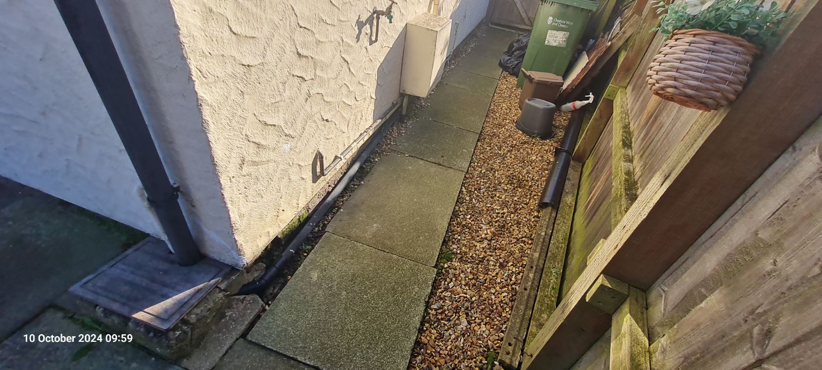

Here is better photo. The grey pipe is grey water I will re-do that pipe into a better gully.

That will be fine unless it needs ripping up to change the pipe or move the meter at some future date. Why not just leave your small row of stones in place at the edge of your new tiles. My set up is similar but the gas pipe runs a couple of feet away from the wall under block paving.
I suspect your is actually under the slabs.

I will find out if this is the case next Monday. I don't want to leave the row of stones as this was one of the problems that caused partial subsidence in addition to the cracked gully that I discovered. My goal is to divert all rain water into ACO drain with reverse slope from the house and then move the water into a gully
so the the only pipe in question is the incoming gas supply which goes down into the ground and heads towards the front of the property
that pipe could be anywhere under the ground in your side passage and probably fairly deep
I personally would slabe the whole side area but leave a strip by the house and put in gravel aside from reducing rain splash it visually keeps the gas cupboard and pipework within the gravel section, so your new paving would have a visually nice clean straight edge
