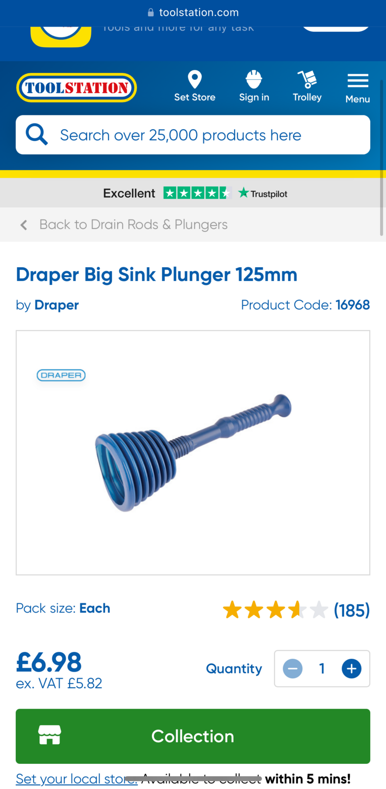

If they aren't stuck down you'll probably be able to lift it out with a couple of these:

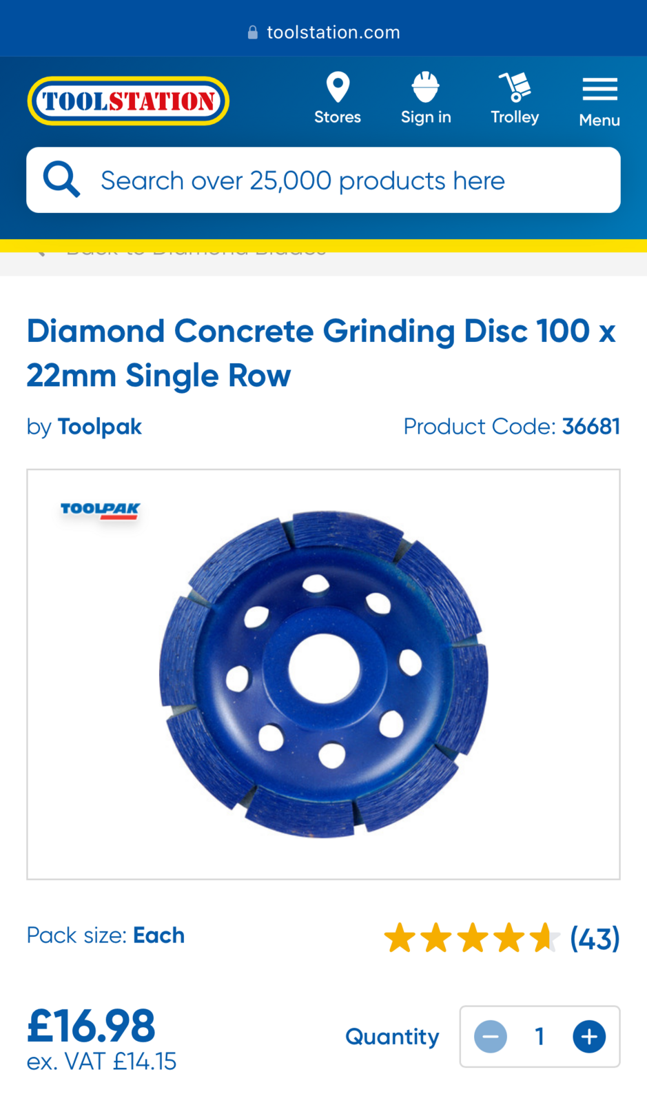

If you're going to grind it, consider:
..and also I recommend to "run it in" by using it to shape some waste stone or concrete first, to get rid of the paint and soften the profile of the corners on the cutting wheel. When they're new the thing being ground can end up a bit notchy. Also good practice

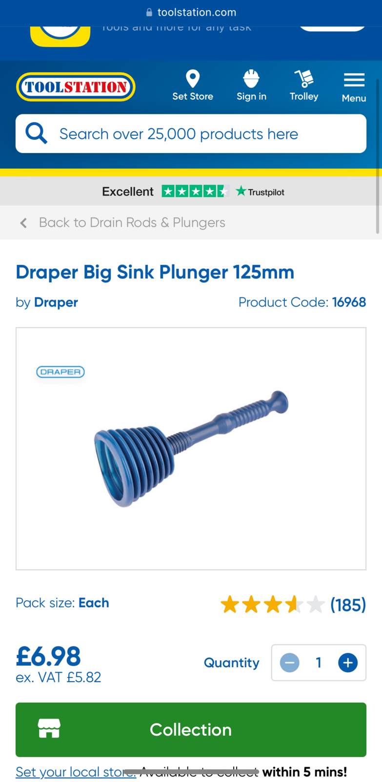

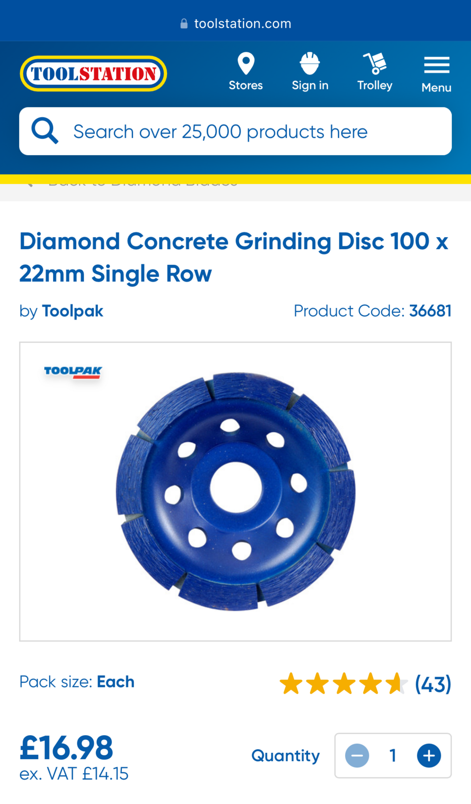

Great - thanks very much! They are all stuck down and grouted in so I'll be trying the grinder - thanks for the advice.
