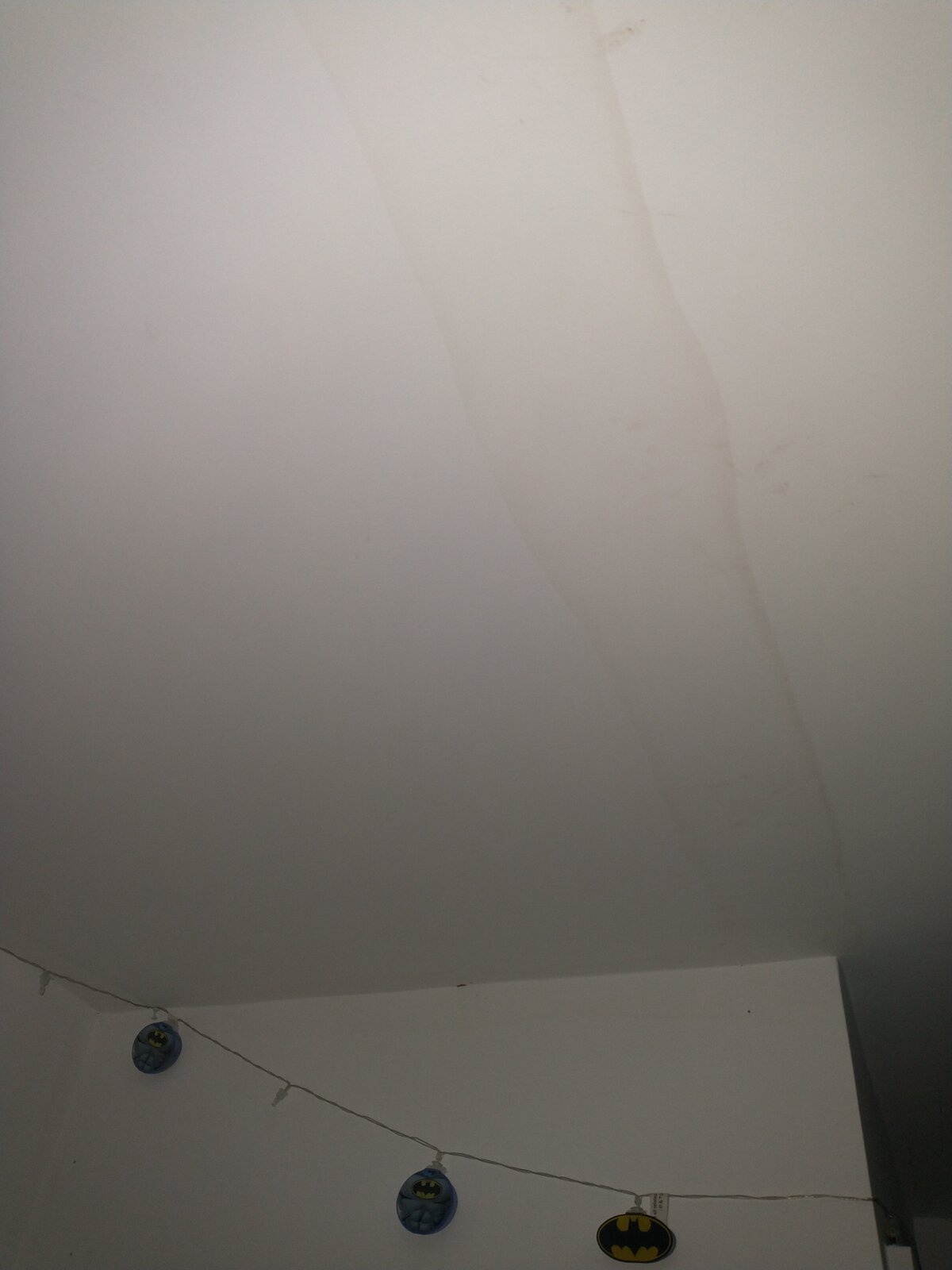

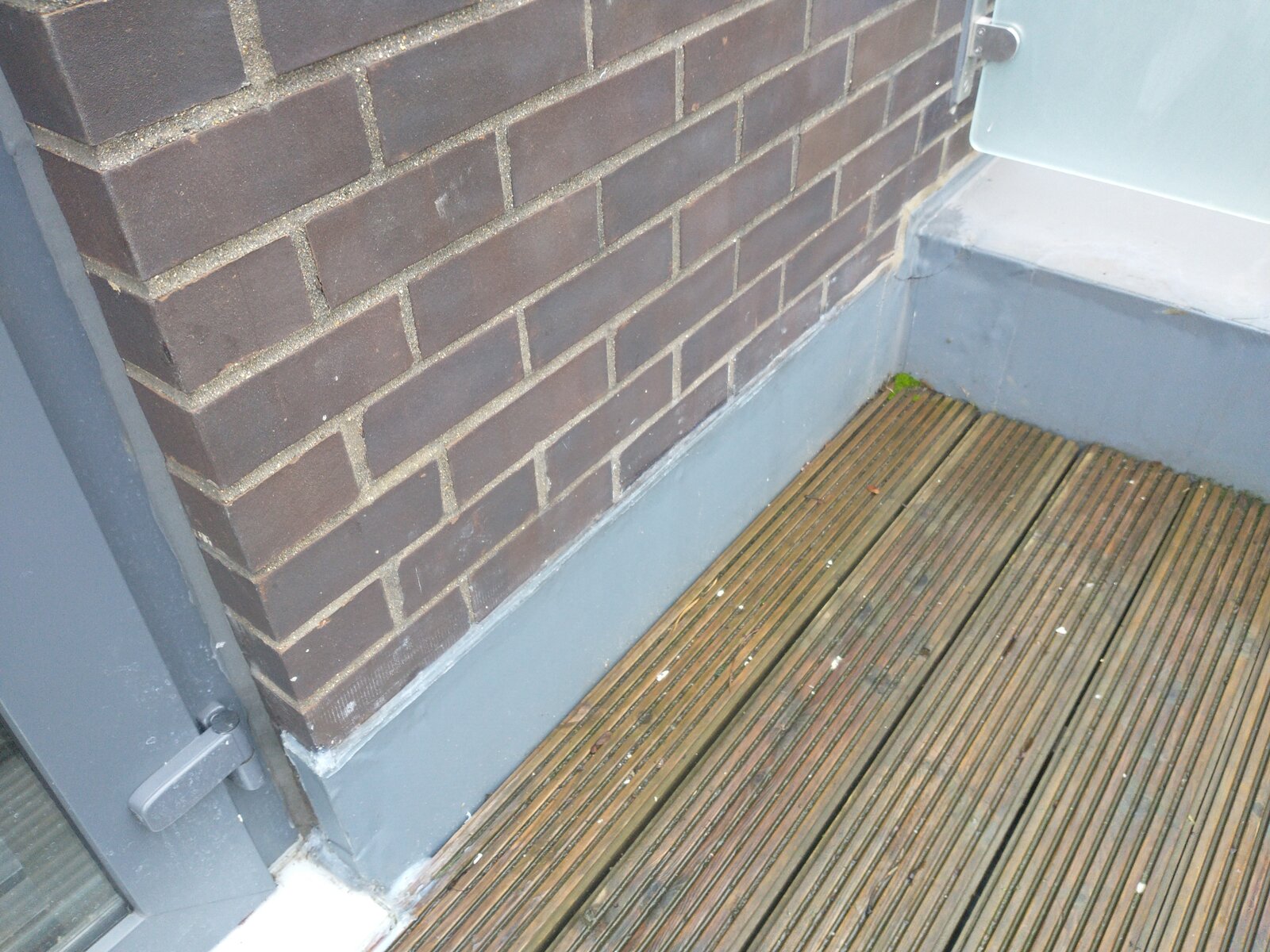

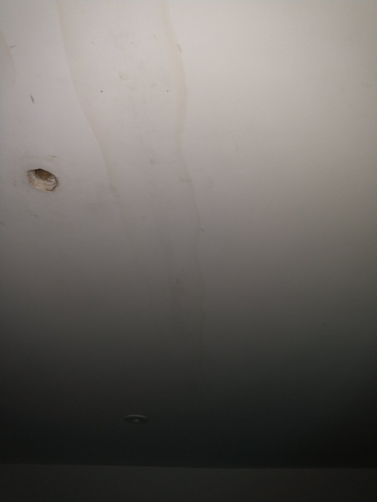

Hey,
Property is 6 years old,( covered by 10 year warranty but need quotes first so I can claim once this is done b)
It's a 3 storey house with a balcony and the wall is supported by 2 rsj beams and a room directly underneath.
I've attached a pic of the wall and room below. It's worth mentioning I know the flashing leaks as I've tested it and water comes directly out of the hole in the ceiling (in the picture) so that definitely needs fixing but it was whether it looks like a combination of just the flashing/rain penetrating the wall or is it clearly evident it's the flashing.
It has happened twice in 4 years, both during storms. Normal rain seems fine.

Simba_ali, good evening. again.
Looks as if there is a definite correlation between the defective area of the Balcony and the water damage internally.
I would "proceed with caution" in that do the Warranty Company require you to use specified repair contractors? I ask because down the line, the warranty company could turn round and say you have voided the conditions of the warranty agreement by not using a specified Company??
If it were me?? I would send images of the internal water damage, even if you can offer them access [difficult with C19] to view directly the damage. and get the warranty company to agree that damage exists, then move on to getting the warranty company to accept your choice of repair contractor, all ahead of commencement of work, why. as above??

Has the roof covering been checked? What about the joint beneath the cill?
Hey,
I did contact the warranty provider who told me to get quotes to fix the issue which is easier said than done.
I have had builders / roofers / carpenters inspect who can't point to any flaw without tearing the area apart which I am hesitant to do because as you pointed out i don't want to void the warranty.
I haven't been able to process the warranty further as covid has slowed the process down and no one can offer a definite solution at this point.
What i can tell you from my own investigations during lockdown is that no amount of rain falling directly on the balcony decking has caused it to leak. Or show up on the ceiling It has only leaked twice which were in the 2 storms this year in February and March which were wind driven rain.
I have managed to make it leak by pouring 3 watering cans directly onto the flashing upstand and it shows on the ceiling in 10 minutes dropping through that hole in the picture. It also looks like the mortar has started to erode from where the rubber flashing is in the brick and there is a little movement when pressing the flashing. I have temporarily covered the joint with sealant.
I know water is penetrating the flashing so I will get that fixed, but I don't know if it's just the flashing or likely to be water penetrating the brick (lack of cavity trays) because I dont know how much water can normally pass through the outer skin. Also no builder has seen this as a problem or they won't willingly acknowledge it. They all say weep holes are only for condensation in this area of the country which I know it absolute rubbish.
If there was no cavity tray then the place would have been leaking since it was built.
If there are replacement doors and balcony/roof covering or flashing then those would be more likely to be an issue.
The Cavity tray situation is strange....the wall has weep holes 4 bricks from the top all the way along and there are weep holes over the balcony door.
There are however no weep holes at the base of the wall near the flashing so they have either forgot to put cavity trays here or they have put them in but with no weep holes.
So in theory the upper half of the wall is protected from penetrating damp just not the bottom half.
I also purchased an inspection cam which allows me to look into the roof space where the hole in the ceiling is when it's heavy rain and I never see any water. I can't quite look up th cavity though to check for a cavity tray...
