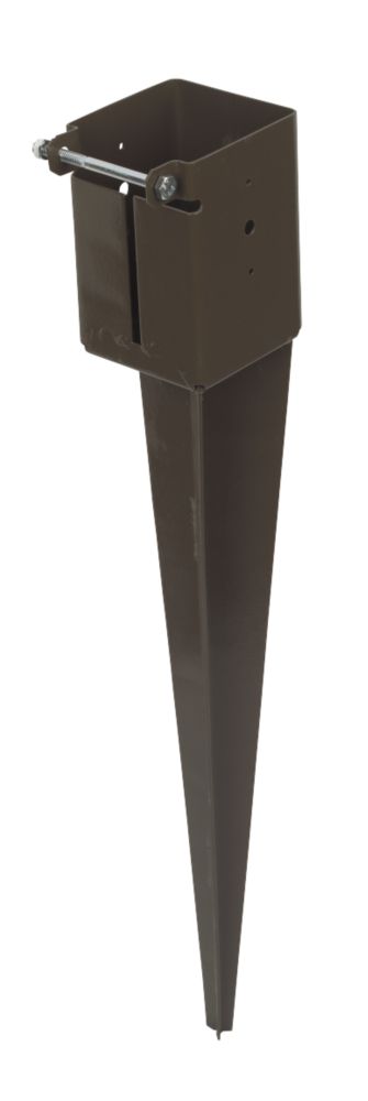

If it is grass/soil on the lower side you could use a 'MET' post sunk into the ground to give extra length to the support post.
You can dig the hole, fit your post in to the support, put the support into the hole and after aligning it vertically pour your concrete in.
This should give you the height you need above and the support you need below.
Hi. You mean treat the Met post thing as if it was part of the post and bury it along with the bottom part of the post? Interesting idea. I'd be worried about the post/metpost join flexing. How deep would the join need to be to make it secure? Anyone any idea?

You can hire hole borers instead of 'digging' a deep hole. Something like this but you can also get manual ones which you turn by hand.
For the depth you need to work out how much you want projecting above the soil, subtract this from the full post length. The result is how deep the hole needs to be plus a few inches to put some drainage stones/pebbles at the bottom. If you are using a MET post you will also need to add the length of the post on to the hole depth. The concrete doesn't need to come to the top of the soil level but if it does you can slope the top of it and then cover with decorative shingle. The wide the base of the concrete the less likely it is to 'wobble', so a base/boot 300mm (3 post thickness) is better than one 800mm wide, (2 post thickness. Obviously the deeper you can sink the posts the stronger they will resist movement.

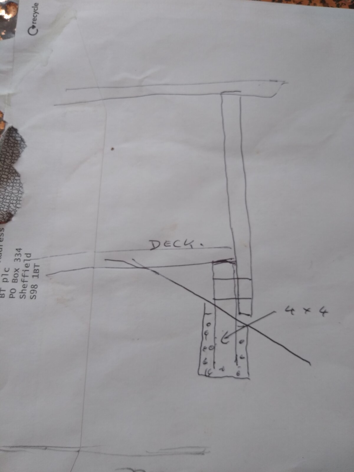

Another way
Ok, LitL (hope you don't mind the abbreviation). That's interesting, I interpret that as a short piece of 4x4 in a hole to the normal depth, filled with concrete, and another post screwed/bolted to the first one, going to the height required. I suppose the join could also be encased in concrete as well?
It's a bit like Conny's Met post extension. Would joining the posts be secure? I'd be kinda worried about the join opening up and the top post moving.

If you don't want to, or can't use the right length posts then you have to make the best of what's readily available whether that's met sockets or fixing to short posts.
Pointless piling concrete around the joint
Forget the MET post extensions use 'Repair Spurs' (concrete soldiers) instead. Bolt the posts to the soldiers once the concrete has cured. That is why LITL is trying to illustrate in post #9. A
A much longer lasting job as the posts are simple to replace when (not if) they rot.

DiverFred, thanks. Your suggestion is similar to LinL, except using concrete rather than wood post. A good suggestion, I'm going to look for those things,check price etc.
My son has looked at the hole again. He calculates that the bottom of a 60cm hole would be about 100cm below the deck level. A 3m post would only be 2m above the deck, and the beams etc even lower. We can't lower the deck height because it's adjacent to a patio and path so we have to come up with a way of having longer posts.
He thought about using UC4 structural timber. Two 100x47mm lengths screwed together maybe with a small spacer between them to stop water being trapped. That would be about the same size as 4x4 post and are available in long lengths - 3.6m and longer. The cost is about the same as the posts. We could even use 125x47 for a bit more strength. What does anyone think about that?
The weakness in these solutions are the joins. The metpost idea would have the join incased in concrete, the two 4x4s possibly also. Fred's idea has the join in open air, but uses the soldiers in a way very similar to their design use, though I wonder about play where the posts are bolted through. Structural timber has the wood screwed/bolted together in several places but I wonder if the screws would be strong enough.
