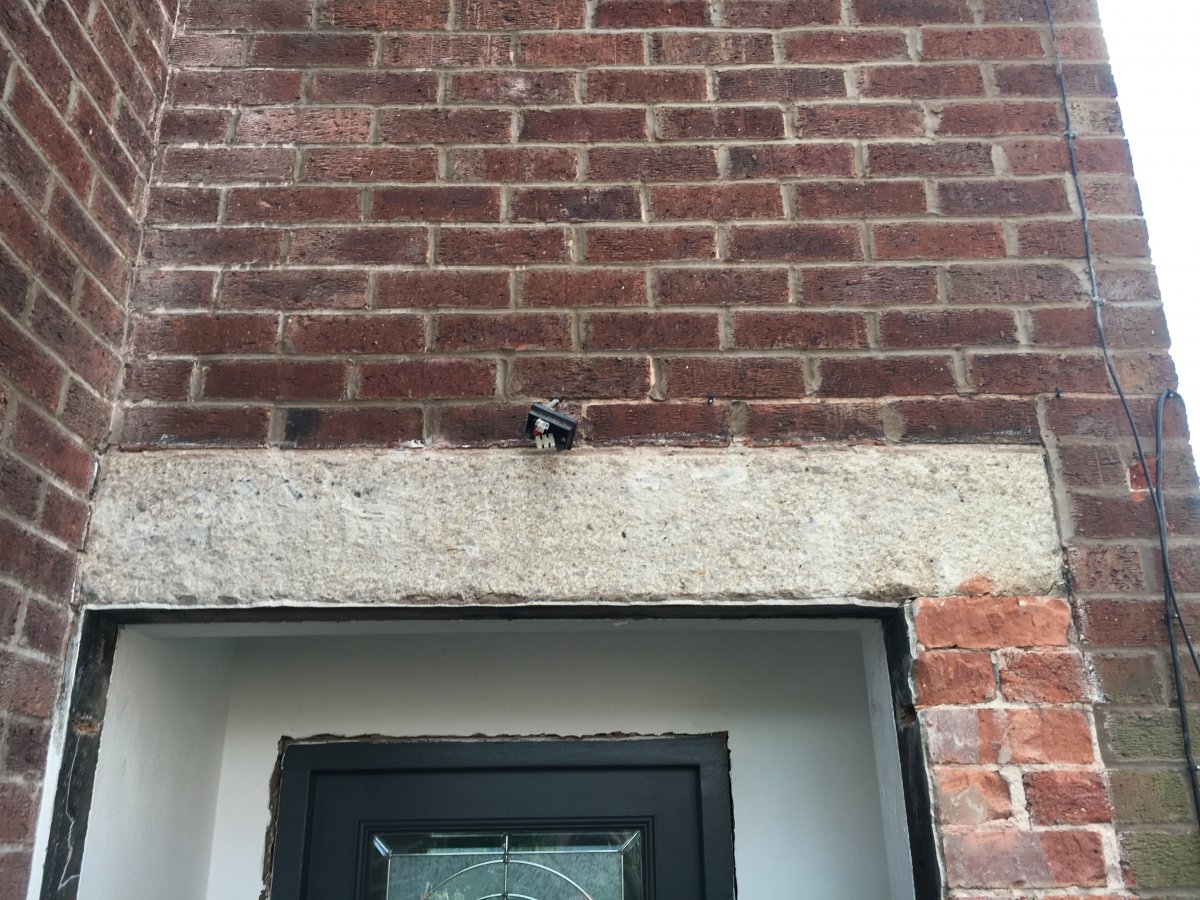

It's right above the lintel which is where i need the wall plate for the canopy to sit. I've drilled a couple of inspection holes in the plasterboard behind the lintel (if you come out the door and look straight up) but no joy. It sounds like the cable is free to move but it's the other side of the floorboards between the bathroom tiles and the chipboard.
Perhaps, knock out the brick above the lintel, terminate the conductors in an MF box and put the brick back.
Success! (sort of). I bit the bullet and kept drilling upwards into the void and have found the wire. I still don't know what its connected to but its a start. I'm going to make the best of the situation and wire in a new ceiling light for the porch.

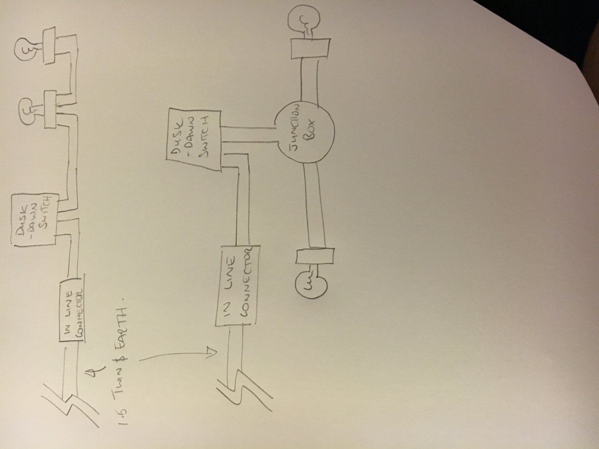

So now do I take the existing end of the wire and put it into a junction box (that will be in the roof void) and then take a cable into the dusk sensor, then back into the light (2 lights actually)
Can anyone advise on how I can wire two lights up to the current twin and earth.
Im assuming the current live wire comes off a loop in lighting circuit at some point. Is the lower diagram suitable? This is what I'd prefer otherwise I'll be coming back on myself with cables
Is the area inside the porch above the lintel accessible?
If so, I might be tempted to fit a DP isolator (check the cable is on a 5/6A circuit), which could be weatherproof if needed. This would be fitted below the ceiling in the porch.
I would use the back box as a junction box, so in effect you have a means of isolation and jointing all in one and it is accessible to boot.
All the cables from the sensor and light fittings would run back to the switch box. This leaves only one cable to connect at each item.
Where are you planning to fit the two luminaires and the sensor?
