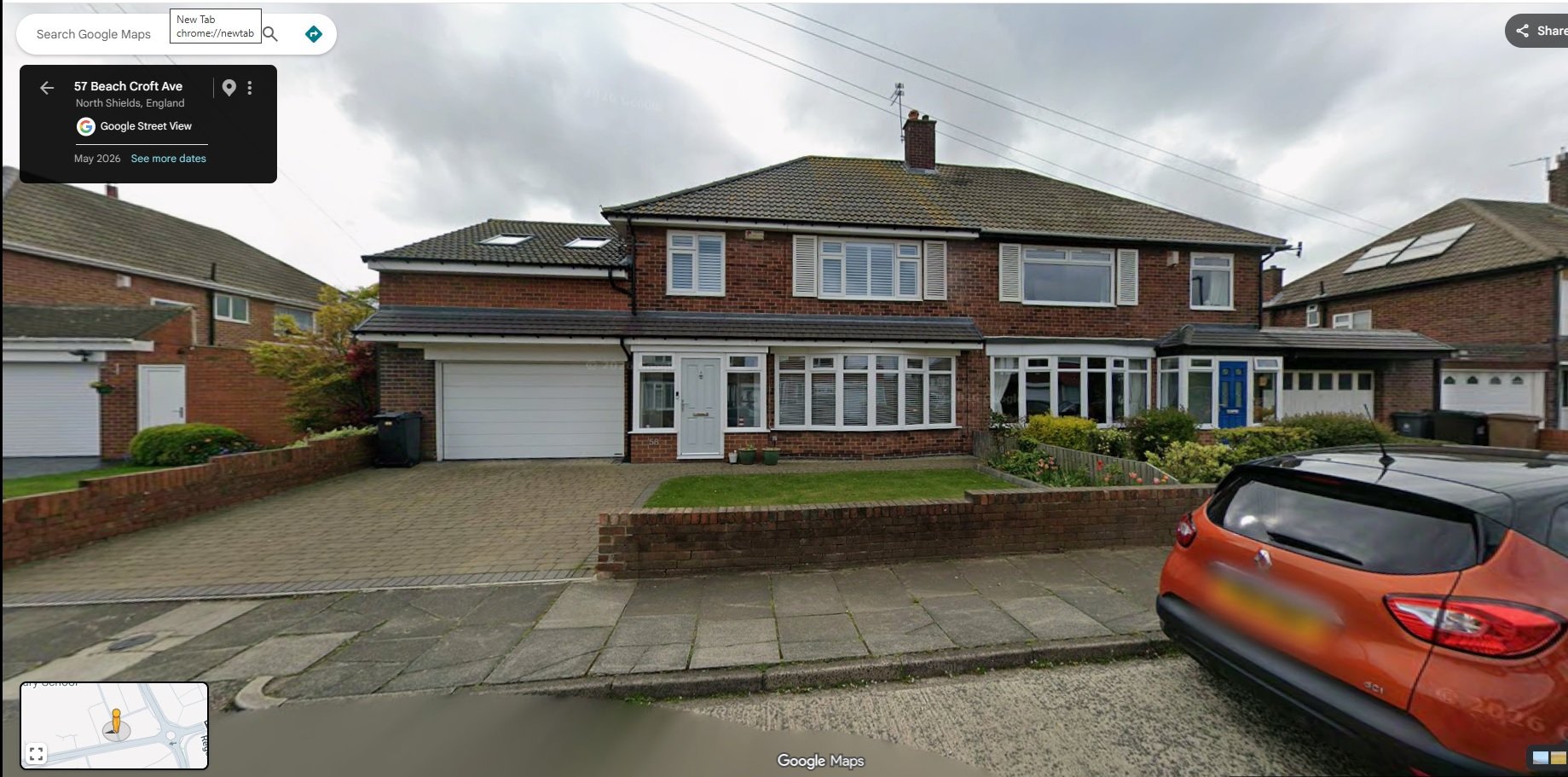

unfortunately, the extension over the original garage does touch into the existing main roof - therefore i am summising that the planners WILL take that roof space into consideration for the allowable 50m³ making it fall outside Class B for the large rear facing dormer and hip-to-gable.
I have bene looking into the new NPPF and their emphasis on increased development densities and efficient use of residential curtilage within settlements and the utilisation of 'airspace' above properties to gain more floor area....

That is still debateable. It is clearly a one and a half storey side extension (they did well to get that under permitted development). You would have to be incredibly pedantic to argue that it is an addition to the existing roof. I certainly do not think they should take the volume of the entire extension roof against any future roof enlargements, at best just the section where it joins the existing roof. For instance a hip to gable conversion of the existing roof would absorb that part of the extension roof so the volume increase would be cancelled out.

Yoiu're within 2m of the boundary so it won't be PD to put a second storey.
You're looking like > half the original width so it won't be PD.
