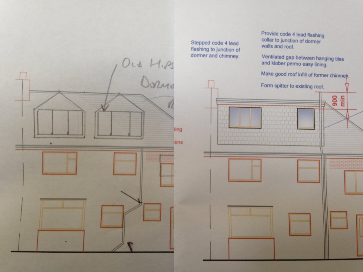

I've paid £86 for an LDC for a PD dormer and have to wait 42 days for it, that makes it a year I've had to wait for a loft concersion. I blame the archatectural technician for being a **** and giving me bad advice and also Freddymercurystwin for telling me to do it properly ;)
If I could go back in time, I'd convert the loft without permission or drawings.

If you got an LDC for a dormer, would have have to build it as per the drawing or could you change it?
But like this:
Sorry to hijack your thread, it's interesting conversation.
Assuming that's a rear elevation? Your LDC is irrelevant with respect to what you can and cannot do, so you can deviate from the proposals on your LDC any way you like provided its PD, which is woodys point. But when on occasion a solicitor pipes up during a sale and throws a spanner in the works, sometimes no amount of bleating on that it didn't need PP at the time will be effective and an indemnity or worst case retrospective LDC will be required. For clarity I do not ever encourage clients to apply for LDC's though do feel obliged to highlight this potential scenario if it comes up, think I've maybe applied for one maybe two LDC's for PD works over the years.
You have to still comply with the PD rules. So, it would need to be <40m3. And, being pedantic, it appears there is (marginal) increase to the original ridge height, which would not be PD.
