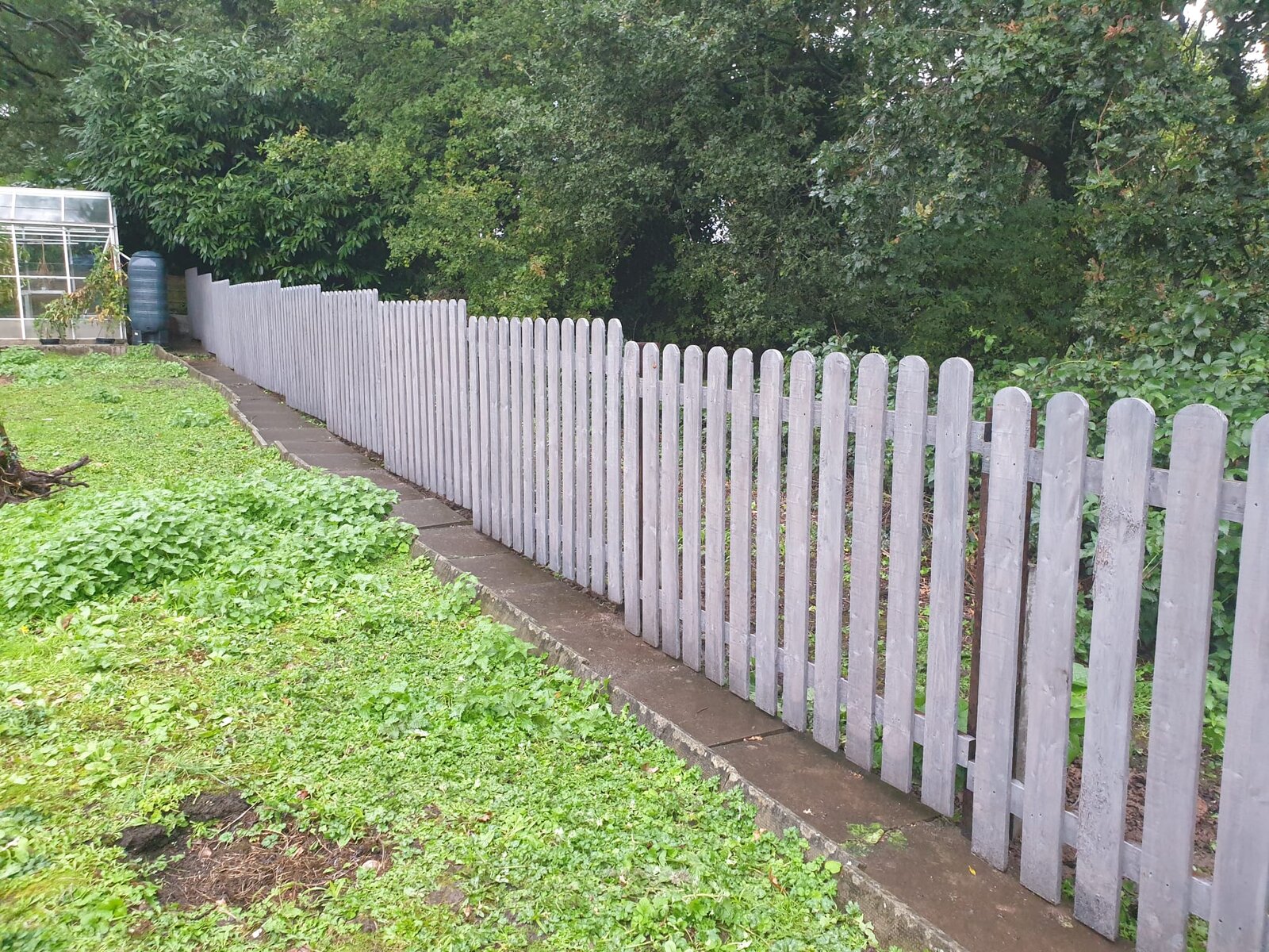

Picket fence problem
8 Nov 2004
408
8
IMG-20210928-WA0004.jpgcan someone give me their opinion on this please
Those are pre-made panels - the company should have fix rails to the posts then pickets to the rails to follow the terain.
Thanks for the answer that's exactly what I said, I suppose these would be OK if the garden was level but they just don't work in this case, apparently a bone fide company with good reviews, I don't understand why they'd do it like that.
