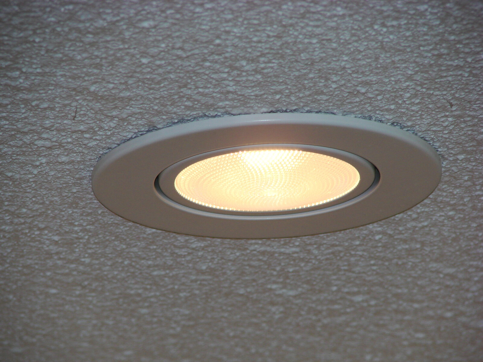

you could put a bunch of small spot lights around the ceiling in approximate positions, then direct them later. the type that you can spin and angle where you need them to be. they wouldn't need to be where the pictures are but could still illuminate them nicely from the side.
or just suck it up and decide now. indecisiveness is a terrible condition :)
Something like that
It wouldn’t be that difficult to approximate locations and wire accordingly
you can even get subtle GU10 type ones. i have used these at a cafe counter before to highlight menus etc. they are very subtle, though once you look at them they might look a bit "commercial" for a living room.
they are not as directional as spot light type fittings though, but they are more subtle.
