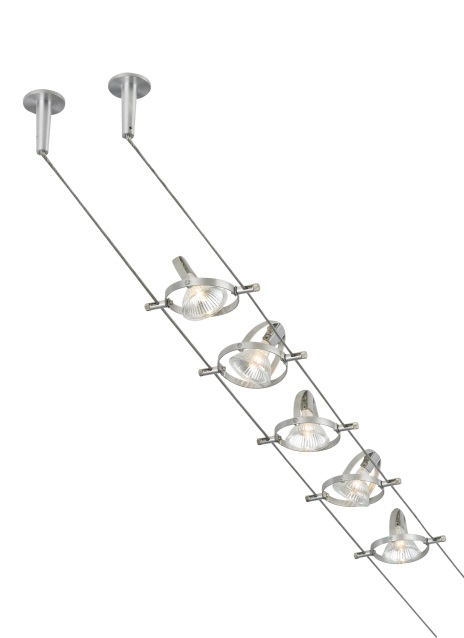

If you are considering tension wire system such as
or similar then be sure to get the correct transformer(s) to supply the track.
If you use any type of "electronic transformer" ( which is a Switch Mode Power Supply ) then ensure it does not allow any radio frequency energy to reach the tension wires as these will act as an aerial and broadcast Radio Frequency Interference ( RFI ) to the surrounding area. The RFI measured at the output of the SMPS could be low enough to be compliant but the tension wire "aerial" could then amplify the effect of that compliant RFI to create a much larger Effective Radiated Power ( ERP )
An inductive ( magnetic ) transformer should be used with tension wire systems as an inductive transformer does not produce any RFI.
A tension wire system supplied by an SMPS was affecting marine radio communications over two miles from the building. The original transformers had been replaced with SMPS units.
Thanks for this.
I had looked at this type of system, but because of our ceiling slopes, we can get it to work.
What I am looking for is a rigid track system where I can suspend the track from varying length cables (say at the corners) from the ceiling.
If you have kitchen wall cabinets, consider led strip lighting, above and below.
Dont know about track lighting, the usual type need fixing to a ceiling to make them rigid
