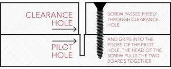

I hope you are certain you know where the pipes/cables/etc are! For the boards to pull tight against the joists, you also need to drill a clearance hole(slightly larger than the screw diameter)...
images
...but, the drill will bite and suddenly pull down and ruin your pilot hole, so, a small piece of wood(wine cork?) over the drill bit as a depth stop is a very good idea...

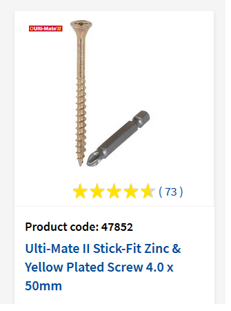

If they are too small how about these which are 5x50mm and then use a 4mm pilot? Have them left over from a different project. Save another trip to the shops for something in between.

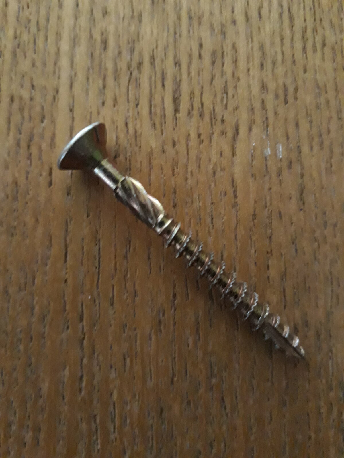

With regards knowing whats under the boards. I was going to lift the problematic boards out fully and have a gander underneath. No chance am I risking screwing into existing nail holes. I trust thats the right approach? Or is there anything else to consider?

My suggestion would be to use proper flooring screws.

Is everybody else of the opinion 3.5mm spax screws are too thin? Is so will pick up a bag of these too.
