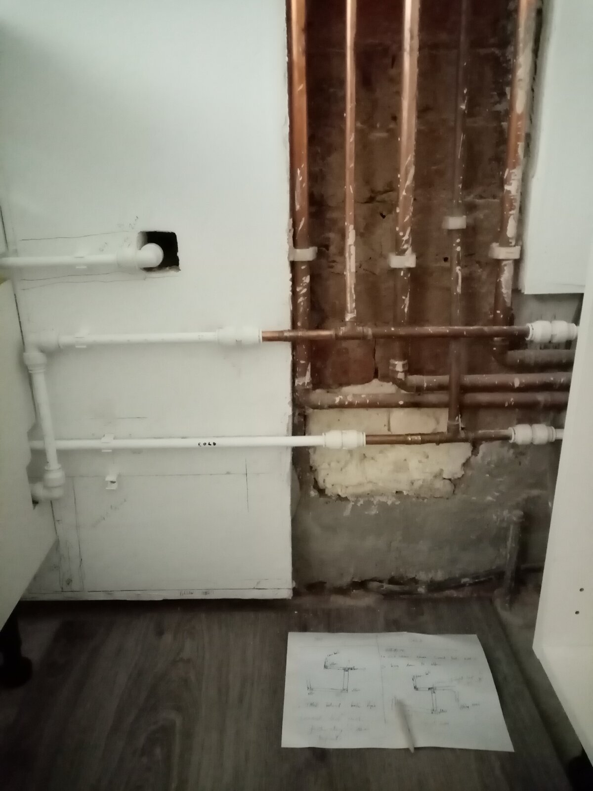

I went to install my integrated W/M to find that it couldn't go back far enough due to pipes in the way!! schoolboy error
The only way to get this to work is if i run the pipework for hot and cold feed along the floor (thus in the small void at back of washing machine) with clips on the laminate floor. Would this be appropriate to do/qny issue in doing so? It's only for a 70cm length
cheers
You'll be fine if you run them as low as possible on the wall.
Usually washing machines have a gap of 5 inches at the bottom to allow for pipes.
Good luck with washing machine on laminate- tends to make them very noisy and dance around :)
