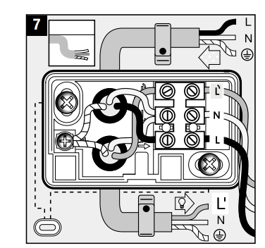

Is that PIR wired with L, N, switched live, and E - or just L, switched live, and E?
The PIR has N as well.
my feed is just a simple 1.5mm^2 (yes the unnecessary 1.5 not 1mm) t/e from a ceiling rose. Meaning the N from source feed goes into the choc block and I would've wired the N from the Lamp straight into the same. Pretty much as per guidance from the manual.
