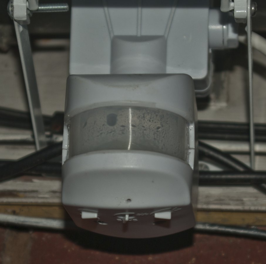

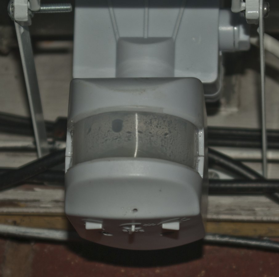

I had the same problem with water that small hole drilled in the PIR has cured the problem. I think the problem is two fold, one is any water that does get in has no where to get out again, and two the lamp warming up and cooling down again expands and contracts the air inside so it sucks in any water. One small hole and both problems are solved. Clearly I had to dismantle the light first to ensure my drill did not damage any thing. And at time of picture still not fully dried out. Design of the lamp means water getting in any where will end up in the PIR. And since my light has a 5W LED to replace the 120W tube there is enough heat to draw in water but not enough to drive it out again.
View attachment 97808 I had the same problem with water that small hole drilled in the PIR has cured the problem. I think the problem is two fold, one is any water that does get in has no where to get out again, and two the lamp warming up and cooling down again expands and contracts the air inside so it sucks in any water. One small hole and both problems are solved. Clearly I had to dismantle the light first to ensure my drill did not damage any thing. And at time of picture still not fully dried out. Design of the lamp means water getting in any where will end up in the PIR. And since my light has a 5W LED to replace the 120W tube there is enough heat to draw in water but not enough to drive it out again.
Mount it the other way up?
That would put the adjustments for time, sensitivity and light levels on the top. I would not expect them to be good enough to ensure no water ingress and also one could not adjust them. Had I read the instructions before fitting it did say:-
"Not suitable for use in extreme conditions. While the floodlight offers basic protection against mechanical aggression and splashed water it should not be exposed to extreme weather conditions such as hail showers."
