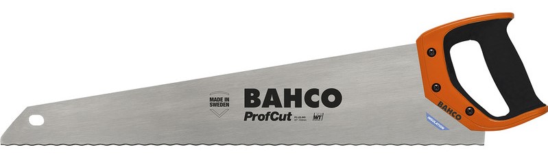

Like @Charlie George I generally just use a Bahco insulation saw
guided by a piece of CLS. They create a lot less mess than using a hand saw with teeth but can be a bit awkward to keep sawing plumb. Doing a lot of insulation with them can be hot work (which is why we have apprentices :evil: ). They certainly cut straighter and cleaner than a bread knife.

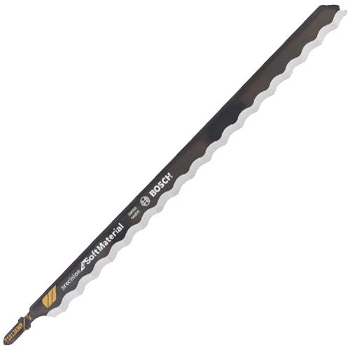

I've also tried long jigsaw blades, like the Bosch T1013AWP:
which do work, but I found the squareness of cut depends pretty much on the quality of the jigsaw. With a Bosch jigsaw which has the extra/double blade guides (e.g. GSR135BCE, GST140BCE and GST160BCE) or the ultra rigid Maffell (P1cc) they cut fairly true, but can wander off - that's from trying them with my 15-year old old GST135BCE, a mate's GST160BCE and my current P1cc. With other jigsaws that lack the second guide (e.g my Makita DJV181) they seem a bit more hit and miss and tend to wander off from plumb a bit. They are good for mineral wool batting as well, but they do need to be run along a straight piece of plywood both to guide the cut and to prevent the base of the saw digging in or tilting. Festool make a similar blade, the S 155/EW/3

Those specialist jigsaw blades can wander in the thicker boards, but are quite quick and low dust

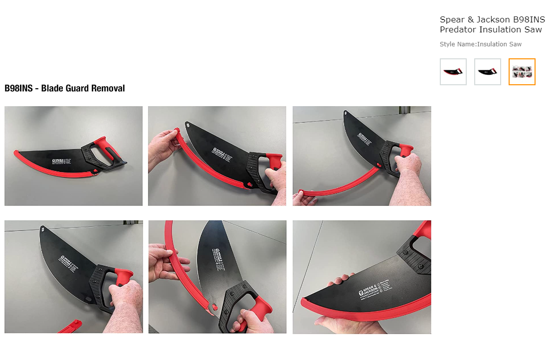

And say halo to my leetle friends. These have come a bit late to the party, but will be given a go shortly
Both should cut board and quilt, and I chose the knife as its polished stainless steel so (in theory) should have low resistance in board
If you get the Bahco saw, or any similar saw for mineral wool, get the Bahco sharpener (or a cheaper basic knife sharpener which is exactly the same thing) and give the blade a quick resharpen often.
I used the bacho insulation saw and made a table up with timber guide top and bottom to stop wandering and get square cuts. This was with 100mm PIR, so really on the limit of the saw.
