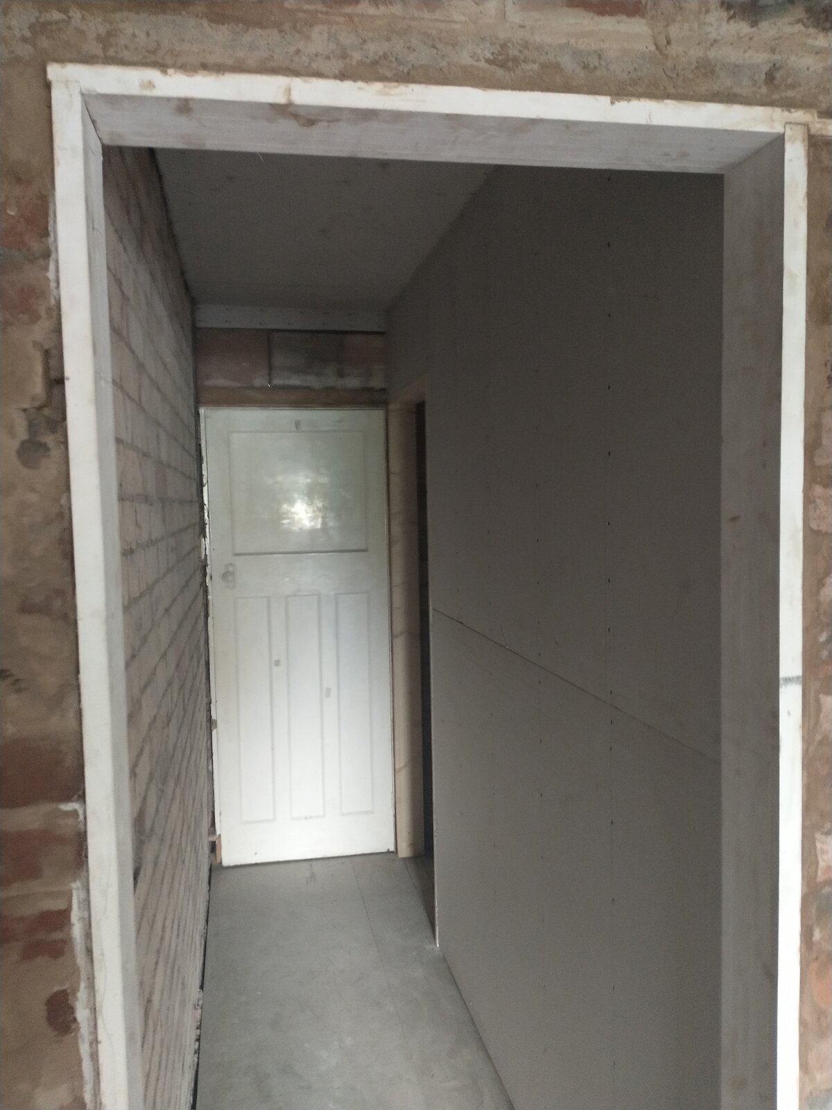

Can anyone recommend one that will only work facing in one direction? In the photo below, I'm stood in a new bedroom extension, the door at the other end of the corridor on the right is a bathroom and the end door and frame and brickwork above up to the small section of plasterboard (lintel) will be removed.
Beyond where the white door currently is there's a busy landing, I need a switch (presumably mounted on that small strip of vertical plasterboard or the ceiling nearby) that will only activate when someone is in the corridor, not walking past outside. Does anyone know whether one of the switch plate types would be suitable or would it be too high up?

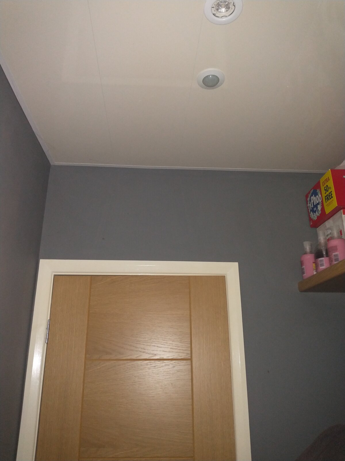

I have a 360° ceiling PIR switch in a similar situation downstairs (utility room), where it is very sensitive and sometimes operates when people walk past if that end door is open (with hindsight this one would have been better in the wall above the door).

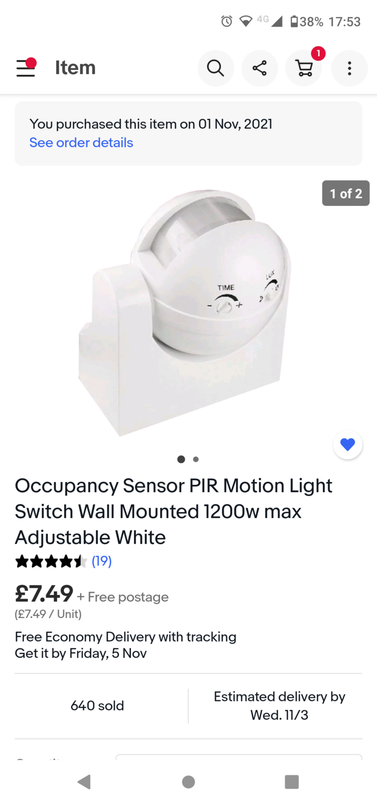

The external ones fixed to floodlights seem a better bet as the angle of coverage and sensitivity can be altered.

I use white Electric tape on PIR dome to mask areas tha I do not want it to cover - eg towards your corridor and reduce swithcing from that direction.
And on some of my Dome PIRs, I can also reduce their sensitivity - depends on which ones you by.
Thanks, think I'll try that with the existing one. I've ordered one of these for upstairs to play about with:
